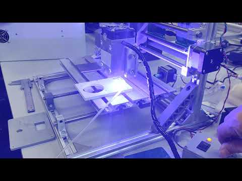

I’m actually not seeing a lot about blue LED lasers and PLA. Here’s someone who has set up air assist on a laser he describes as 10W:
