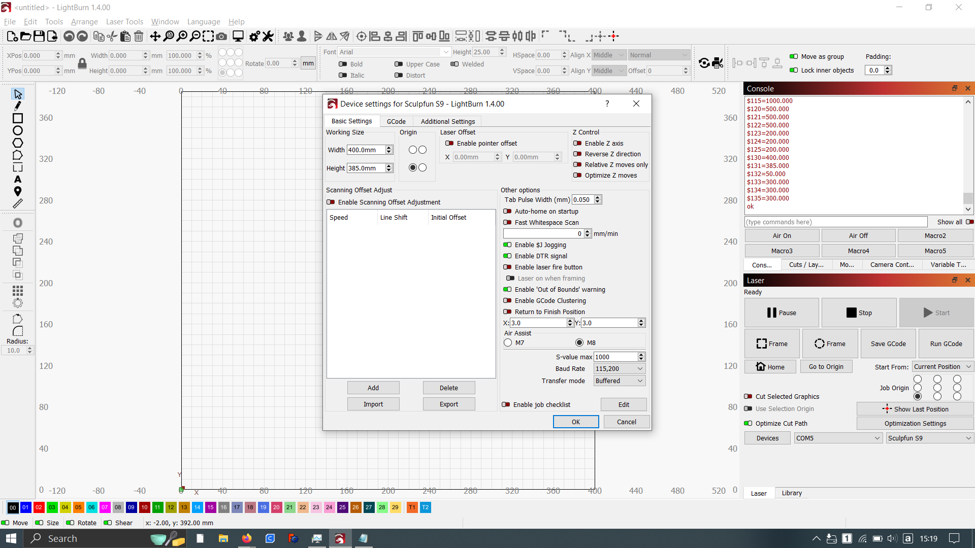

New to lasers but experienced 3d printer enthusiast. I’ve fitted a DLC32 with limit switches to my new S9.
The issue is that it will home to the front left but will crash into either stop switch it reaches first and continues to run the motor for a few seconds, eventually throwing up ‘ALARM:1 Hard limit triggered.’
Wiring to the switches has been treble checked and is OK for continuity and are OK for matching the wiring diagram. (The x axis also runs in reverse on the screen to lightburn although y is OK).
Enclosed are a couple of screenshots below of the current configuration and a listing via the command line. I’ve tried whatever I can to resolve this to no avail, so any advice is gratefully received.

If X is inverted is it looking at the wrong limit switch? Have you tried fixing$Homing/DirInvert yet? And maybe start with homing one axis at a time ­— make $Homing/Cycle0=X and $Homing/Cycle1=Y or vice versa?
Do the status messages (<...>) show when you manually trigger the limit switches?
Michael,
Thanks for the reply. $Homing/Cycle0=Y homed the y axis to the switch and it successfully ‘bounced’ and retracted the specified 3mm.
The x axis still ran into the frame but it prompted me to yet again check the connections and it turned out to be a faulty pin in one of the connectors- it wasn’t fully home and sporadically produced the weird results despite multiple meter checks! At least the thing homes successfully now…

Michael, thanks for the pointer; I figured out the air assist- used this diagram- Hardware Wiring · makerbase-mks/MKS-DLC32 Wiki · GitHub
The other issue was that lightburn was using M8 instead of M7- I now get a change of voltage to 3.3v as anticipated across the pins. Unfortunately the boost convertor I purchased of a famous online retailer is busted with no uprated output to 12v so the air assist is on hold until replaced… sooo close but oh so far.
