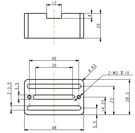

I ordered a Sculpfun S9 module to use with my Shapeoko 3, going to take 3-4 weeks to get it. Plan is to design and 3D print a mount that attaches to the Dewalt spindle holder, similar to the J-Tech mount.
I’m looking for the following:
  • slot dimensions to be able to use 4 screws in the S9 mounting plate
  • size of the screws/nuts that will be included, M3?
  • width and depth of the slot in the back
I assume that they will all be in metric.

Does anyone have these dimensions? I emailed Sculpfun, but have not received anything back yet.
@genepaton are you able to help with these measurements?
Received this from Sculpfun:
S9_Mount
The included screws are M3x30.
