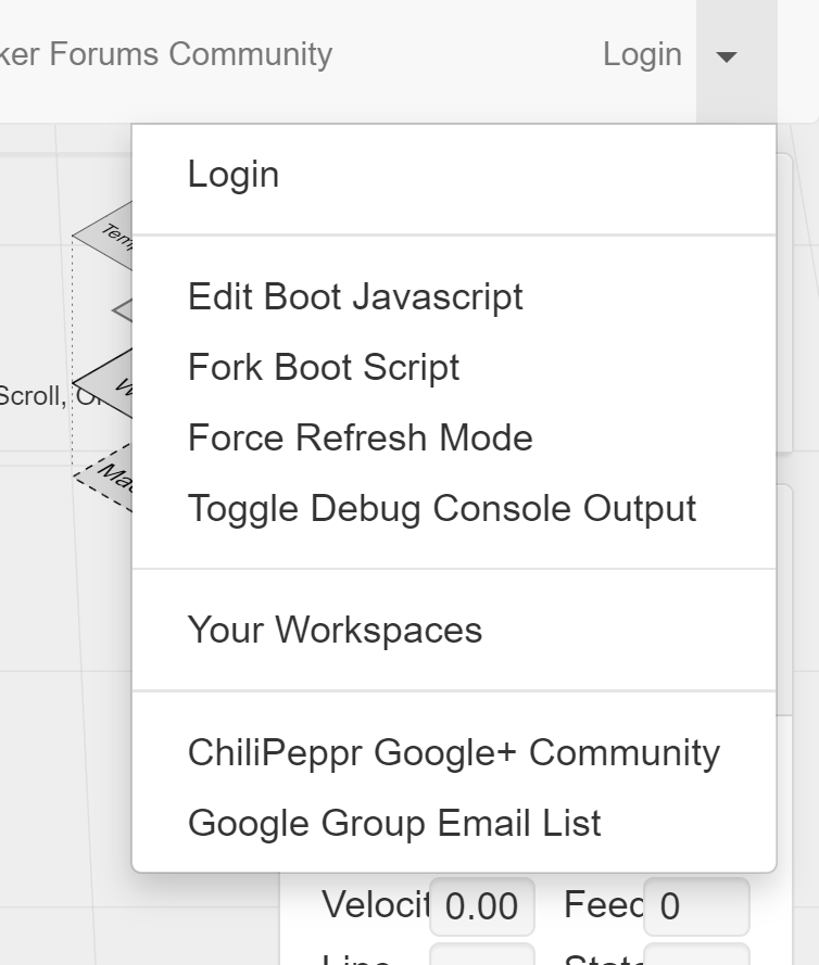

There is a lot of debug info spit out into the Javascript console, but you do have to turn on the debug output. So hit ctrl+shift+j to show the Javascript console in your browser. Then go to this menu to turn on debug.
There is no way to change default settings in the Eagle BRD widget. I too would like that feature.

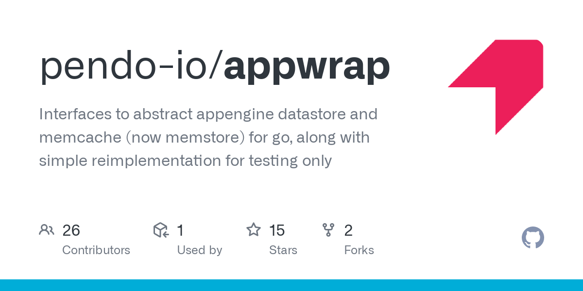

At work, we open sourced our wrapper around the appengine APIs and then had to port everything over to new APIs. So a lot of what someone would need to do to move from the old APIs to the new APIs is basically encoded in commits here from about September 2019 to January 2020.
