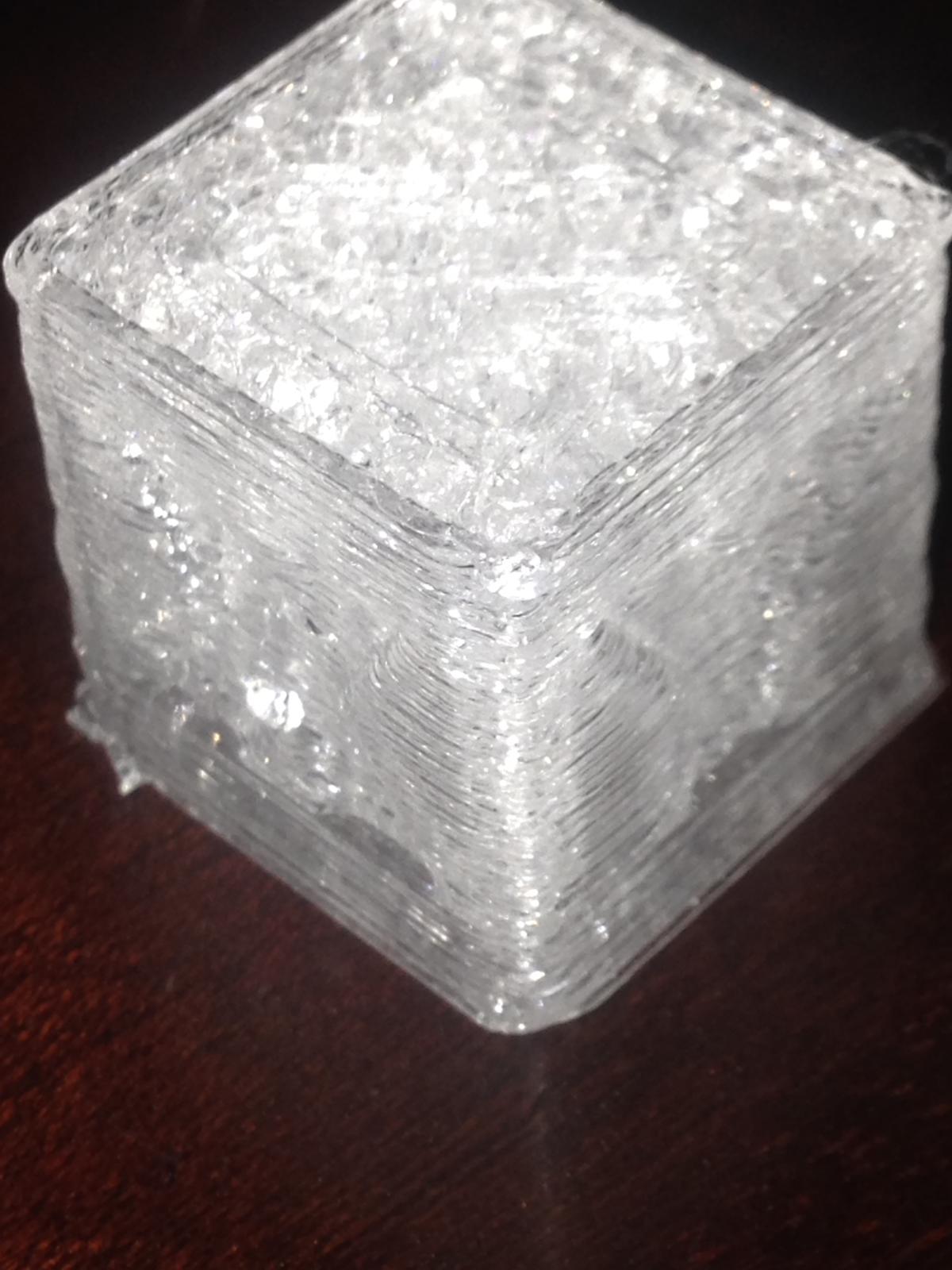

I’m testing pellet extruder:
https://www.recycl3dprint.com/support/documentation#reamaze#0#/kb/getting-started/installing-the-lily-pellet-extruder
Author writes linear advance much improves quality.
Is there anything in Smoothie that you would reccommend for pellet extruders?
Best I could get so far 20mm cube: 1mm, nozzle, polystyrene, 215deg, 40mm/sec.
Linear advance is a parameter you can enable/tune in Slic3r
You are right and the only one I know. It’s missing in Prusa slicer unfortunately (I like it very much).
