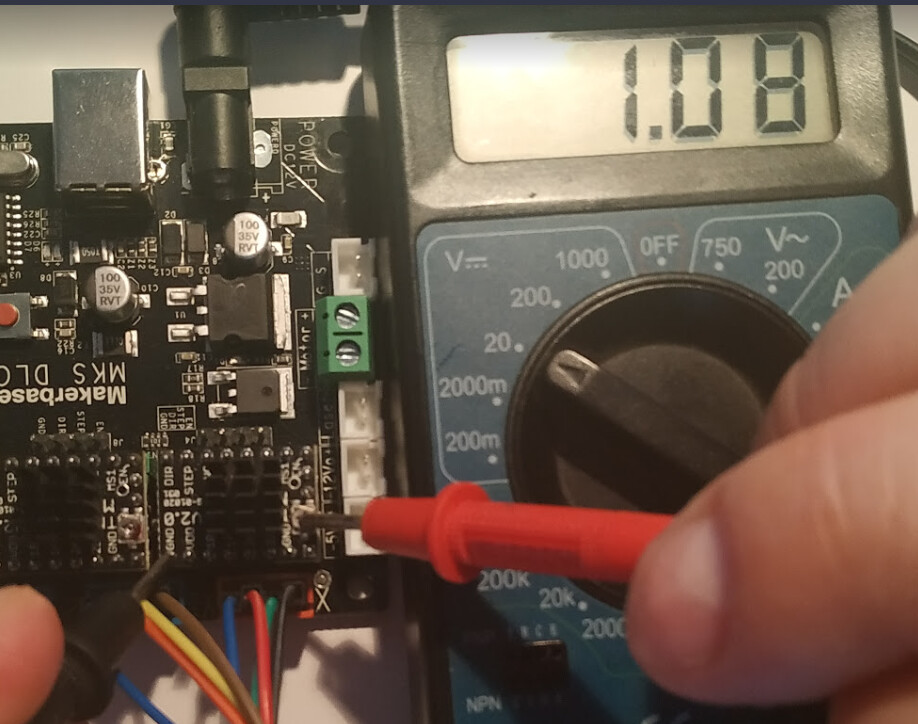

I try to set Vref using stepper driver screw but value oscillates around 0.10 - 0.14 V.
I search websites and it should be near 1.5V reduced to 70% for safety (= 1.05V) but its hard to get even near that value.
I measured it with only power on (without connected USB and engines) between pin EN and GND or stepper screw and GND - values was the same.

Can you show pictures and point to what you were adjusting and measuring on it? I think there’s a misunderstanding here but I’m not quite sure what it is, and a picture might help resolve it.

Today I noticed that one wire from electric meter was almost broken I solder it and now it looks like it works - I mean Vref.
I set it to 1.08V (image). Between GND and EN - 5,07V

Well, that explains the problem with measuring the voltage! But it means I don’t see an easy answer.
I think that the “70% for safety” is probably related to confusion over RMS vs. peak current. If should be safe to run the steppers up to their rated current, but they should at least function at 1A.

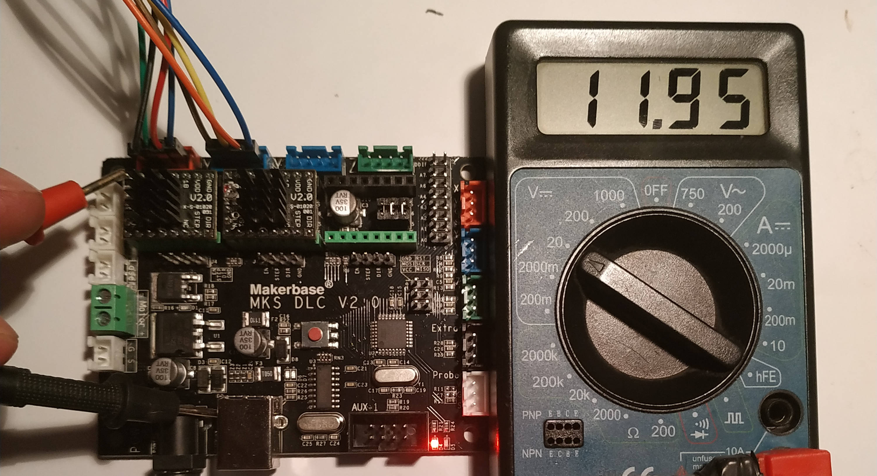

Just making sure, you have the 12V connected when testing and it’s not trying to drive off the 5V USB, right? Vmot to GND is 12V at the stepstick?
1st - yes - only power supply is connected
2nd - between both stepsticks are ~11.95V
