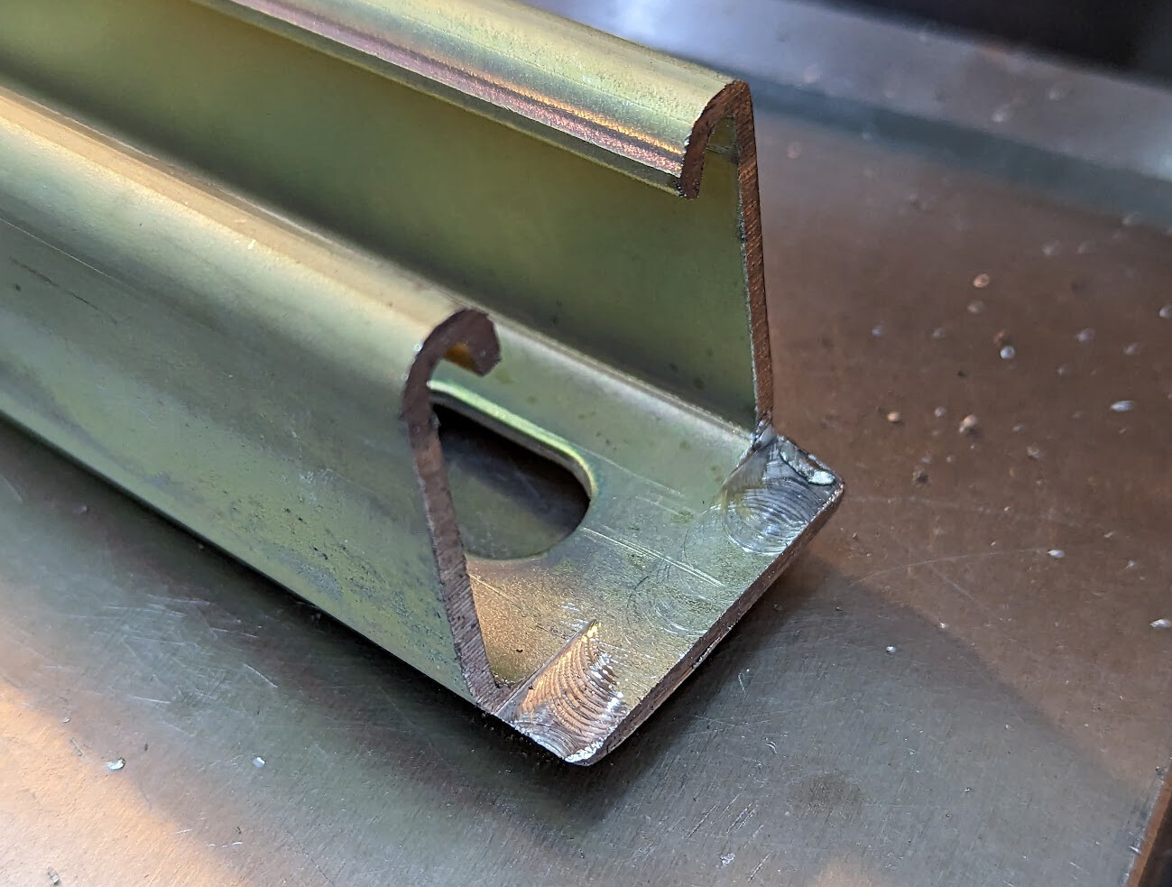

After measuring the shelves, I cut sections 1’ 11 13/16" long, and then cut 3/8" off each end except for the top. I rough-cut with a saw and finished on the mill just because I have one, but if I didn’t, sawing and filing would have just taken a little longer. Here’s what one end looks like, partway through filing:
Even with a mill, I discovered that I really wanted to rough-cut with a saw; I stalled my mill hogging it out on the first attempt. After that, I used the horizontal band saw for the longer cuts, and a hacksaw to cut the tabs off:
I used a corncob mill for finishing. After rough-cutting with a saw, it was pretty quick work; the mill was short enough that I had to do two passes, but after the experiments on the first two braces I made, the last three took only about two minutes per end to cut, and maybe one more to file smooth.
Sadly, I forgot that I had to synchronize my cuts with the holes in the base of the strut at one point, so I have one piece that looks like this:
That one is installed under a lightly-loaded shelf.
