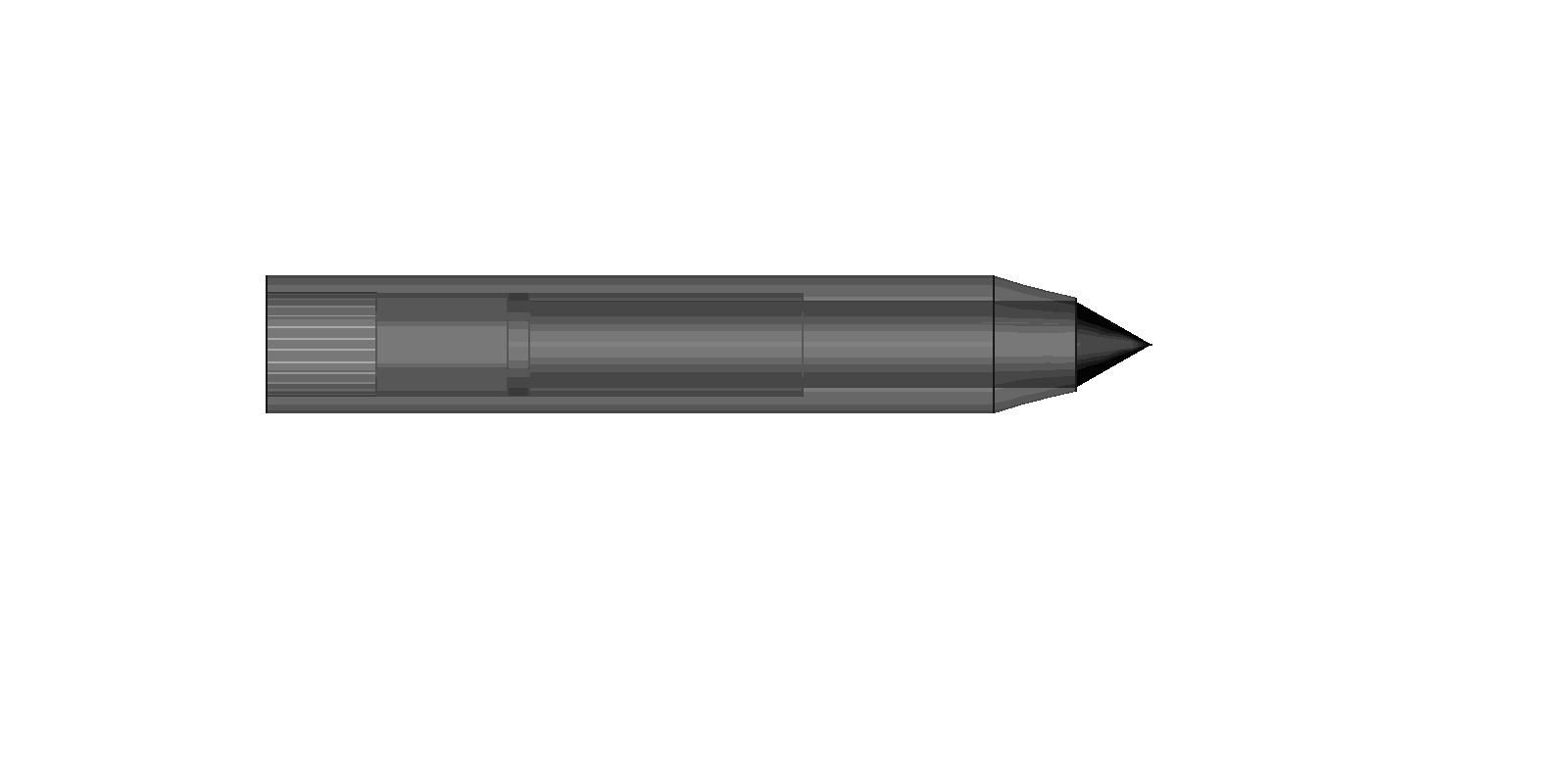

I used FreeCAD and the Assembly4 workbench to try out my idea.
TapFollower
At first I had thought I would just put a set screw in the back to hold the screw in place, but I finally realized that there wasn’t a particularly obvious thread that I could cut into a ⅜" hole without single-pointing both sides, and I didn’t feel like it. I also realized that the narrow 5.55mm spring would buckle in a ⅜" tube, so I decided to make a 4mm shaft for it to run on and drill a 4.5mm hole in the back of the follower pin for the shaft to run into. I realized that if I just knurled and pressed ⅜" into the ⅜" reamed hole, I’d have a tight fit and a relatively permanent tool.

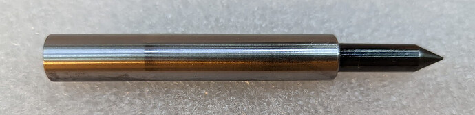

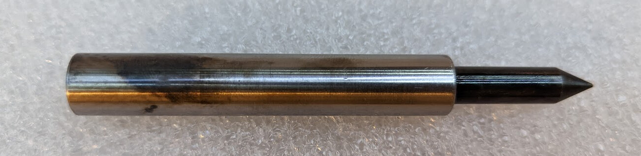

Decided to blue the pin and the shaft to protect against corrosion and hold oil, and also to blue the inside of the body for the same reason. Sadly, I didn’t clean my fingers as well as I thought I had when I picked up the body, so one side of the body is a bit uglier than the other:
I put the pin in, put the spring on the shaft, pressed the plug into the back, then faced it off to try to blend the back end together. I could have knurled it deeper and/or used loctite, because when I faced off the back to try to blend it together, the plug moved slightly, breaking the illusion. Oh well. I should really have reduced the follower head diameter a thou or so and reamed the body undersize for a solid press fit for the plug.

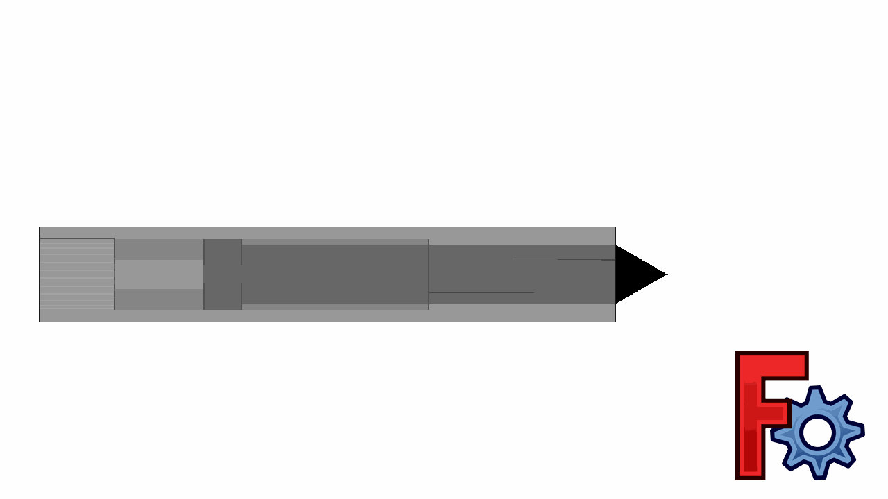

Animation with these changes:
TapFollower
A little Mother’s polish cleaned the blueing smudge off the body, and it looks great. No trace of discoloration after a few seconds of polishing:

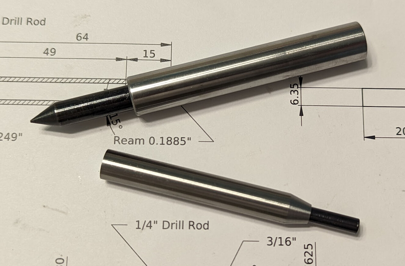

Of course, now I realize that most of the taps I use have points not holes, so I really need to make the pair to this one with a smaller shaft and a hollow point for those small taps. Probably 90% of my tapping is M5, and half of what remains is M3 or (rarely) M4. I just got some smaller drill rod in…
TapFollowerSmall
TapFollowerSmall.pdf (14.2 KB)
I had two challenges making the smaller tap follower.
  • I had trouble hitting the diameter when turning the follower pin down to 3/16" — I ended up scrapping the part by going a few thou over a few times. I ended up making it a touch oversize and using file and emery paper to bring it down to a nice polished slip fit
  • The ¼" 1144 rod I bought was 15 tenths undersize, and I didn’t realize it until late in the process. This made the plug in the back a slip fit instead of a press fit. So I just used superglue because I didn’t have the right loctite. (I should just get some ¼" O1, W1, or A1; those seem to come ground much closer to dimension.)
This time I didn’t get any of the Oxpho Blue near the follower body, just the tip. The black surface of the plug is the untouched surface from the ¼" 1144 as shipped.
It’s smoother and tighter than the larger tap. I’m very pleased with the action. Now I need to make something that needs to be tapped again! :smiling_face:
I used a #1 center drill for the tip of the follower, and it seems to work fine.
Here are the parts laid out ready to assemble:
Close-up of the business end of the assembled tap (complete with tiny chips I didn’t notice and remove until after I had taken the picture):
