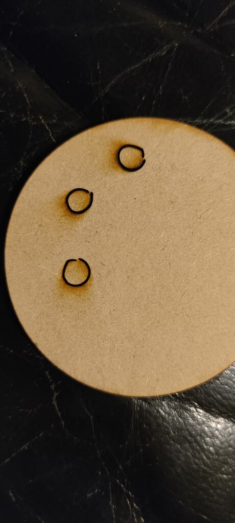

I find that my laser is strong enough to cut with one stroke in the top left…but needs a lot more in the bottom right. (assumably due to the laser having to travel further.)

This typically means an alignment problem. If you haven’t found our alignment resources yet, from K40 initial setup and regular maintenance: Alignment
The path that the laser takes along three mirrors and the lens needs to be precisely aligned. Here are three resources that may help you understand how to do this.

I would check on the physical side first; whether you are on m2nano or c3d being able to adjust power consistently as the tube ages and getting alignment right is the foundation.
One of your questions is based on a mistaken understanding; increasing power by distance isn’t something you want; you want to fix alignment instead. For more details I’ll defer to other forum members, but figured this might help get you started.

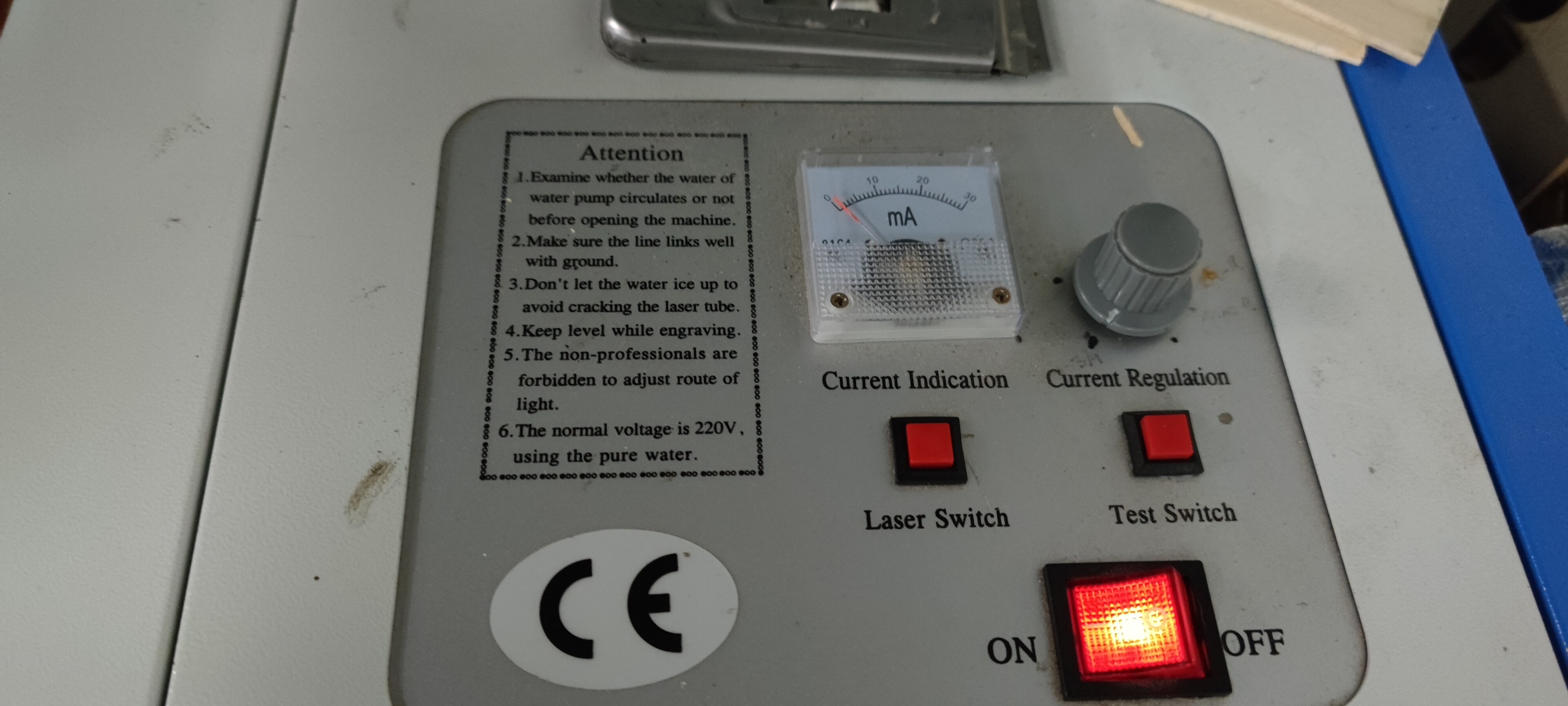

So my machine seems to have a analog ammeter on it. So to find the same setting I have used before I need to turn the knob and use the test switch? Wouldn’t that burn whatever I have in the machine? Is there anything I can put in for this that is safe? Able to not burn but also not reflect the laser back into the tube like metal would?
Congratulations on having a machine with an analog ammeter!
You can adjust the current by using the laser with nothing on the bed.
K40 Intro links to K40 initial setup and regular maintenance which shows a schematic of the light path through the lens. The lens focuses the beam, but below the work plane the light just keeps getting wider and wider, spreading the power out.
That’s the max power setting; then the software can set the total power in the range between zero and whatever max power you have set.

It’s good to know I can use the analog ammeter to know the power I’m outputting. But I’m still leaving towards the new board for the grey scale it claims I could do with it.

the knob to control the power is a variable resistor(POT) and when you turn the knob you are changing the wiper along a resistor and effectively changing how 5V is split across the two sides of the wiper. Think of it like 2 resistors where one gets smaller and the other gets larger as you move. So you can put a small compact volt meter on this POT and have a digital readout so you can always set your power to known previous settings without having to look at the amp meter and burn things.
Once you upgrade to a C3D, you will set this POT to the ~18mA setting and pretty much leave it there as it represents your maximum power. From then on, C3D will control your power level in software(LightBurn is great for this). When you tell it to use 100% power it will only go upto 18mA.
I have done this conversion and I still like having the volt meter so I can see how things age. ie as you tube ages you will need to up the voltage to get the same power output.
Isn’t the point here to compare the volts on the pot wiper to current in order to track tube aging?
exactly. I’d originally put the volt meter across the POT back when I only had the POT and analog mA meter to adjust manually for cutting and rastering. Then I upgraded the controller and used LightBurn and it used to volt meter at a fixed voltage setting( 2.4V ) until my POT failed and I’d replaced the 1K POT with a 10K pot and had cutting issues. The feedback from the volt meter helped me see the problem was the 10K pot and the voltage was changing when the laser was enabled and a very slight change put on the circuit.
As my tube weakens and I find it no longer cuts 3mm ply at 15mm/s and 60% power, I will have to boost the voltage on the POT, the max power setting to the laser, which tells me over time my tube is worn out. I expect it won’t be but a few times adjusting the POT before either failure or it just won’t increase power any longer.

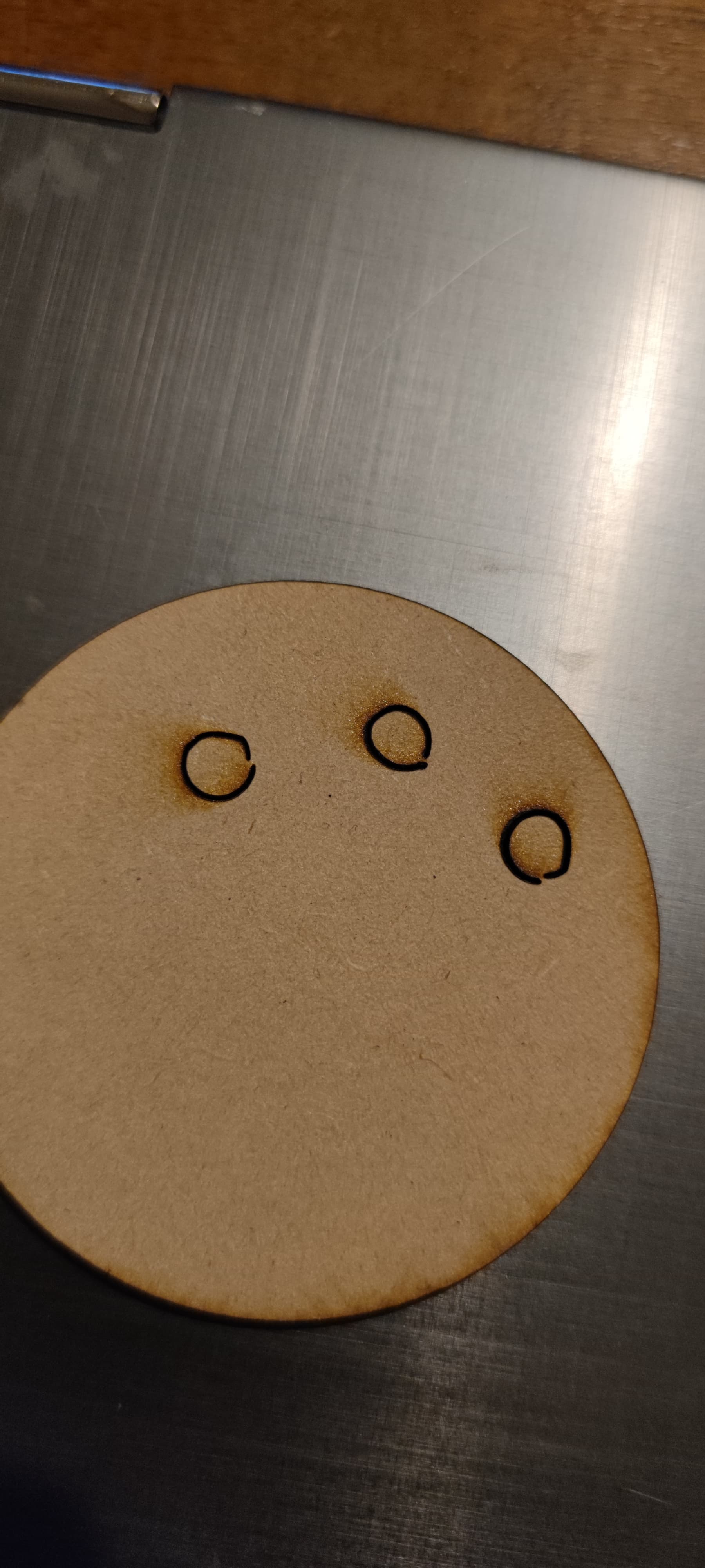

Ok I think I broke something. I’m hoping someone still has this set to watching.
I leveled the laser and it cuts soooo well. But now there is something wrong. I was test cutting circles. They are perfectly circular on my computer. But at the top left of my bed, they print wobbly and incomplete, and at the bottom right they are ovals. Please tell me it’s an easy fix :frowning:
Did this test run properly before your last adjustment?
