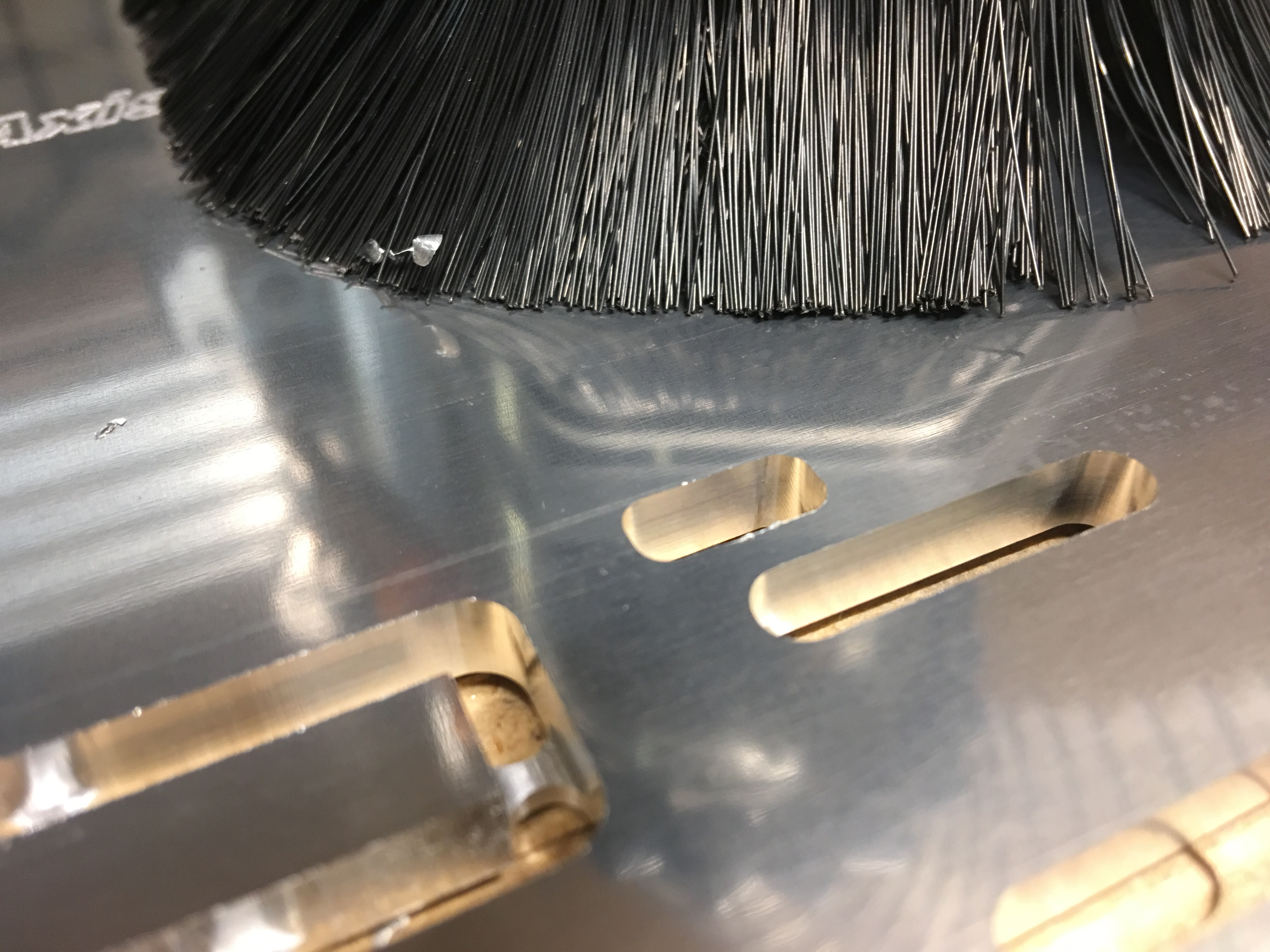

Since I’m not rubbing, the finish is even nicer… love it.
Brandon, are you using the plastic bristle brush to get that finish?
Feed rate, spindle, spindle speed, doc, end mill size/flutes??? I want answers! Is that with an r7? Looks great man.
@Mark_Leino Yes sir! R7. :-). I’ve never been a dust boot kinda guy. My cuts are good but I’ve always recut chips even with the mist block blasting on it. These are kinda remarkable though. And this is on a untrammed machine as well, guess I’ll actually tram the spindle and see if I can get it to a mirror.
4mm single flute carbide, the one we sell.
600mm/m
6mm/m dive
.6 DOC I could get much more aggressive but tool life here is forever, now I’m not recutting, think I’ll hand this end mill down to my kids… haha.
Slot at cutter, second pass at 40%.
@Kevin_McNally no sir, thats the dust boot. Previous cuts “rechopped” the shavings. I don’t like all the noise but seems it may be worth it.
I really need to get a dust boot, and upgrade from a router to a dedicated spindle. That’s a beautiful finish. That’s pretty much exactly what I have found for feeds and speeds, but constantly re cutting chips is not good for finish or tool life
@Brandon_Satterfield When is that dust shoe going to be available?
You are talking about the slots Brandon, not the top surface, yeah? They look truly nice! Please state the mm/tooth, please. I am so curious!
@Colin_Kaminski I’m just about ready brother. Will soft launch them on HF and only let you guys know.
@Alex_Paverman I don’t work in mm/tooth brother sorry. Assumed you are speaking about chip load. Think it can be derived from above info.
@Brandon_Satterfield I am used to think about “cutting” in chip load terms; 600mm/min its clear, “single flute” it’s also clear, for the rest… If I would have known the rpm, I could do myself the math…
A “regular” spindle can do 24000 rpm but I don’t dare to assume you are working with a 4mm mill @ that speed. That is why I botherd you with my question. Sorry.
@Brandon_Satterfield what is your ramping angle? the 6mm/min would make such a ramp take forever I think.
I don’t think he uses a ramp, just straight down.
The single flute bit does not have much strength to plunge. I don’t go quote as slow as Brandon but slow helps when you make a straight plunge. I have been using 60mm/min
I straight plunge at 5mm/min. Keep in mind is only plunging the depth of cut which is only .5 or .6 mm so it doesn’t take that long.
Got it! Of course it wouldn’t take too long due to the small depth.
