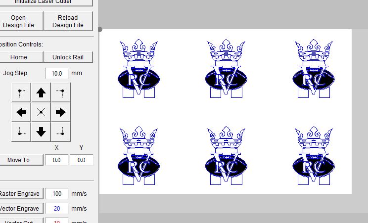

Single image is fine, Multiple of same images appear black in K40

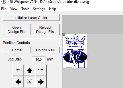

Hi, can anyone help me with the above problem? As I’ve stated , when I load a single image into Whisperer from Inkscape it’s perfect. But If i set out more than one for engraving, they are completely black. Only the images are black. The page is ok.

Thanks jammy, yip, coming right up. The middle one out of the 6 where you can see the heavier blue lines is where I went back and tried editing 1 image in many fifferent ways to see if there would be any difference.( i.e. ungrouping, grouping some of the elements and not others, etc.) but to no avail. It is the exact same image as the first one, that I set out in a grid of 6Capture1
to engrave coasters for my mates rugby club. The odd thing is that might offer you some clue is that the lace on the rugby ball still appears on the right hand side. I really can’t remember if I constructed that part differently to the rest.

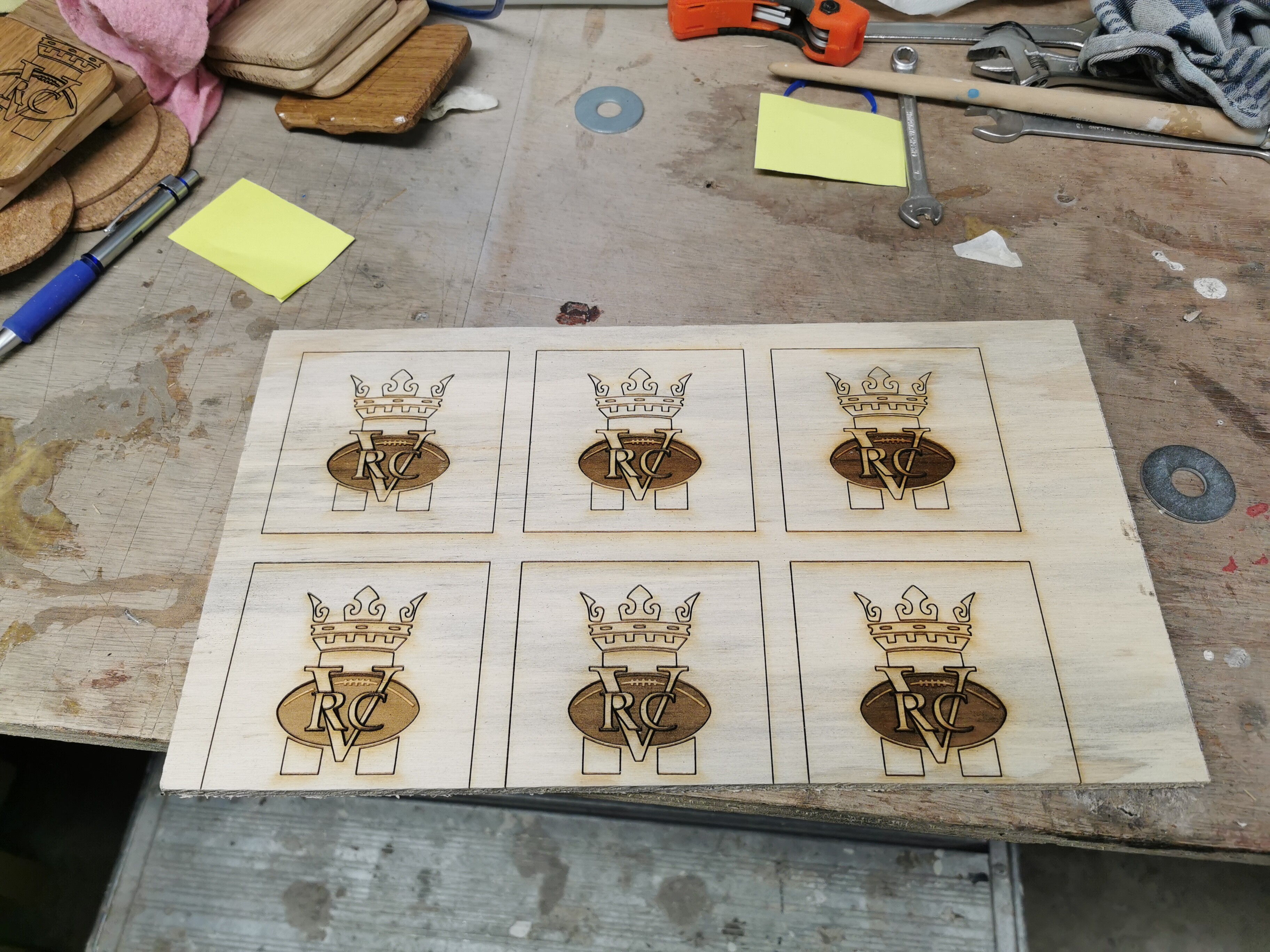

Here you go. I’ve fixed the image for you.
I’m not sure why your first one worked if the uploaded file was based from it - your vectors where filled like this :
Fill 1
You should have no fill on vectors at all (unless you fill them with a solid colour - like the ball).
If you copy one of those images from your uploaded file, and paste it into a new document in Inkscape, you will notice you have the same problem there too.
Try downloading the attached and let us know how you get on.
WOOO HOOO!!! Thank you so much , my friend. I’ve been pulling my hair out for weeks now before I came across this forum. Still not quite sure exactly what the difference was ,but I now know kinda what to look for in tutorials to clarify what went wrong. Now to ignore all the other things I’ve gottae do and see if it works. :grin:

Success! You now have a file on my computer named after you Jammy. :grin:
