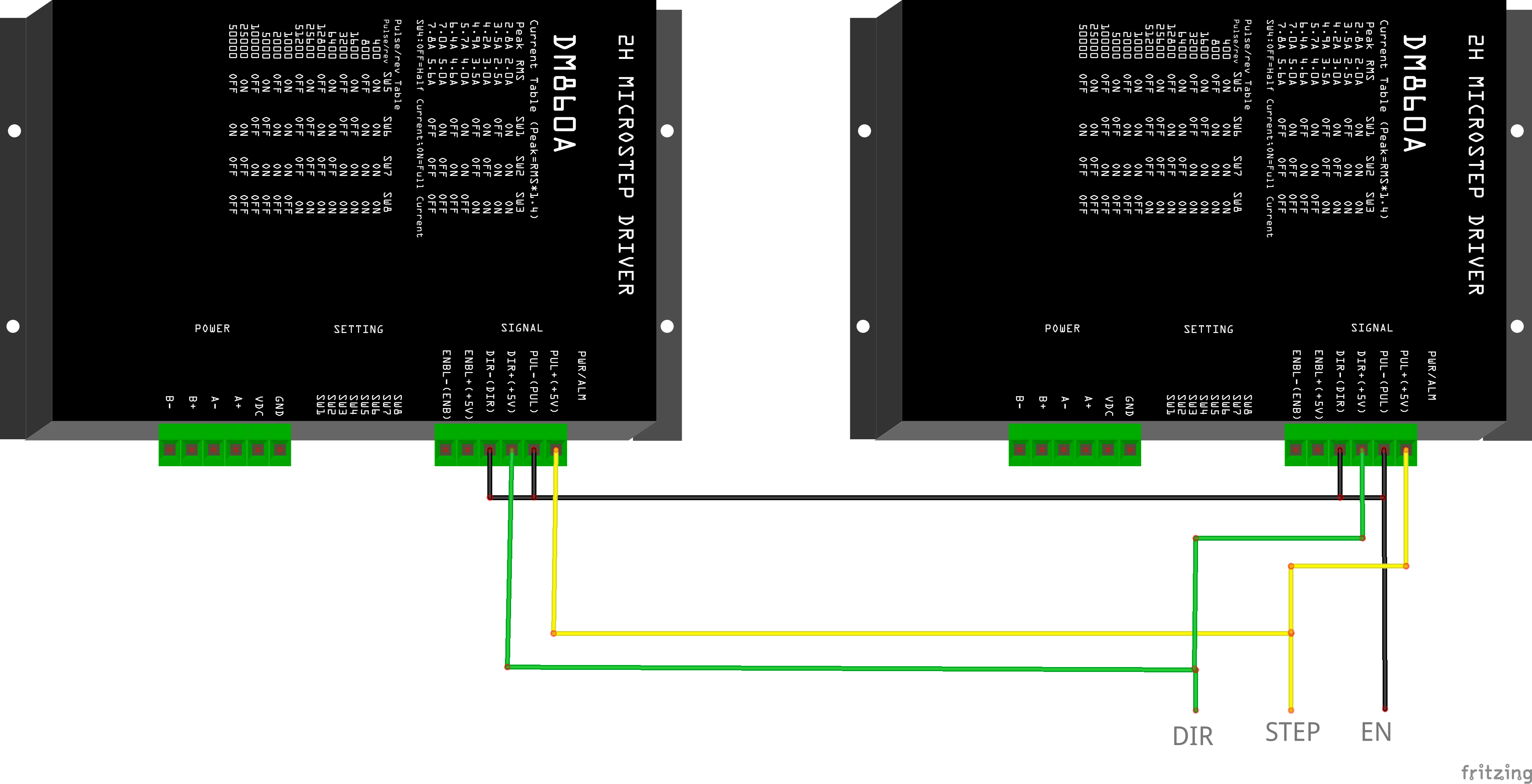

I need to slave y axis on a c-beam cnc.
Issue: only one motor moves
Hardware:
Sbase mkv 1.3
Microstep driver DM542
Firmware:
Smoothieware
Wiring scheme (simplified):
Thank you
Hi @mcdanlj,
Hardware:
Sbase mkv 1.3
Firmware:
Smoothieware

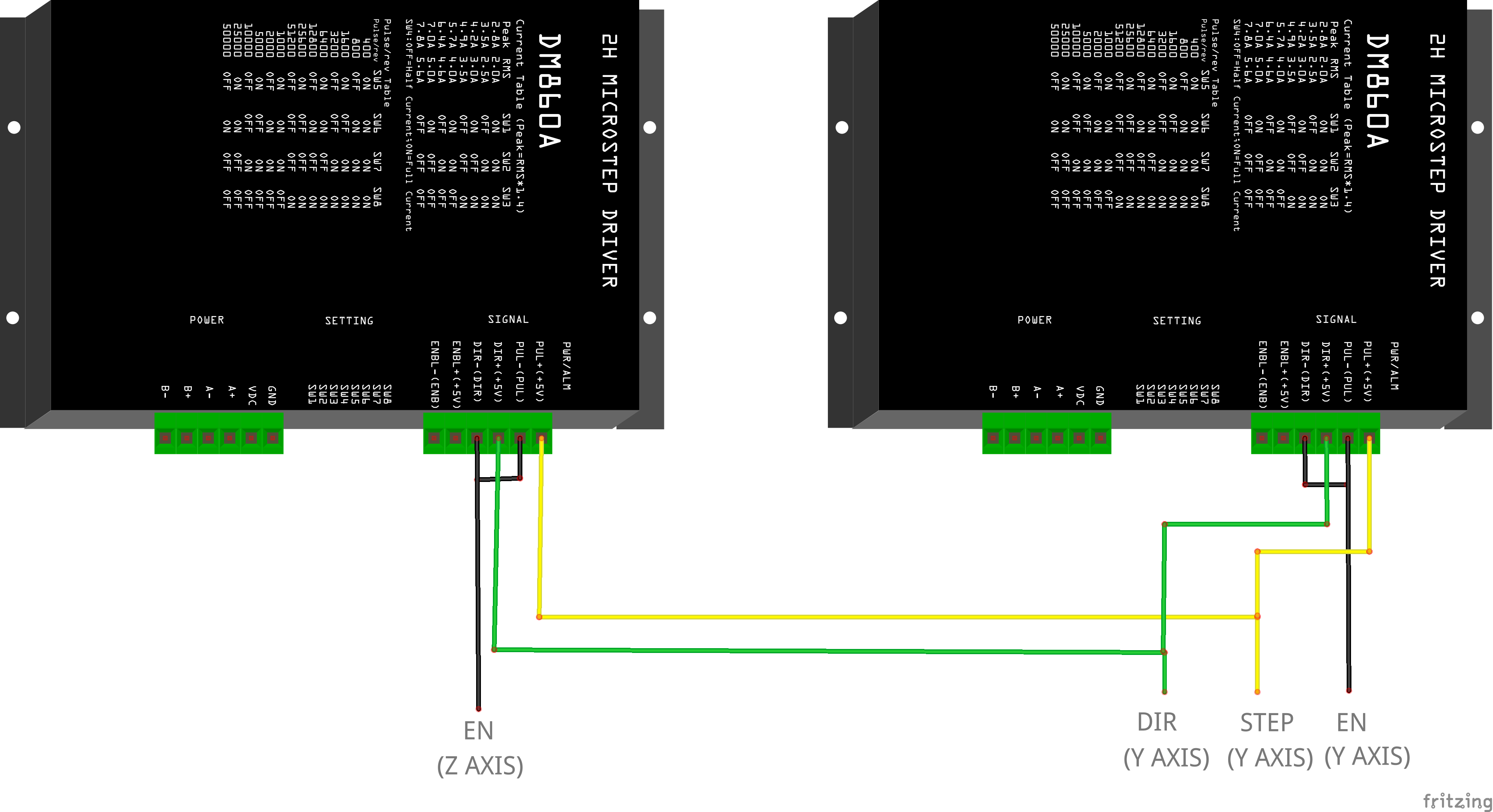

In this way everything works properly but I can’t use Z EN because I need it for the Z axis
In this way the motors move in only one direction (forward), in other direction only one motor move backwards

it seems i can’t share EN (PULL -) between two controllers

it’s possible the enable pin doesn’t have enough current capacity / the enable pins demand too much current. you can try using some sort of transistor/ssr/level shifter for that signal, or you can just tie enable to be always up if that’s acceptable for you
Thank you for answering.
Enable pin can be always up. How can i do that?
It’s in the documentation for the driver: either tie it to GND or tie it to 5V, depending on the driver.
