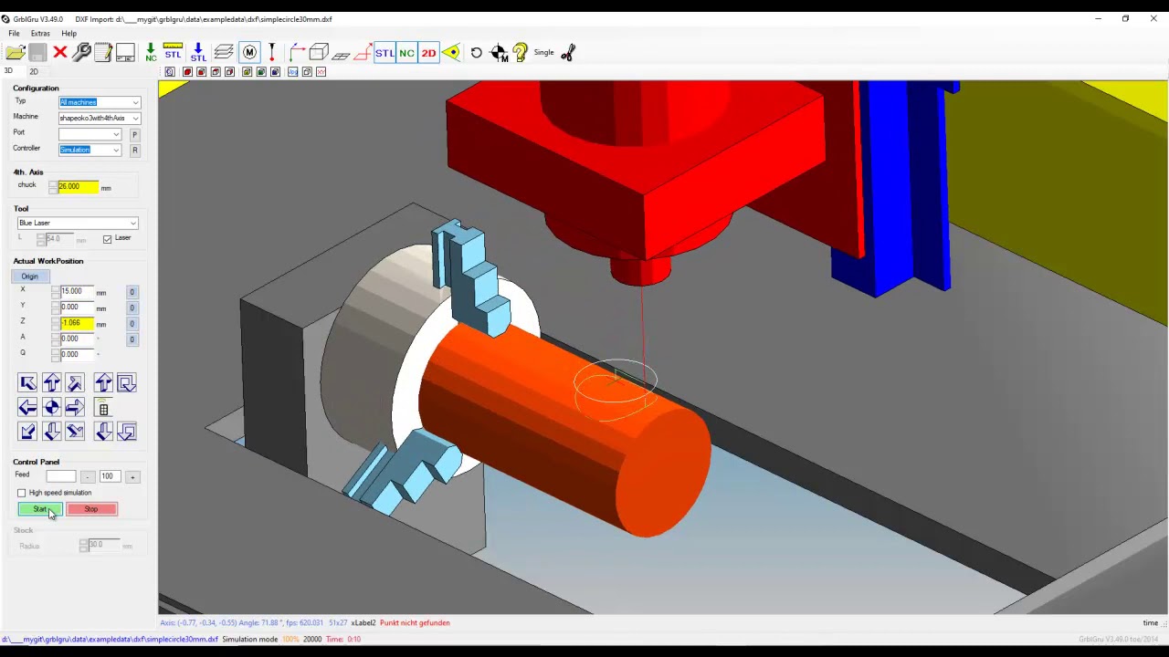

I was thinking of grblgru’s modeling functionality, where it lets you have a model of your device and stock and watch it work a job simulation. It’s an interesting concept. You wouldn’t need an inside stock feature to use it and you could certainly compare it if you are running windows (it is windows-specific) but also @GrblGru has been interested in adding device types to his set of models anyway.

I do not know the construction of the machine, unfortunately I cannot watch your video and I do not know your workpiece. :frowning:
But I agree with you that my program can’t help you with that. The problem are the calculated feeds for each move command.
I can only tell you how I calculate the GCode. Here is an example: A 30 mm circle is projected on a cylinder of 50 mm. As you can see in the little video there is only one line with feed. Maybe you can change your GCode accordingly.

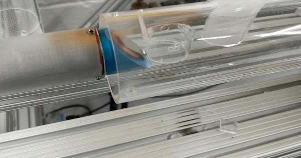

@GrblGru you should be able to see the video now. The laser is cutting from the inside.
