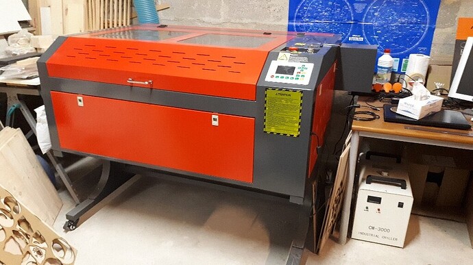

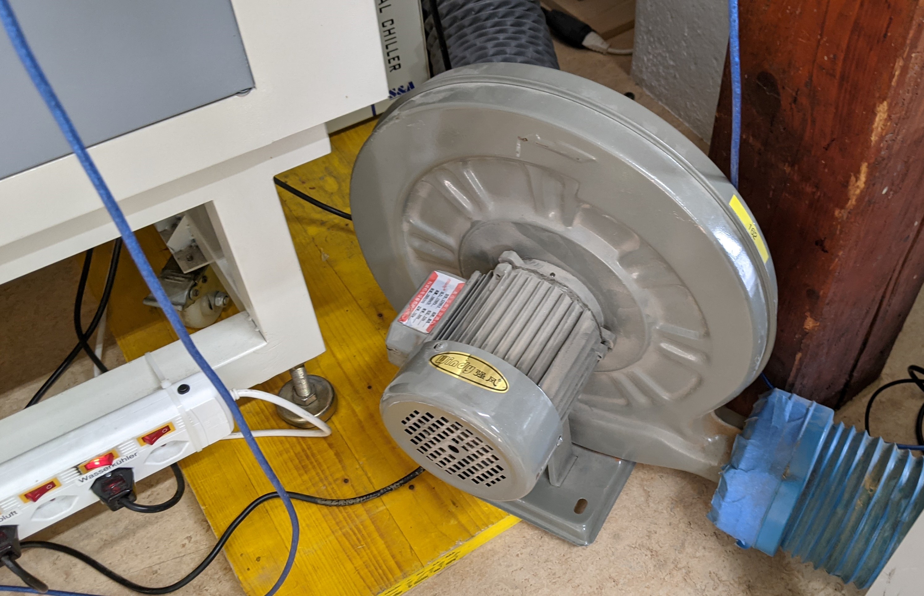

We use this fan to suck all the smoke from the cutting process. It works pretty good. From time to time we have to clean the inlet, to prevent clogging when cutting mainly MDF. So far so good.
The downside of this installation is noise. Especially when you have to work in the same room and the machine works 8 hours per day. We plan to replace the fan with a quiter one like this:

You might want to consider another radial fan instead of an axial fan. They don’t have to be substantially more expensive. What you have now is a high-velocity radial fan; you might consider a low-velocity radial fan for lower noise. What I bought for $55 last year was this:
Hm, our fan is running at 2800 RPM and yours at 2450. Not a huge difference. :wink: Do you control the speed with a regulator?
For velocity, I meant air velocity not rotor RPM; the radial/centrifugal fan I linked to has a wider air cross section and larger outlet, and I merely expect but do not know that it is designed to produce a lower volume higher velocity air stream than the kind of fan I linked to.

The centrifugal blower you’re currently using looks pretty beefy. Probably around 2/3 HP or 500 W, 1400+ Pa (at zero throughput), 660+ m³/h (at zero pressure), and a single-phase induction motor. That kind of thing.

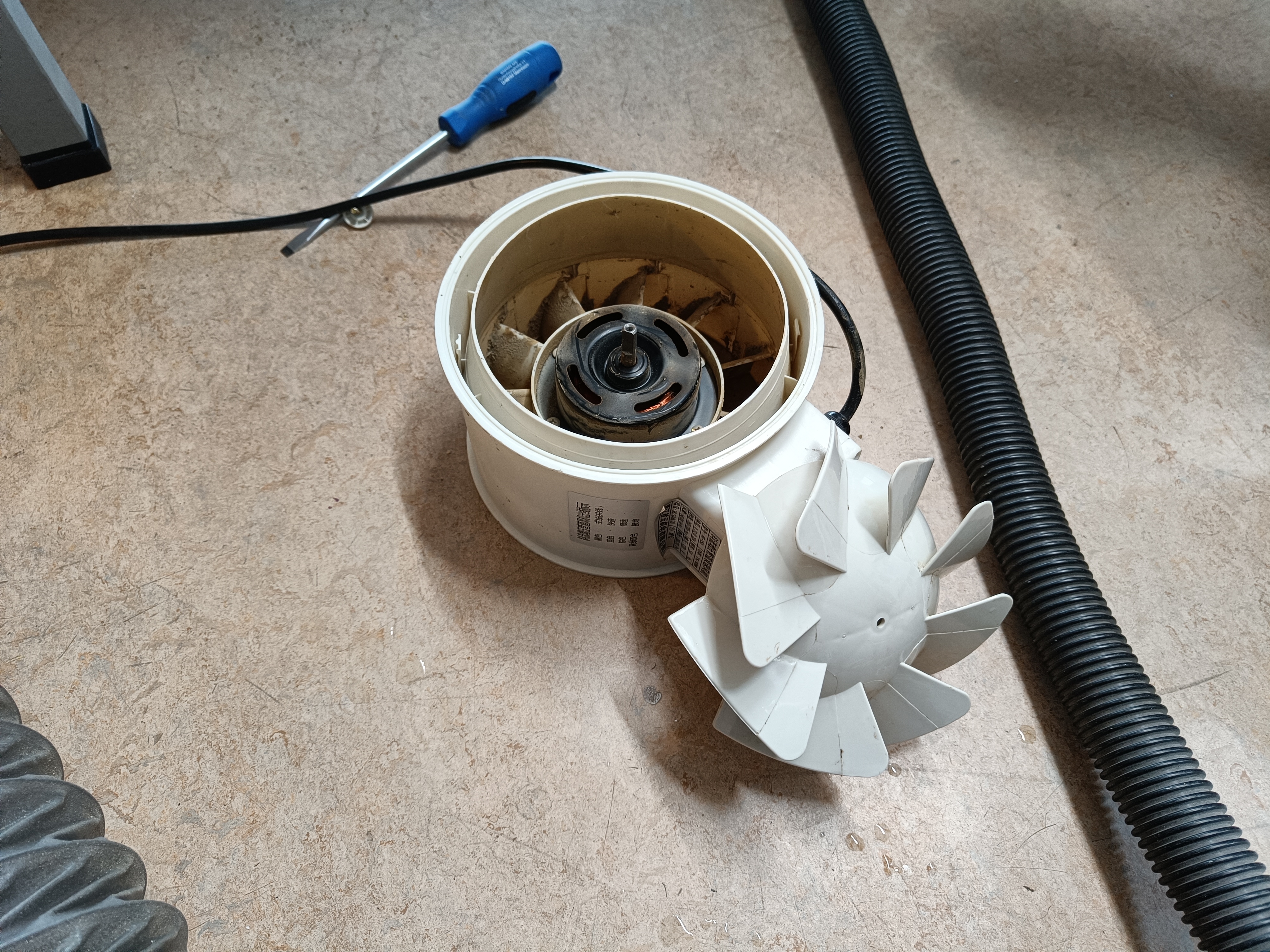

One and a half year after the replacement:
  • Way quieter than the original one
  • It sucks less smoke out of the laser but that was not a problem by now
  • The fan itself can be disassembled for cleaning without any hassle
I’m still happy with that solution. :slight_smile:
