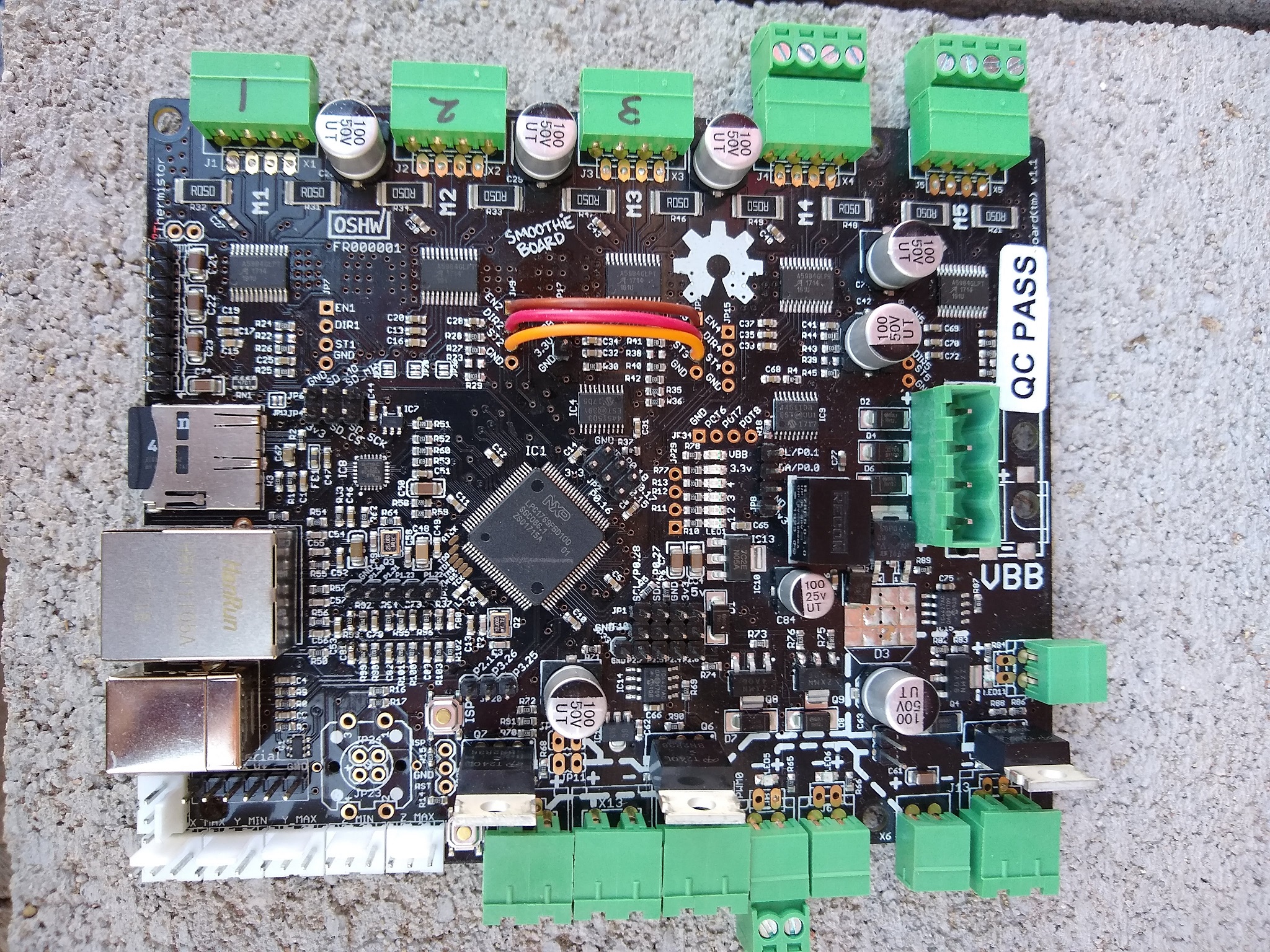

Hi. I bought a surplus Smoothie 5 axis v1.1 board on ebay a few months ago, and I’m finally getting around to making it talk. I have an Acro laser cutter kit connected to it. I have two Y motors (board jumpered to run both driver ICs from beta axis stepper commands) and one X motor. Both axes on the gantry move properly using pronterface, clicking the various jog rings for 1, 10, and 100mm steps. The limit switches all work properly, left right up and down.
Trouble is, when I give it a Home command G28 X0, the board immediately goes limp, and the blinking LEDs stop blinking. I have to cycle power to get it to respond again.
I don’t understand why it hangs. I have adjusted the homing speeds down. There are no Google results for this problem.
For what it’s worth, I’m an old EE who’s done decades of work on all sorts of embedded systems.
I would really appreciate some help in solving this.
It’s running the most recent stable firmware :
slight_smile:Build version: edge-bdb141f, Build date: Jan 12 2020 10:21:20, MCU: LPC1769, System Clock: 120MHz
5 axis

“Surplus” Smoothieboard? I’m curious, would you mind giving me a picture and/or link? Don’t bother if it’s too much effort, it’s just for my personal curiosity/staying aware of what’s out there.
Arthur,
Here’s the top of the board:
Here’s the bottom:
It looks like a real board to me. No typos.
I read a post from a few months ago about how some 3D printer company had a bunch of these that were surplus to their needs, and were selling them on ebay.
Yeah that looks legit, I’ve seen one already around here, still not sure what the company was though :slight_smile:

## Endstops
# See http://smoothieware.org/endstops
endstops_enable                              true             # The endstop module is enabled by default and can be disabled here
#corexy_homing                               false            # Set to true if homing on a hbot or corexy
alpha_min_endstop                            1.24!^            # Pin to read min endstop, add a ! to invert if endstop is NO connected to ground
alpha_max_endstop                            1.25!^            # Pin to read max endstop, uncomment this and comment the above if using max endstops
alpha_homing_direction                       home_to_min      # Or set to home_to_max and set alpha_max and uncomment the alpha_max_endstop
alpha_min                                    0                # This gets loaded as the current position after homing when home_to_min is set
alpha_max                                    200              # This gets loaded as the current position after homing when home_to_max is set
beta_min_endstop                             1.26!^            # Pin to read min endstop, add a ! to invert if endstop is NO connected to ground
beta_max_endstop                             1.27!^            # Pin to read max endstop, uncomment this and comment the above if using max endstops
beta_homing_direction                        home_to_min      # Or set to home_to_max and set alpha_max and uncomment the alpha_max_endstop
beta_min                                     0                # This gets loaded as the current position after homing when home_to_min is set
beta_max                                     200              # This gets loaded as the current position after homing when home_to_max is set
#gamma_min_endstop                            1.28^            # Pin to read min endstop, add a ! to invert if endstop is NO connected to ground
#gamma_max_endstop                           1.29^            # Pin to read max endstop, uncomment this and comment the above if using max endstops
#gamma_homing_direction                       home_to_min      # Or set to home_to_max and set alpha_max and uncomment the alpha_max_endstop
#gamma_min                                    0                # This gets loaded as the current position after homing when home_to_min is set
#gamma_max                                    200              # This gets loaded as the current position after homing when home_to_max is set
alpha_max_travel                             500              # Max travel in mm for alpha/X axis when homing
beta_max_travel                              500              # Max travel in mm for beta/Y axis when homing
gamma_max_travel                             500              # Max travel in mm for gamma/Z axis when homing
# Optional enable limit switches, actions will stop if any enabled limit switch is triggered
alpha_limit_enable                           true             # Set to true to enable X min and max limit switches
beta_limit_enable                            true             # Set to true to enable Y min and max limit switches
gamma_limit_enable                           false            # Set to true to enable Z min and max limit switches
# Endstops home at their fast feedrate first, then once the endstop is found they home again at their slow feedrate for accuracy
alpha_fast_homing_rate_mm_s                  50               # Alpha/X fast homing feedrate in mm/second
alpha_slow_homing_rate_mm_s                  25               # Alpha/X slow homing feedrate in mm/second
beta_fast_homing_rate_mm_s                   50               # Beta/Y  fast homing feedrate in mm/second
beta_slow_homing_rate_mm_s                   25               # Beta/Y  slow homing feedrate in mm/second
gamma_fast_homing_rate_mm_s                  4                # Gamma/Z fast homing feedrate in mm/second
gamma_slow_homing_rate_mm_s                  2                # Gamma/Z slow homing feedrate in mm/second
alpha_homing_retract_mm                      5                # Distance to retract from the endstop after it is hit for alpha/X
beta_homing_retract_mm                       5                # Distance to retract from the endstop after it is hit for beta/Y
gamma_homing_retract_mm                      1                # Distance to retract from the endstop after it is hit for gamma/Z
# Optional enable limit switches, actions will stop if any enabled limit switch is triggered (all are set for delta)
#alpha_limit_enable                          false            # Set to true to enable X min and max limit switches
#beta_limit_enable                           false            # Set to true to enable Y min and max limit switches
#gamma_limit_enable                          false            # Set to true to enable Z min and max limit switches
# Optional order in which axis will home, default is they all home at the same time,
# If this is set it will force each axis to home one at a time in the specified order
#homing_order                                 XYZ              # X axis followed by Y then Z last
#move_to_origin_after_home                    false            # Move XY to 0,0 after homing
#endstop_debounce_count                       100              # Uncomment if you get noise on your endstops, default is 100
#endstop_debounce_ms                          1                # Uncomment if you get noise on your endstops, default is 1 millisecond debounce
#home_z_first                                 true             # Uncomment and set to true to home the Z first, otherwise Z homes after XY
# End of endstop config
# Delete the above endstop section and uncomment next line and copy and edit Snippets/abc-endstop.config file to enable endstops for ABC axis
#include abc-endstop.config

See what you’ve done with the extruder? You shouldn’t do that. The general idea here is you should modify strictly only what you need to test your issue, absolutely nothing more. Once things work, you can get fancier with your file ( though things like this by the way, we still recommend you don’t touch if you don’t need to ).
Please get the example config file on the wiki, and edit absolutely strictly only what you need to modify to test this specific issue, absolutely nothing more, and report. Ideally you should be able to post not just the config file, but also a very short list on the modifications you’ve done from the original/example.
Cheers.
