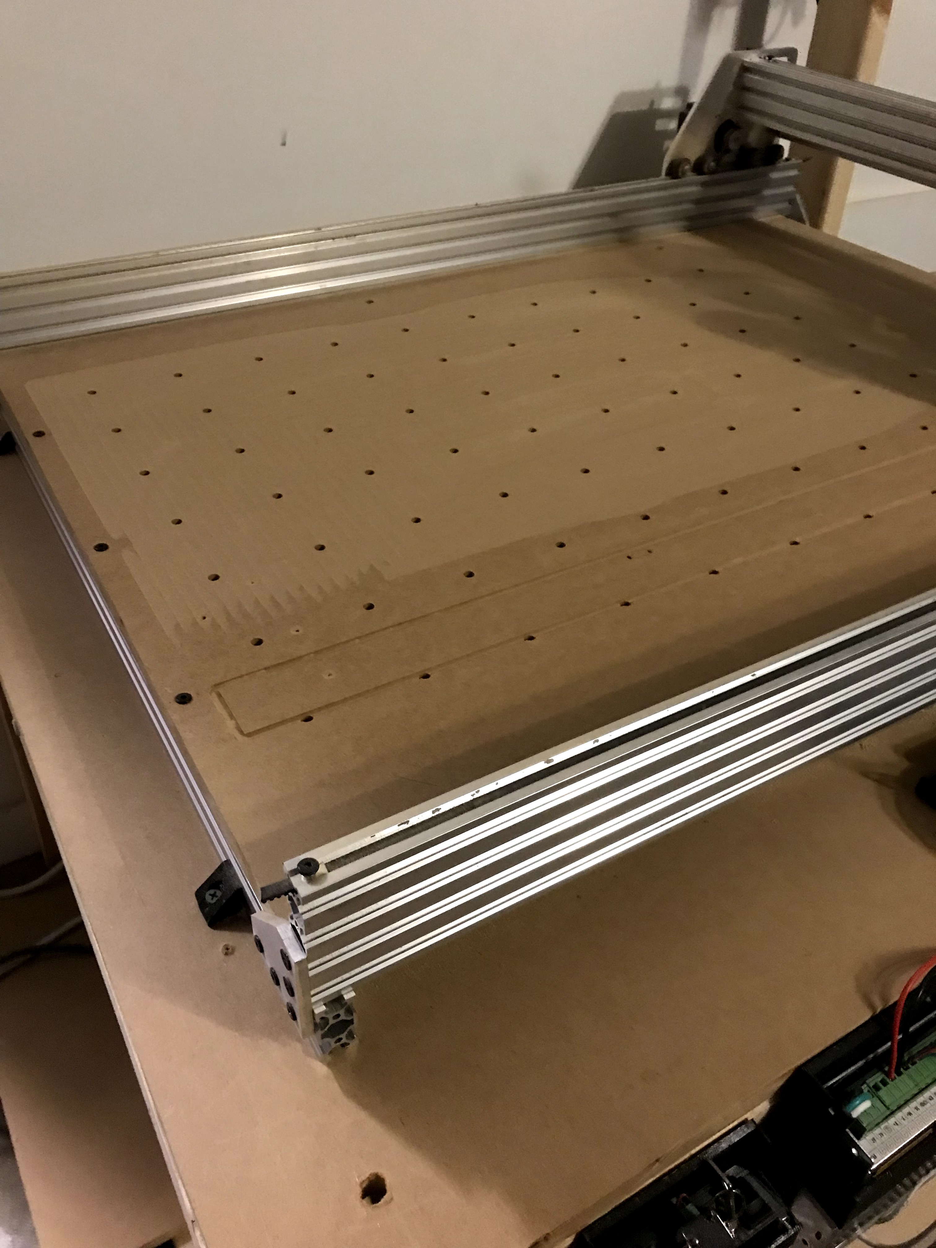

How do I tram the spindle? I am getting ridges along the X axis and the Y cuts seem good.

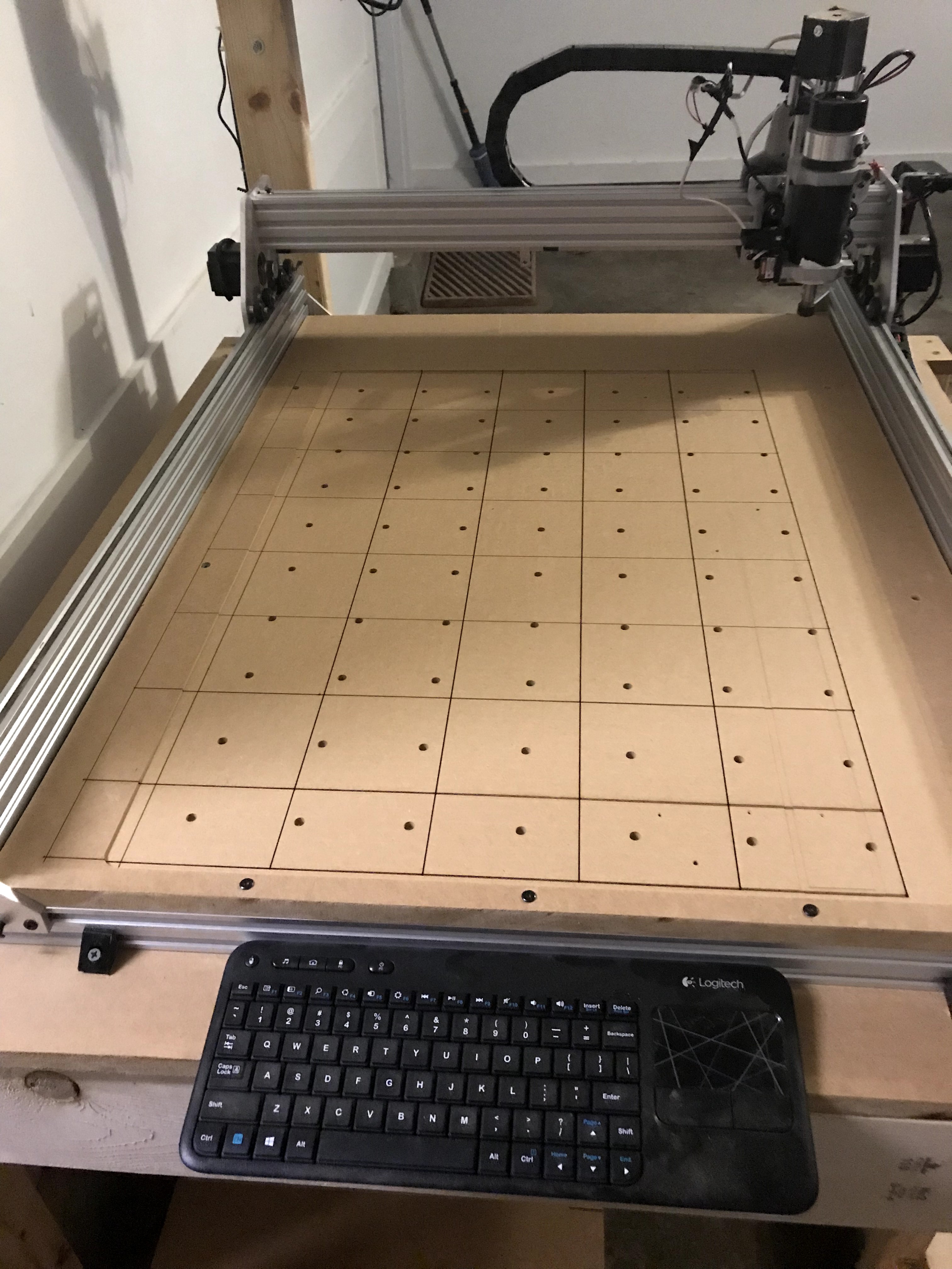

Used my laser to mark a grid on the spoiler board.https://plus.google.com/photos/102259857059828346431/albums/6657181188515298001/6657181196013664386
@Awesome_Coder Nice! I have a 500mw blue diode laser I’ve been thinking about ripping out of its box and putting on my Ox.
