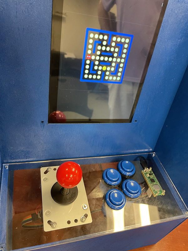

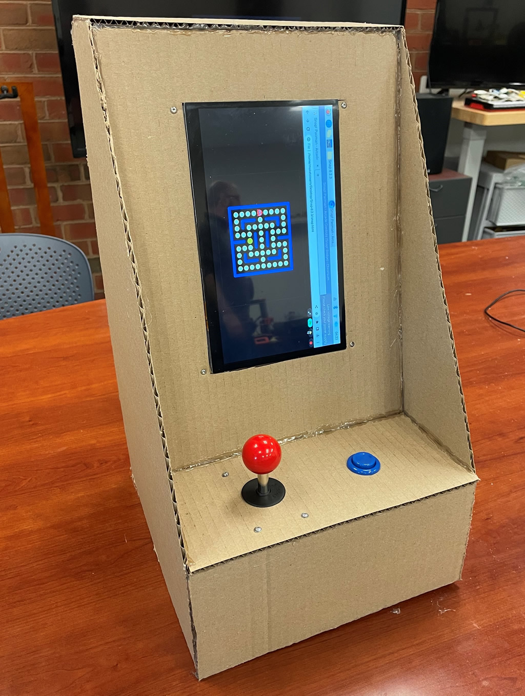

Here’s the current prototype for the arcade cabinet. We’re using a Raspberry Pico as a microcontroller to monitor the arcade controls. The Pico is connected to a Raspberry Pi running the Snap! program.

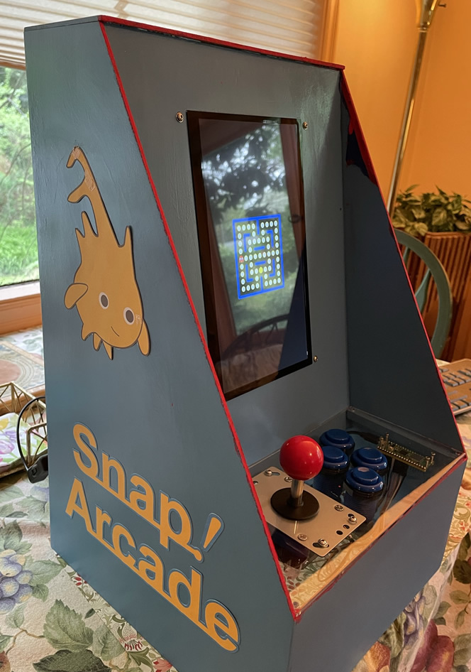

Here’s an initial dry fit of the arcade artwork mounted on the cabinet.
