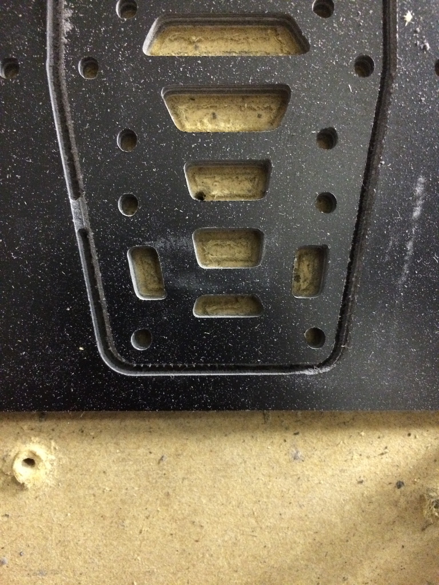

So I’m still having issues with my Ox router offsetting the outside cut of the part from the holes in it. At first it was shifting over on the Y axis and now it is doing it on the X axis always about the same amount but just enough to ruin the part all together. Any help would be greatly appreciated, strange that it’s only doing it between operations, I wish I could cut the whole part in one operation and just choose the order so I can make it cut the outside last I think that would roundabout fix it.
I am not exactly sure what you are describing. But if I do get this… I think you are talking about “drift” or aka backlash. Belt tension is the most likely suspect in that case.
My original guess was that the collets that lock your lead screw in place were loose. Now I’m thinking you are missing steps somehow. Slow feed rate down just a tad or try a different USB cable?
Grab an axis and see if there is play in it?
Ok, my belts are pretty tight now, very little slop if at all between the L&R sides of the machine. My rapid speed is set to the default 2540mmpm maybe I should slow that down but with the belts tight I know it’s not slipping teeth so how would a faster rapid hurt it?
So not about slipping belt teeth. If your motor is running too fast for the torq it provides, the motor gives out and skips a little; this is called missing steps. Usually you can hear motors make a high pitch wine for a second or two .Your program keeps running as though nothing happened, except now your out registration is off. Often happens between moves where motors are accelerating too quickly. Slow the acceleration down a tad.
Unrelated to missing steps or belt tighness. Grab your router when machine is off and see if you can move x axis side to side. Collets might be tight but not snug against your pillow blocks.
Are you using tinyg? If so, which version?
Do you have two belts for an axis? If so, they need to have the same tightness.
I agree with Todd Hewitt. You can’t have the router rapid between cutting positions too fast. Just doing a series of rapids in mid air should help you test your accuracy during rapids.
Yes, TinyG old version, not the newest one. I think it might be the rapid between operations. I’m gonna go try it and I’m gonna slow the rapid down from now on and see if that fixes it. Is there a way to change the default rapid to the new lower speed? Thanks you guys! you help me a lot and I need it!
