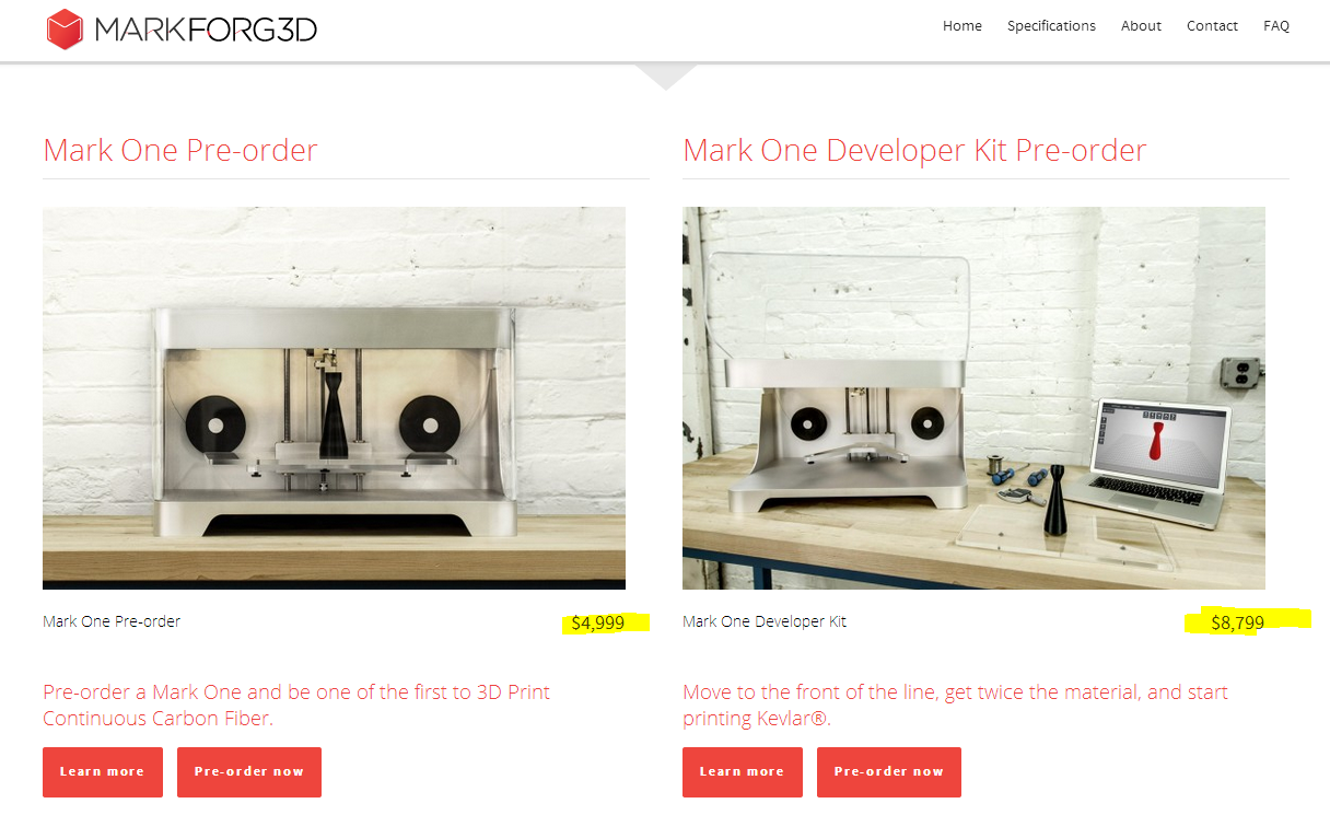

So who is thinking about the Mark One…???
Originally shared by Ryan Matthews
MARKFORG3D Mark One Carbon Fiber 3D printer goes on pre-order today starting at $5k!!
https://markforged.com/mark-one/
#3dprinting
#3dprinter
#3dprinting
#3dprinter
Material costs: https://markforged.com/mark-one/the-materials/
$550/lb. Totally bonkers.
