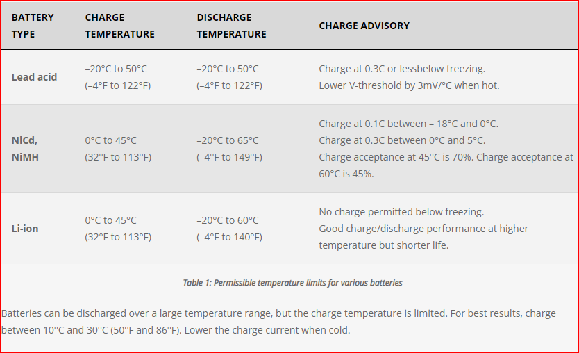

While working on the design today I found this disappointing tidbit:
Ah *^@! …thats a stab through the heart for this project.
You should not charge Li-ion batteries below freezing. Here in Utah that is most of the winter. Lead acid is the only battery chemistry that can charge below freezing.

Tesla batteries have a heater that warms them up before charging.
If an RV has LiPo(should be LFP/LiFePo4) and all they need to do is bring it down to storage voltage level and disconnect it. No need to keep it topped off like Pb batteries required.
As for charging the LiPo in freezing, I would look at how much energy it would take to warm them to 33DegF(or the lowest rated temp) and see if there’s enough left over for charging or if you have to increase your solar panel wattage size.
Alternatively, how far down does the ground freeze where you are? The earth is a pretty amazing thermal battery; you could bury batteries in waterproof boxes deep enough to never freeze?

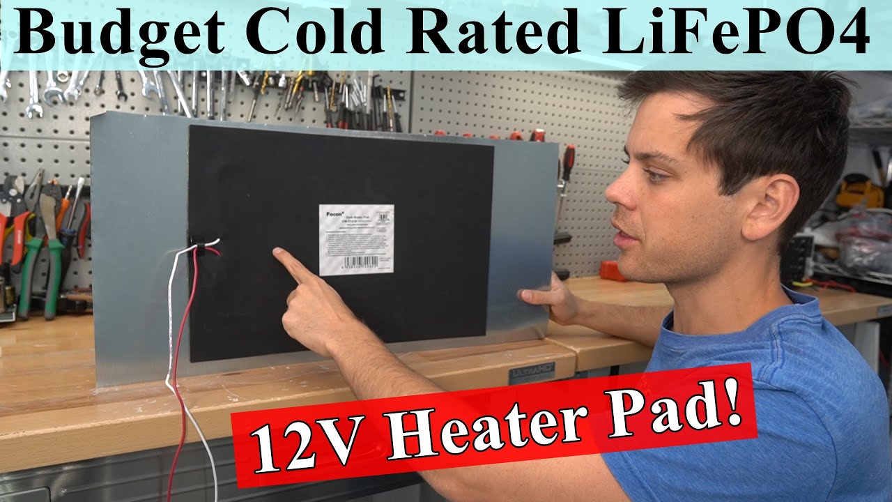

There might be an easy way to do it depending on how small you were thinking the battery will be.
A calculator might be handy to figure out how much it might pull from the solar panel and only turn the heater on when the panel is generating. Hopefully most of the solar charge current would be used to raise the battery temp and then when the pad turns off, the power goes to the battery.
Rube Goldberg is watching just for fun.
and there are lots of 12V heating pads of many different power output ratings. IIRC there is a thermal switch listed in the above video or possibly ( * One Battery Heater Switch (Part No. EV-V120-BHS $8.00 ea. Retail plus shipping). )
https://www.amazon.com/s?k=12v+heating+pad&i=tools&crid=2EY0HUQKTEZY2&sprefix=12v+heating+pad

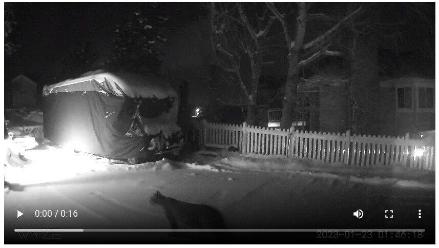

I don’t know why the video in my first post will not play.
Its a video of a mountain line in my driveway.
It’s because it uses the H.264 video codec instead of the MPEG-4 video codec, even though the filename ends in .mp4 (an MP4 file isn’t limited to video encoded with the MPEG-4 codec, perhaps surprisingly given the name), and some browsers don’t handle that. Firefox on Linux doesn’t play it, though I can download it and play it locally just fine. Chrome shows the initial image in a player, but the player doesn’t actually play for me.
