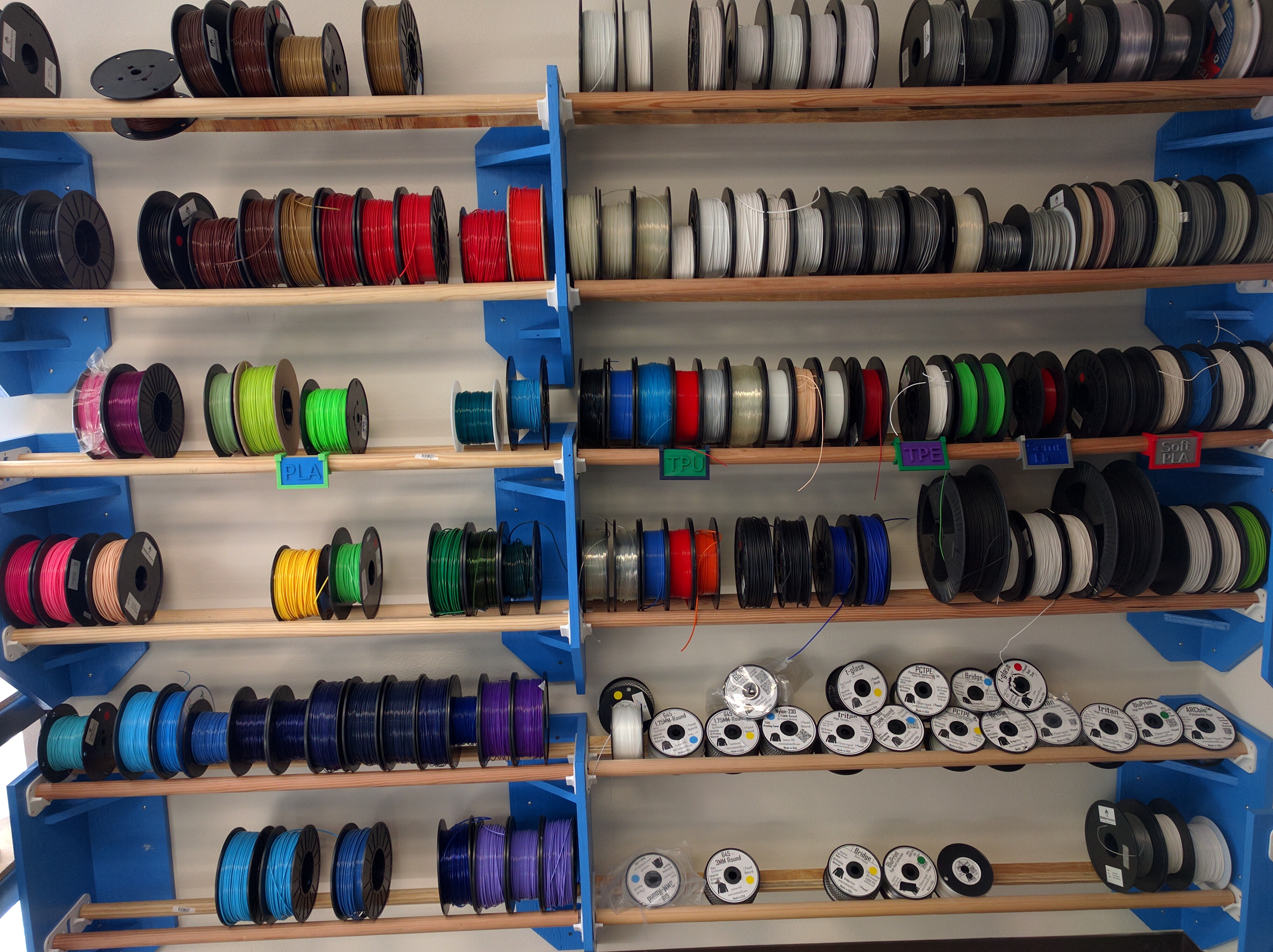

Sometimes, I really just need to take a deep breath, take a look around the office, and remember what an awesome job I have. I mean, c’mon, I have this I get to play with everyday. How bad could it be?

@Melissa_Blanchard looks like my filament collection! cept this is his jobs collection :wink: hehe
Are those brackets the wooden beams are resing on printed?
They most certainly are. Good eye

Sweet except for the possible humidity infiltration. Have you noticed any effects in your prints?
If/when we notice moisture in a roll, we throw it in our vacuum oven and dry it out
How does doing that affect the quality of the filament? Have you noticed any degradation in its properties once it has printed out? Does a spool of filament that has been put in the oven print any different than one that is “factory fresh” and not affected by humidity. I would really be curious about that.
No. Pulling vacuum significantly lowers the boiling point of water. We heat the oven to 110F then pull vacuum. This doesn’t affect the filament in any noticeable way.
