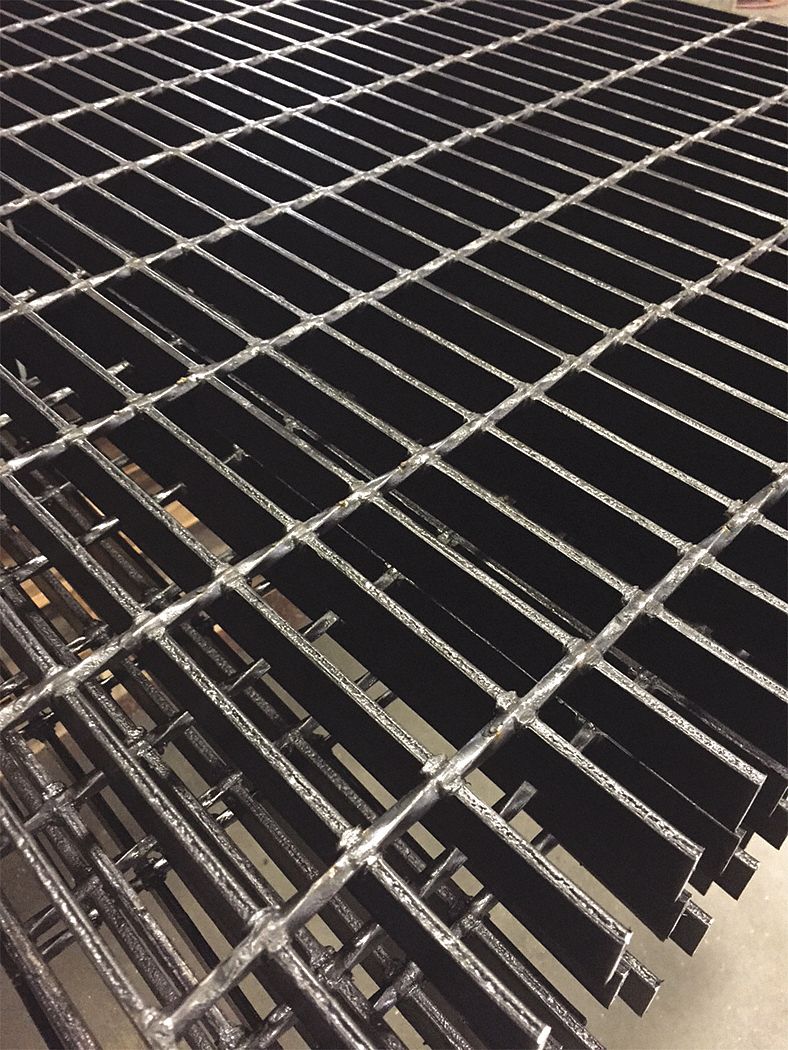

And as @funinthefalls points out, we have built a support structure to keep it from sagging. The honeycomb material itself is as stiff as 3mm MDF, it will not hold any shape. A larger aluminium ribbed structure is underneath it, but I have also seen people (in for instance a Lasersaur) use a piece of the galvanized ribbed structures used in scaffolding and stairs. Don’t know the exact english term for it though, like this image below…
@Steven_FF Ah, nice idea. I wasn’t sure what term was used in industry, but it looks like it’s “grating” as in “walkway grating” or “bar grating” — at least, that gets me lots of search hits. :relaxed: Here’s an example that is rectangular rather than square:
That might be too heavy for my bed suspension system, though.
What you show there looks like press-locked bar grating:
https://www.steelgratingsupplier.com/steelgrating/press-lock-bar-grating.html
I might use lengths of angle or square tube at a 45⁰ angle underneath instead.

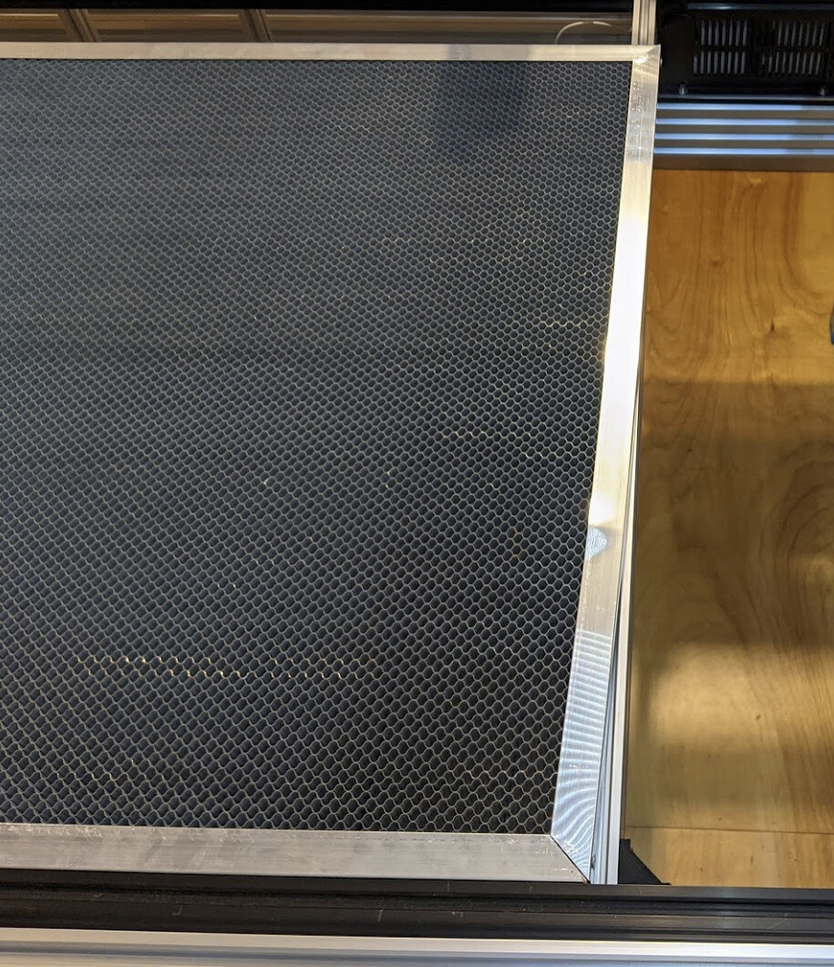

I didn’t think to test the bed for being square when it arrived. When I set it into the frame, I discovered that the bed was far out of square; it’s trapezoidal with a skew of over 20mm. That’s pretty bad. :frowning:
Here you can see how crooked it is, as well as the damage to the frame. The bed it is sitting in is square; the frame is decidedly not square.
I emailed lightobject asking for their suggestion for remediating the problem, but haven’t heard back.
Here it is in context: The top of the black bed frame is aligned with the top of the honeycomb, so I can cut past the edges of the honeycomb when I need to, but most of the time I’ll be operating only over the honeycomb.
Lightobject complained that I hadn’t brought this up soon after it was shipped (when I thought it was just cosmetic and was trying to not be a nuisance) but suggested a soft hammer to knock it back into shape. It’s now close enough, I think.

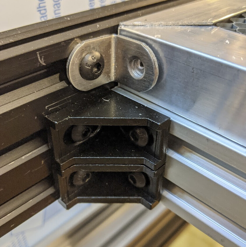

Holding the bed in place with a few angle brackets, like so:
