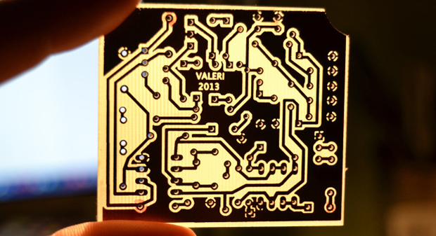

the issue isn’t squaring the work piece to the bed, the issue is that holes need to match up to solder pads… the misalignment creates the situation where one end of the pcb the holes are dead on, but the further away from the origin of the piece (or homed position) the the more the holes end up not being center to the pads till eventually they don’t line up at all…
this image is an example. notice the holes are dead center of the pads in the upper left quadrant of the board while the lower right quadrant (and lower half for the most part) the holes are practically outside the pad entirely
