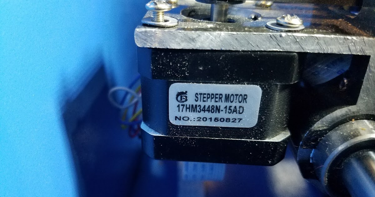

Has anyone run across the stepper motors on the K40 getting worn to the point they chatter?
You’ve all probably seen a toy car or cheap DC motor wear to the point that when the motor tries to go fast it slows considerably and chatters as it wobbles in the bushing and how a tiny drop of oil will get it working for a short period. That’s the effect I’m seeing and hearing.
I even removed the X axis bearing, OMG they bolt mirror #2 right to the motor, and ran it out of the machine in raster mode at 200 and 300mm/s over 200mm distance and it noticeably chatters even without side loads like when installed and belts are tightened.
I didn’t think bearings did this but since I popped the back off of the motor, I can feel and see slight movement when twisted 90 deg to the axis of rotation.
I also recall that these are not GT2 belts and so bizarre you don’t find grub-screw based gear drives and these puppies are heat pressed onto the shaft. Replacing motors, pulleys, belts and idlers the only option?

I found Don’s Things blog post on the K40 motors he ran across and sure enough, 0.9 deg 0.48A NEMA17 on X and 1.0A on Y.

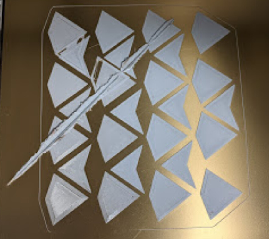

I’m so glad that I encouraged you to do this, because this evening I checked the print I started this morning and saw this on my corexy:
That long diagonal isn’t supposed to be there. My left rear motor seized partway through the print.
I pulled the stepper apart and found that one of the bearings was running a little rough and the other… well, the other had most of the bearing material in bits suspended in the space between the rotor and the bearing, but turned only with great difficulty.
I’d had a few failed parts with skipped steps inconsistently before this print, and now I know why!
I didn’t find any loose 625ZZ bearings around the house so I just dropped in another rotor assembly after diligent cleaning, but then I realized that I could have robbed my stash of loose openbuilds wheels, each of which has two 625 bearings. I now have an order for 625ZZ bearings coming in any case! Can never have enough common sizes of bearings, right? :relaxed:
