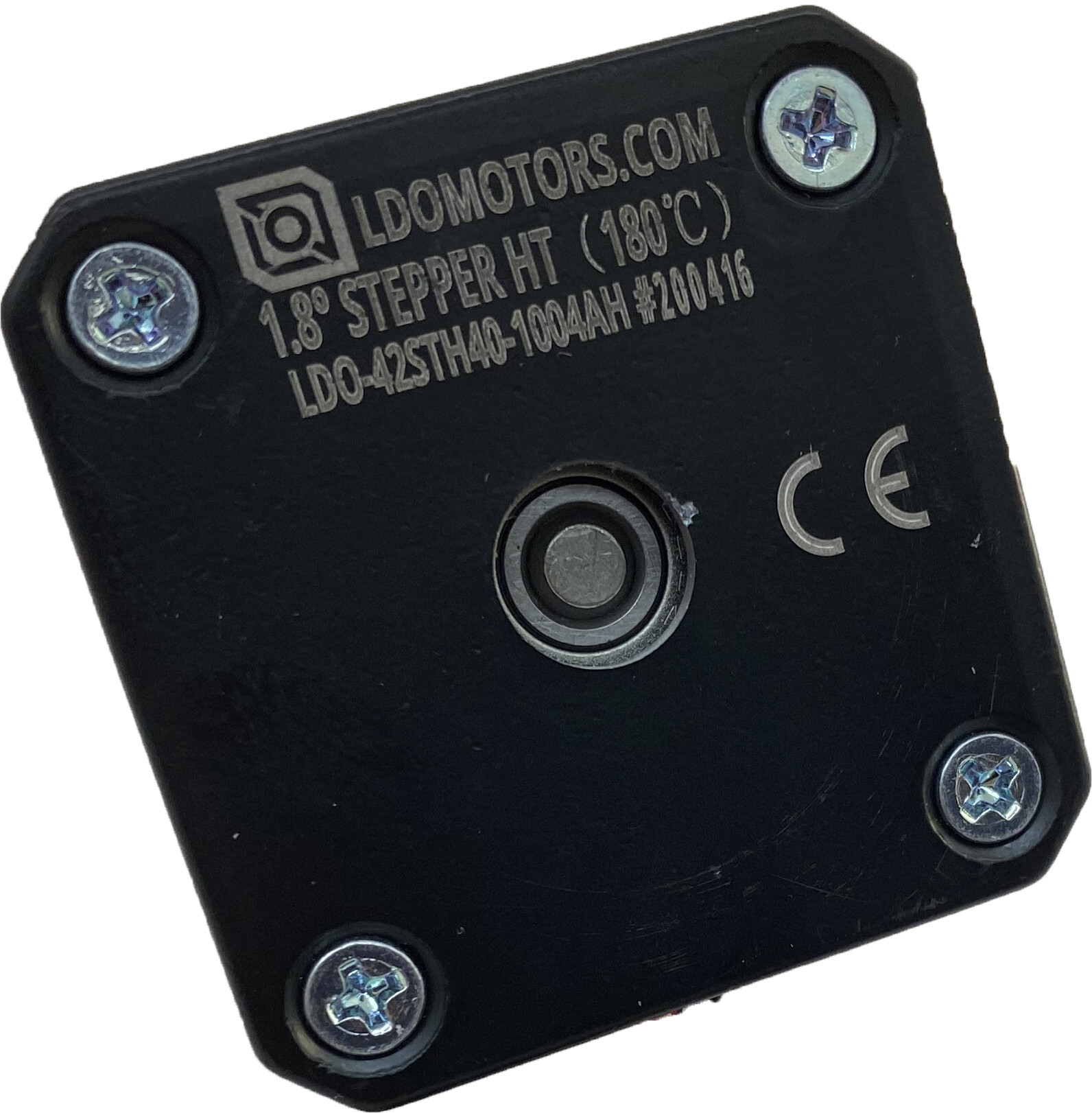

At 120°C you’ll definitely want the high-temp steppers or water cooling. :smiley:
Is the set you are looking at from Printed Solid high-temperature steppers? Is it this set?
Note that some of those are 0.9° and others are 1.8° steppers, and only some of them appear to be high-temperature. It looks like the 0.9° motors are high temp, but not the others. It looks like they are:
Likely high temp, if it’s actually the same motor as this:
Regular, if it’s the same motor as this:
And it’s not clear that they ship the extruder motor separately because it only shows up in the kit so I can’t link to it, and I see no indication of it being high-temp.
The specifications PDF on the set of motors has nothing in it about high-temp for any of them. You might contact Printed Solid and ask before you buy that set for a high-temp enclosure, unless you intend to go with water cooling anyway.

I don’t see any indication that those are all high temperature and I’d ask Printed Solid about it before ordering.
I believe the STH in the model number denotes that they are high temp. but I am going to check…
I stand corrected the H denotes Hybrid
Update,
I am returning the LDO stepper kit and purchasing all high temp steppers. and a higher temp bed.

Things are finally coming together. I’m printing an enclosure for the controller and LCD screen. I have my new LDO High temp steppers in place My 1000 watt Enclosure heater is together, and my duel Z axis stepper system with timing belt are smoooth. Also I have the 110VAC bed heater and the SSR. OK, WHY you ask? I want to make real solid brackets and mounting parts for other toy’s I am building in the next couple years.
