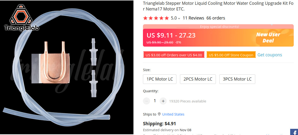

Water cooling
I’ve been satisfied with a bunch of parts from trianglelab:

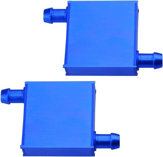

Or you can repurpose devices meant for something else:

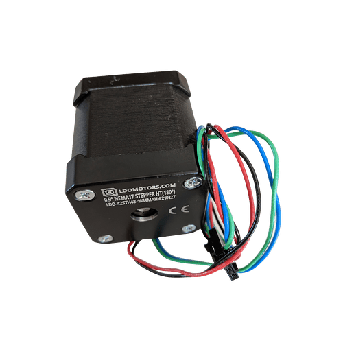

High temperature steppers
LDO has high-temperature steppers rated to 180°C e.g.
https://www.printedsolid.com/products/ldo-nema-17-motor-high-temp-voron-ldo-42sth40-1004mahvrn
https://www.printedsolid.com/products/ldo-nema-17-high-temp-voron-ldo-42sth20-1004ashvrn
