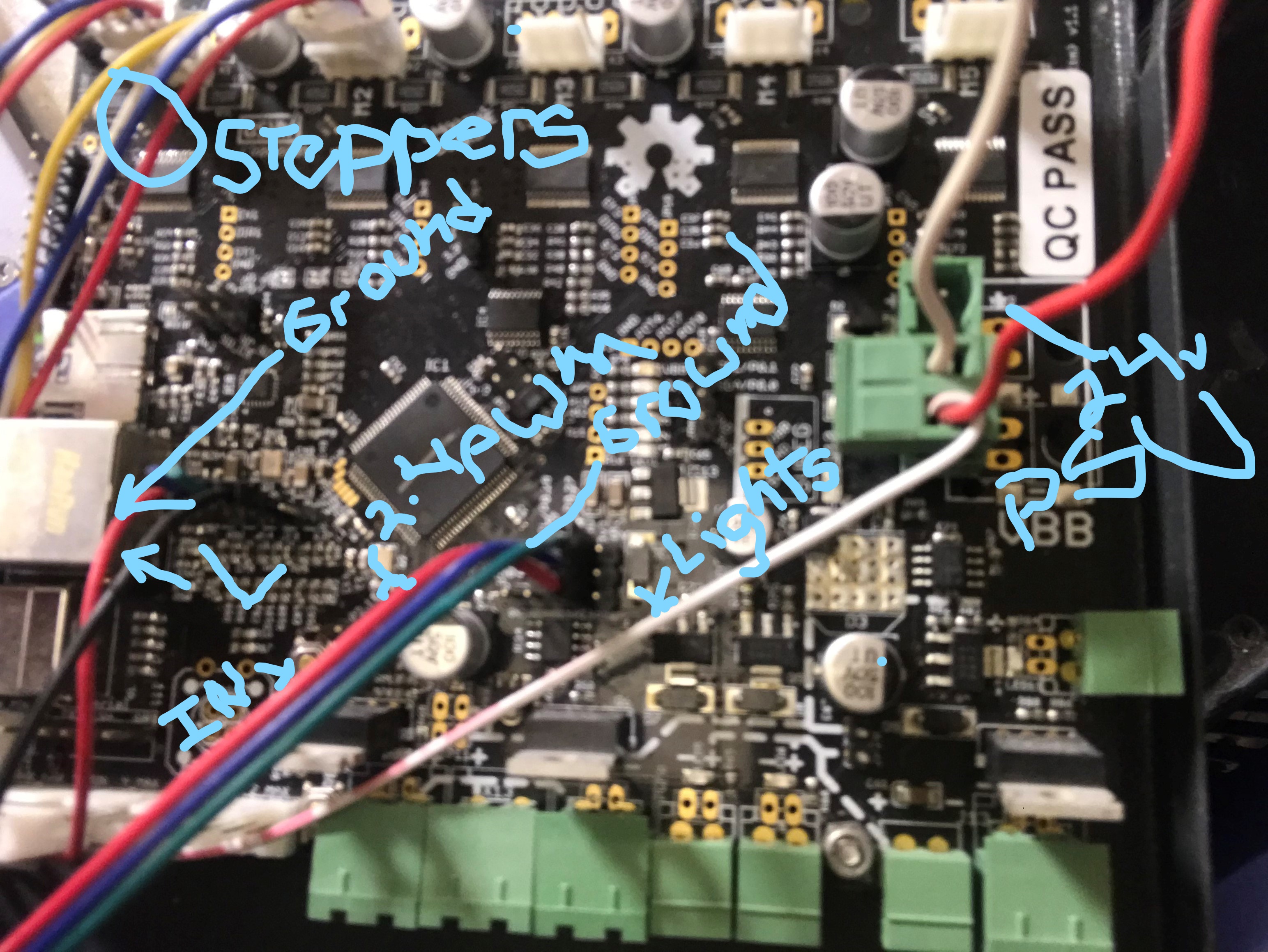

Ok i have a k40 laser that i ugraded to a cloudray LPS 100w , 100w tube and a smoothieboard 5x v1 and have not been able to get it to do anything for a month btu a couple days ago i recieved my second smoothieboard and installed it and was able to get my steppers runninghow i like them but still cant get the laser to work yet, It will fire manually and for a sec it was firing immmediately as soon as i closed the lid on the machine.I tokk the stock potentiometer out of the anyequation not sure thats a good idea but i did it…Can anyone help me out cause i am just confused and irritated at this point

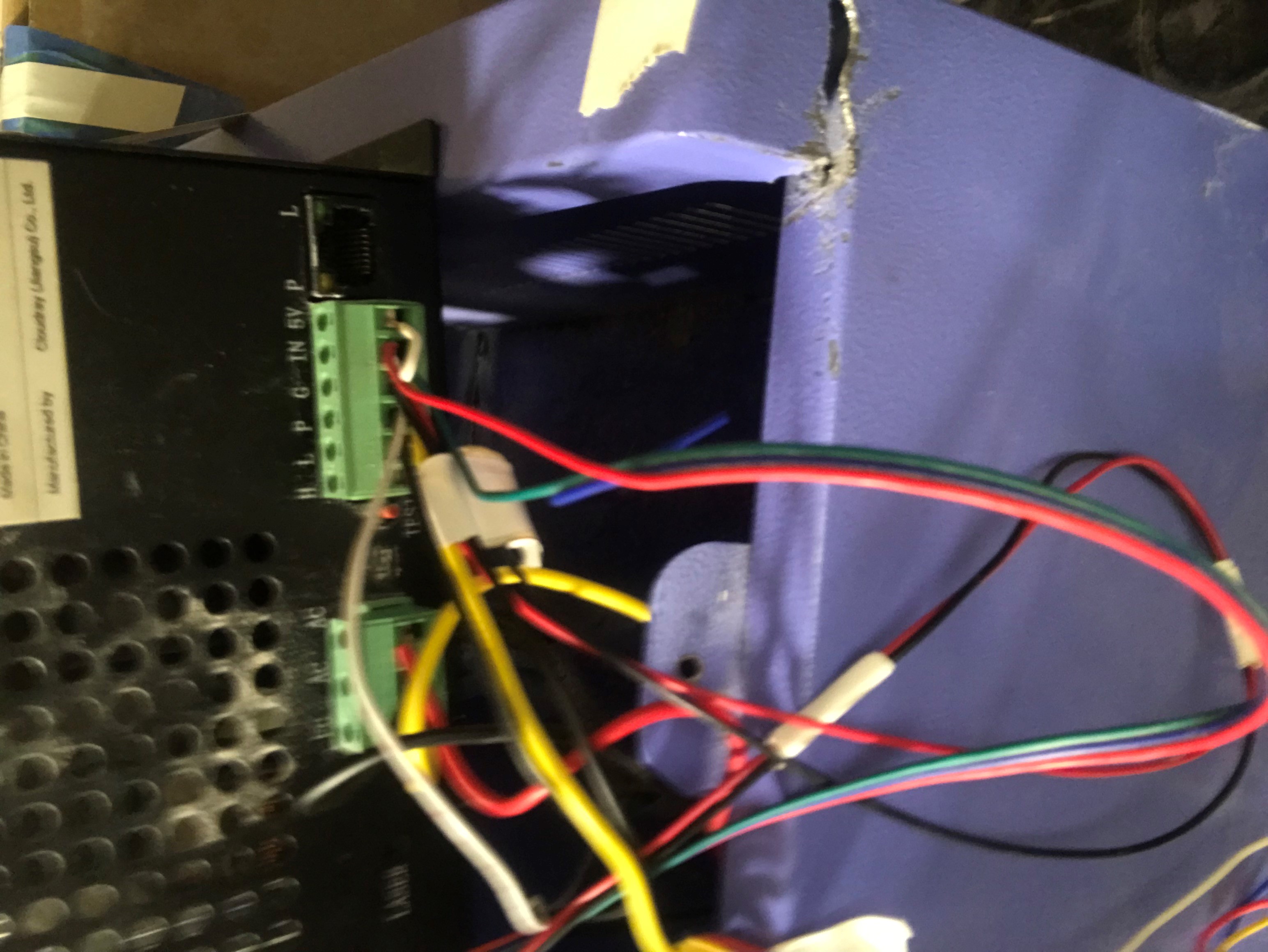

Post pictures of smoothie wiring and the connector side of the lps. Also post picture of control panel front and back.

How is your smoothie connected to the LPS?
the blue wire in the middle of the pwm2.4 and the ground is floating no connection

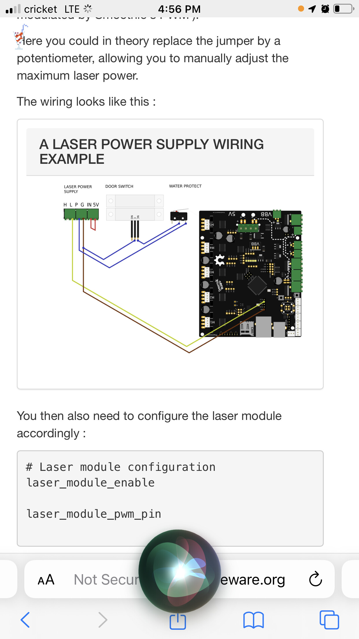

I just unhooked it cause I didn’t see it in the drawings that I followed. I can reconnect if no
What drawing did you follow?
It will reduce our troubleshooting time dramatically if we can draw a schematic of how the LPS is wired to the control panel and the smoothie.
My guess is somehow you have the lid switch wired to the LPS fire function.

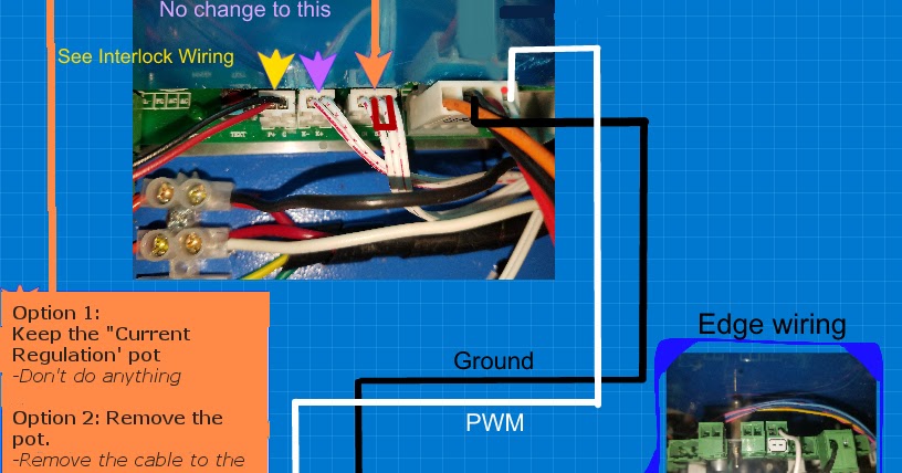

Take a look at this link and how my machine is set up including the configuration file that you got.
I don’t care much for LPS connections internal to the smoothie board.
It sounds like you may have the wrong polarity PWM signal. (laser fires when cover open)
There are multiple ways to set up your connection between the smoothie and the LPS. I suggest following my approach as it is well-proven and will be easier to troubleshoot remotely.
