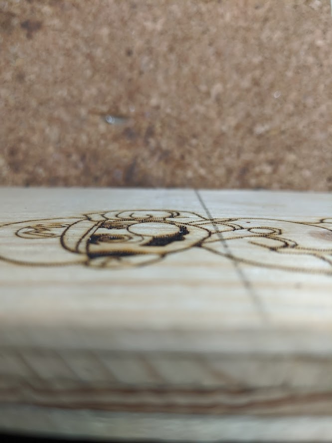

Want to post A/B pictures, including as close up as possible, of the differences? :slight_smile:
Good idea :slight_smile:
I’ve attached some images to try to best capture both the depth difference and the darkness difference.
The depth is a bit hard to show in the pictures, but its most noticeable at the boundary of the nose. I also measured the depth with a caliper and it was .4mm with laser mode off and .6mm with laser mode on.
To me it’s interesting that laser mode cut deeper despite using the exact same gcode, while at the same time also produced less black lines… If it cut less deep and was less black I could explain as perhaps laser mode was applying less power to the laser, but to me deeper cuts suggests more power while less black I would think represents less power so I’m puzzled…
