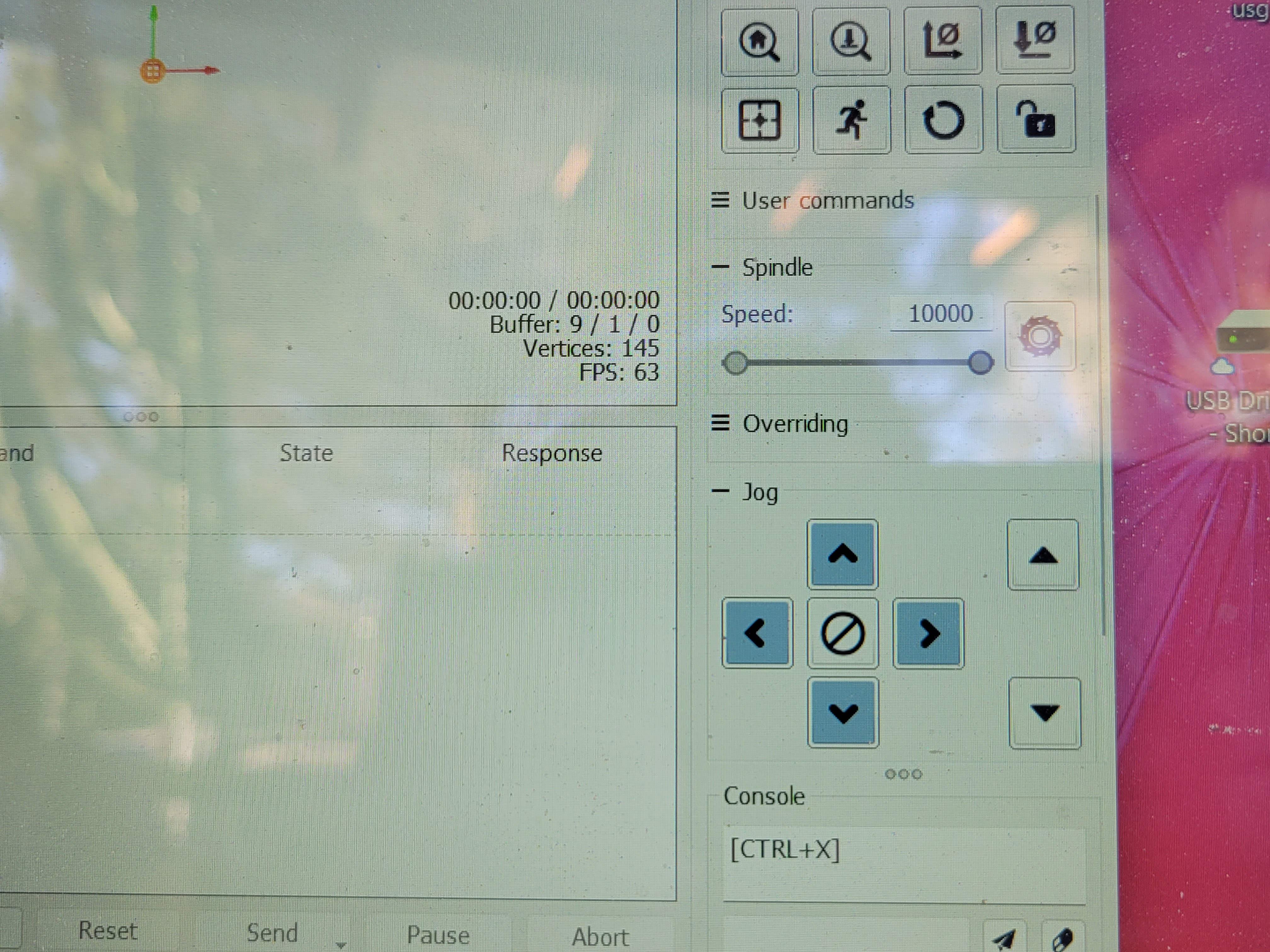

Hi I’m new ti cnc and new to the forum and new to forums in general. So I apologize if this isn’t posted in the right place. I bought a genmitsu 4030 PROver xl a couple weeks ago. And so far it has worked ok aside from user error. Today I connected to my computer turned on the control box and launched candle and in the console window it says control x. So I pressed reset, unlock, home, jog and all the other functions and nothing happens. I typed control x woth the keyboard nothing happens. I checked the com and baud they are correct. I turned the control box on and off several times nothing changes. I closed and launched candle several times nothing changes. I restarted my computer a couple times nothing changes. Im very frustrated and its probably something simple. What am I doing wrong? What do I need to do to get this machine moving again.
Please upload a screen shot of this.
Upon opening of candle this is what i see. No alarm for unlocking.
I think Candle prints this if the control board isn’t responding. (I haven’t encountered exactly this in my own use.)
If I’m right, $$ won’t work either. Do you get a parameter dump if you type $$ and send in the console?

You are correct. I did try $$ and nothing happens. Hopefully i dont need a new control board. I will try the sequence pf resarting and rebooting that you mentioned.

There is a nearly 24,000 member facebook (yeah, I know, faceplant) group for Sainsmart and similar CNC machines including the 4030XL and it’s variants, that would be another place to look for help. And make sure that if you have the offline controller that either it or a USB cable are connected. Never both at the same time. Are there any messages in the log window you showed earlier with the [CTRL+X] in it? And can you show the whole screen, including the status that would be just above your previous screenshot, when it’s not responding properly. My first suspicion would be a power supply issue, double check that power cables, both mains and DC, are properly connected at both ends and verify that the outlet you’re using has power. Probably not, but always worth double checking with intermittents. And if you open the controller box again take before and after pics of any changes you make.
