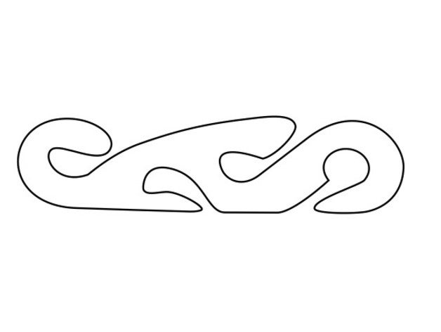

@NedMan I found these hooks that are adjustable.
adjustable hooks
Hmm…are two of those meant to be linked together?
They really do not have to be very long but I am sure you could stretch the design a bit if needed.
I was just wondering because the design seems a bit wonky for using just one as far as adjustability goes. It looks to me like it was designed to hook two together?
Edit: Nevermind I figured it out :slight_smile:

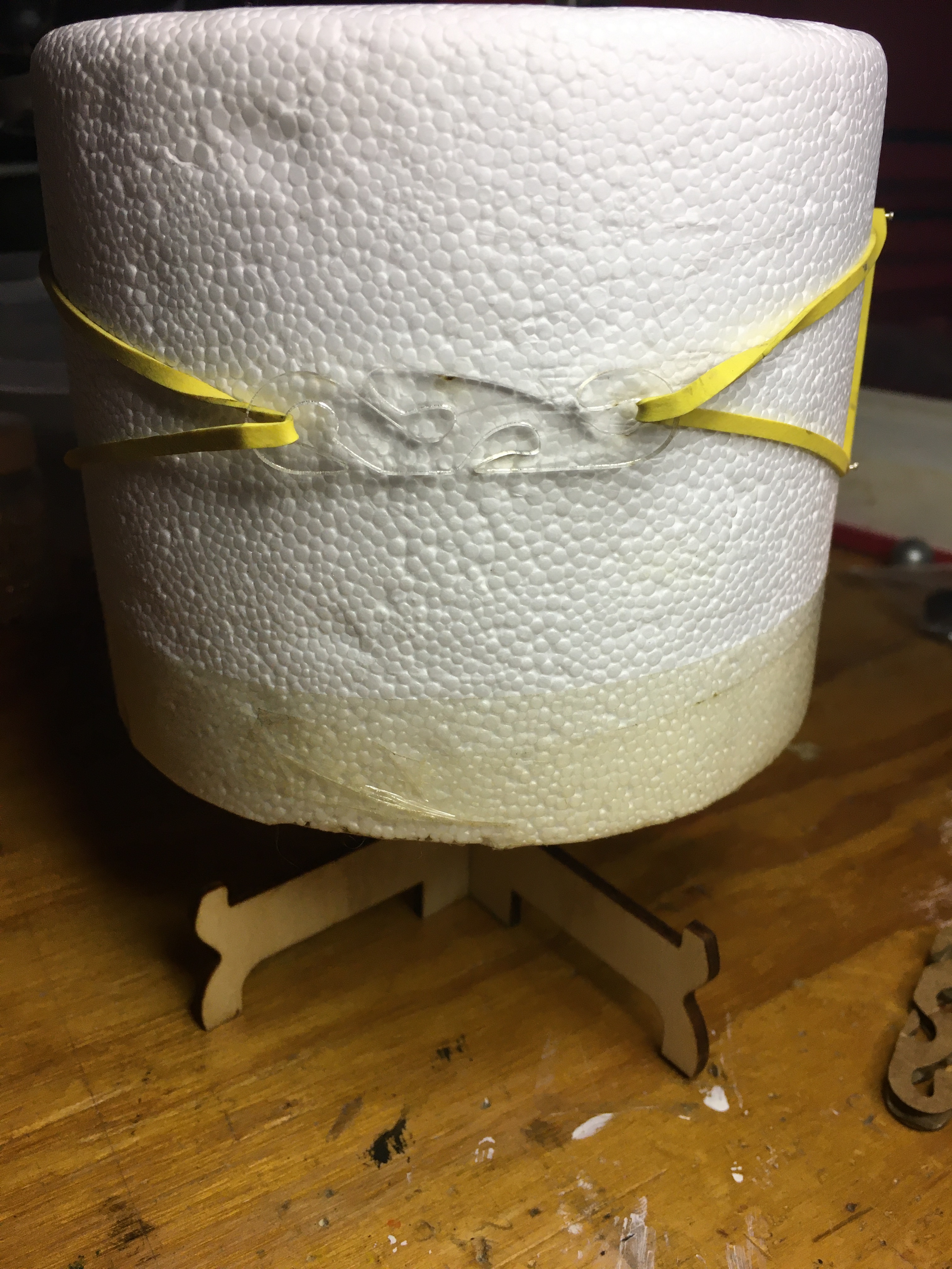

Did a mock up of the adjustable S design @HalfNormal shared to convince myself how it worked :grin: Styrofoam cylinder, straight pins, rubber bands and a cardboard cut hook. Adjusts from the left side. I guess the right side is more open to make unhooking easier while the left would probably retain easier so the hook would be harder to lose.

The narrow neck on that second hook spot was bugging me so I tweaked it.
Also here is a style with a hole for a ponytail.

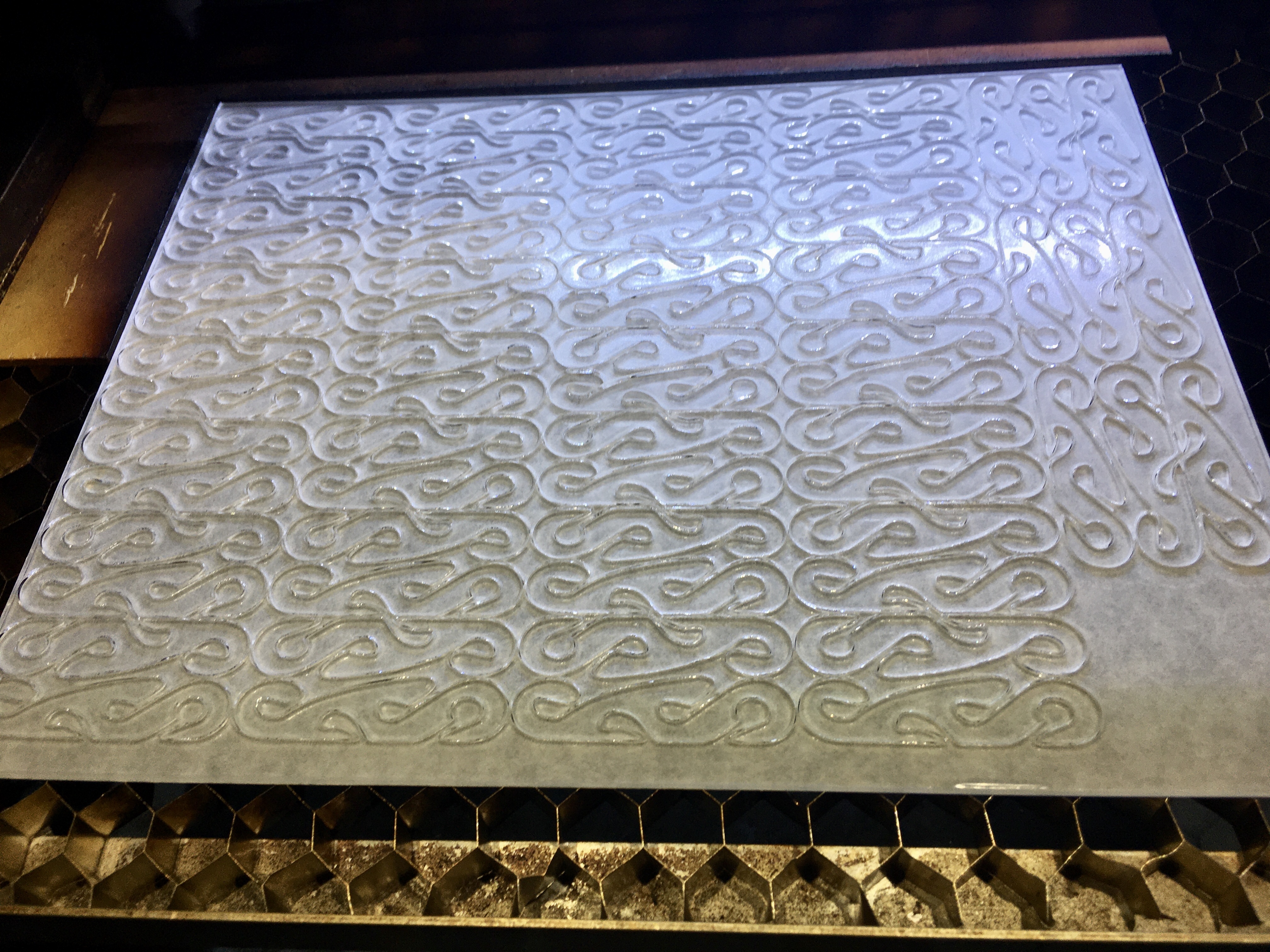

Had some 2mm cast acrylic on hand so I made one. Seems strong enough.
Cut 69 from a 8x10” piece of 2mm acrylic.
