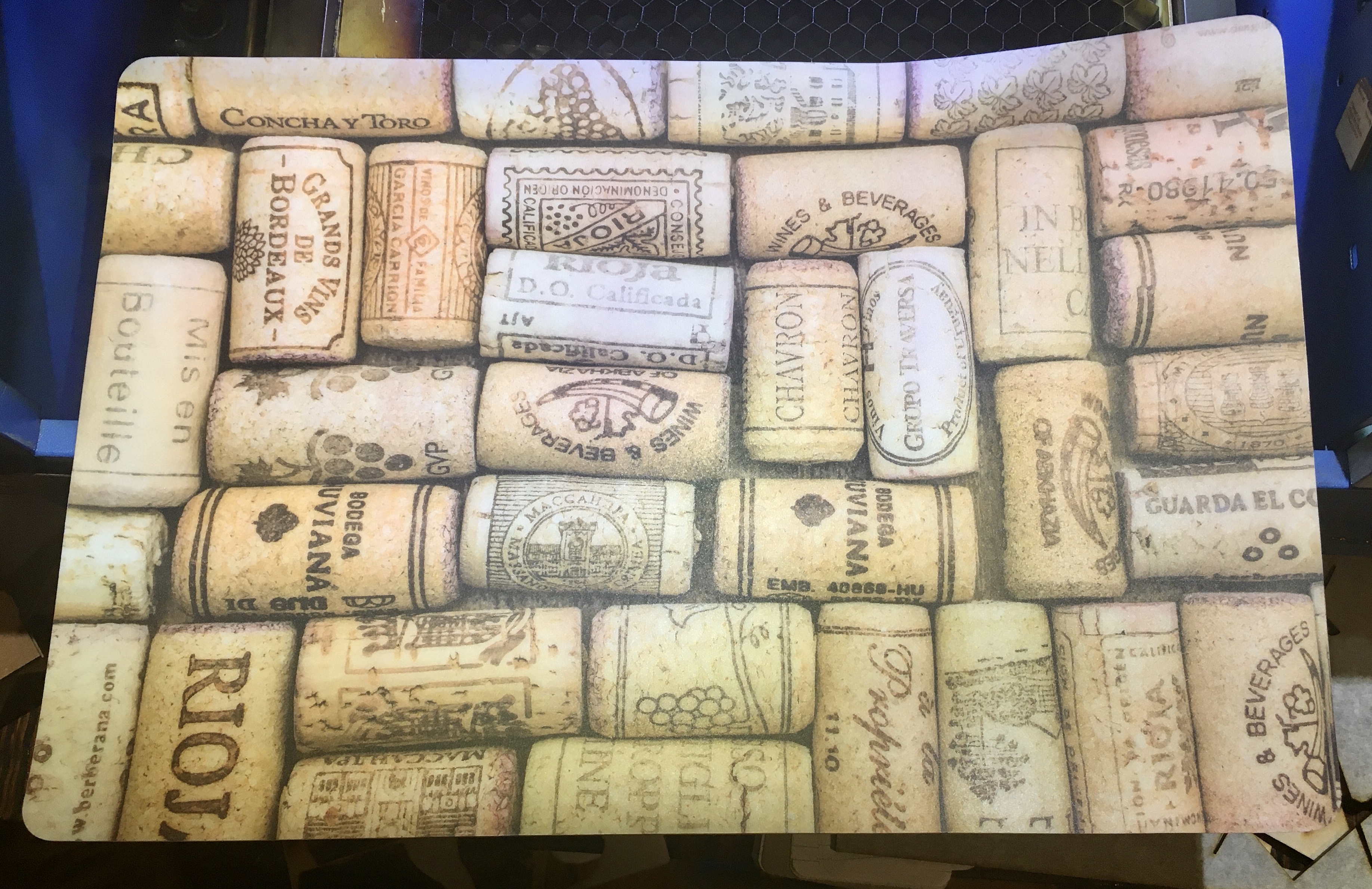

Still haven’t received the cutting mats from amazon, but I found these placemats at Walmart for $2 each.
They are made from 0.3mm polypropylene with a 1.5mm EVA foam backing. Wasn’t sure how well the foam backing would cut but turned out cutting just fine. Cut some larger ear savers. The mats are 12x18” so I can get 28 from a mat. On the K40 I cut them at 25mm/s and ~8mA power.
