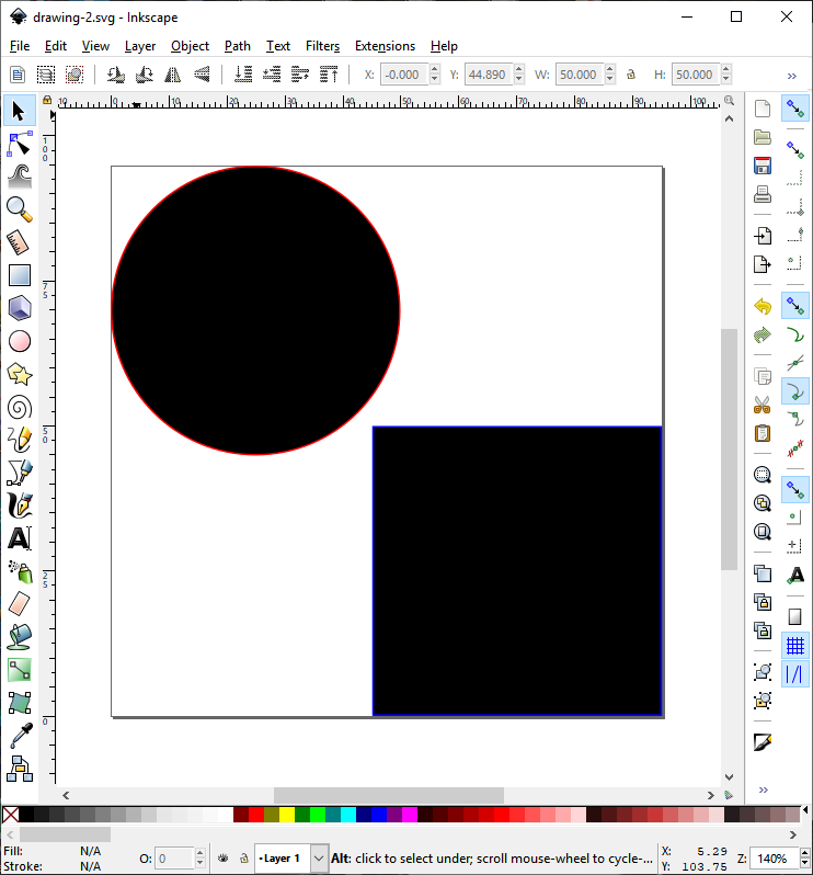

Here is a sample test file I made in Inkscape.
test_inkscape

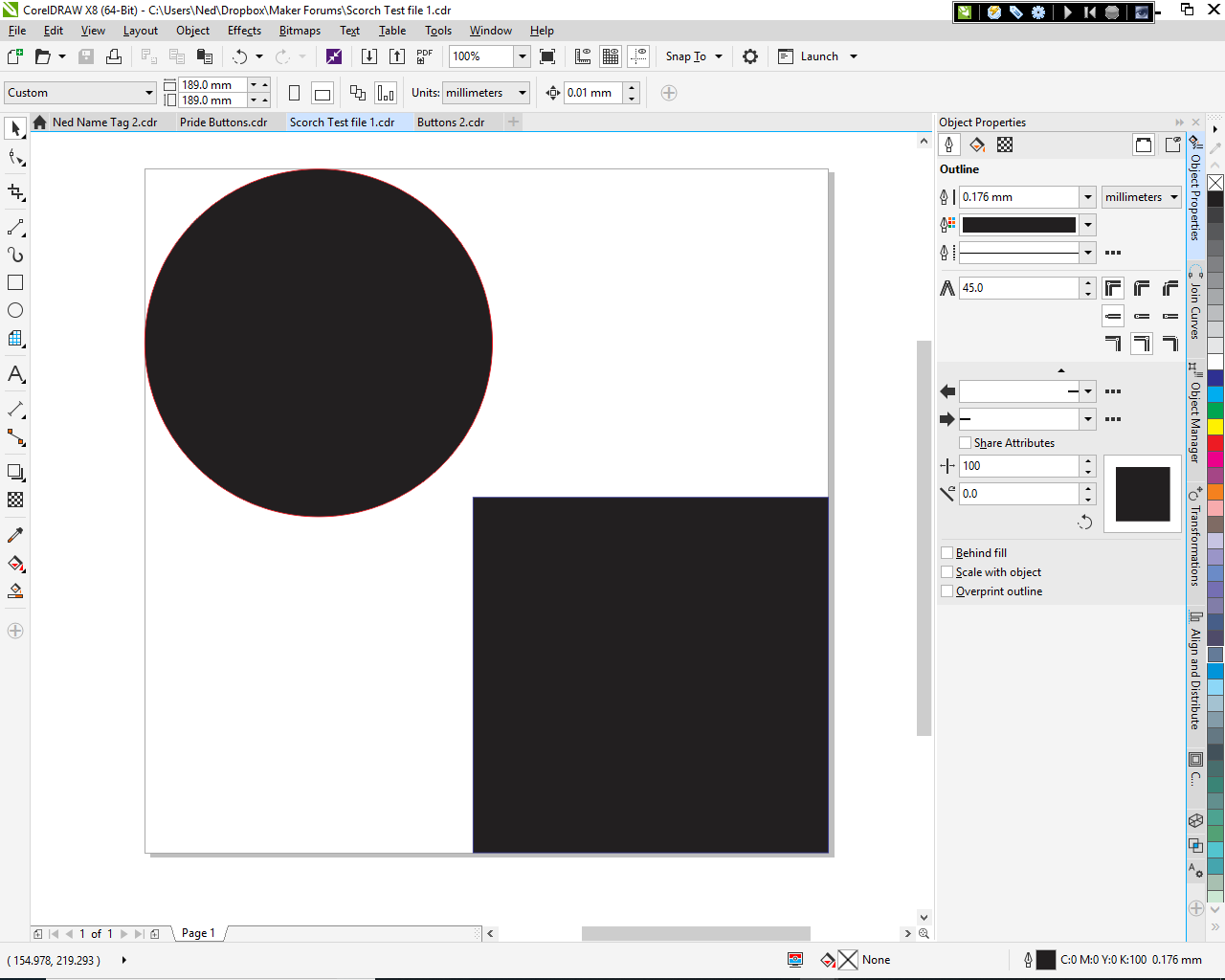

Here is the Coreldraw info using CD X8.
Here is the coreldraw file
Let me know if you need anything else in CD.
