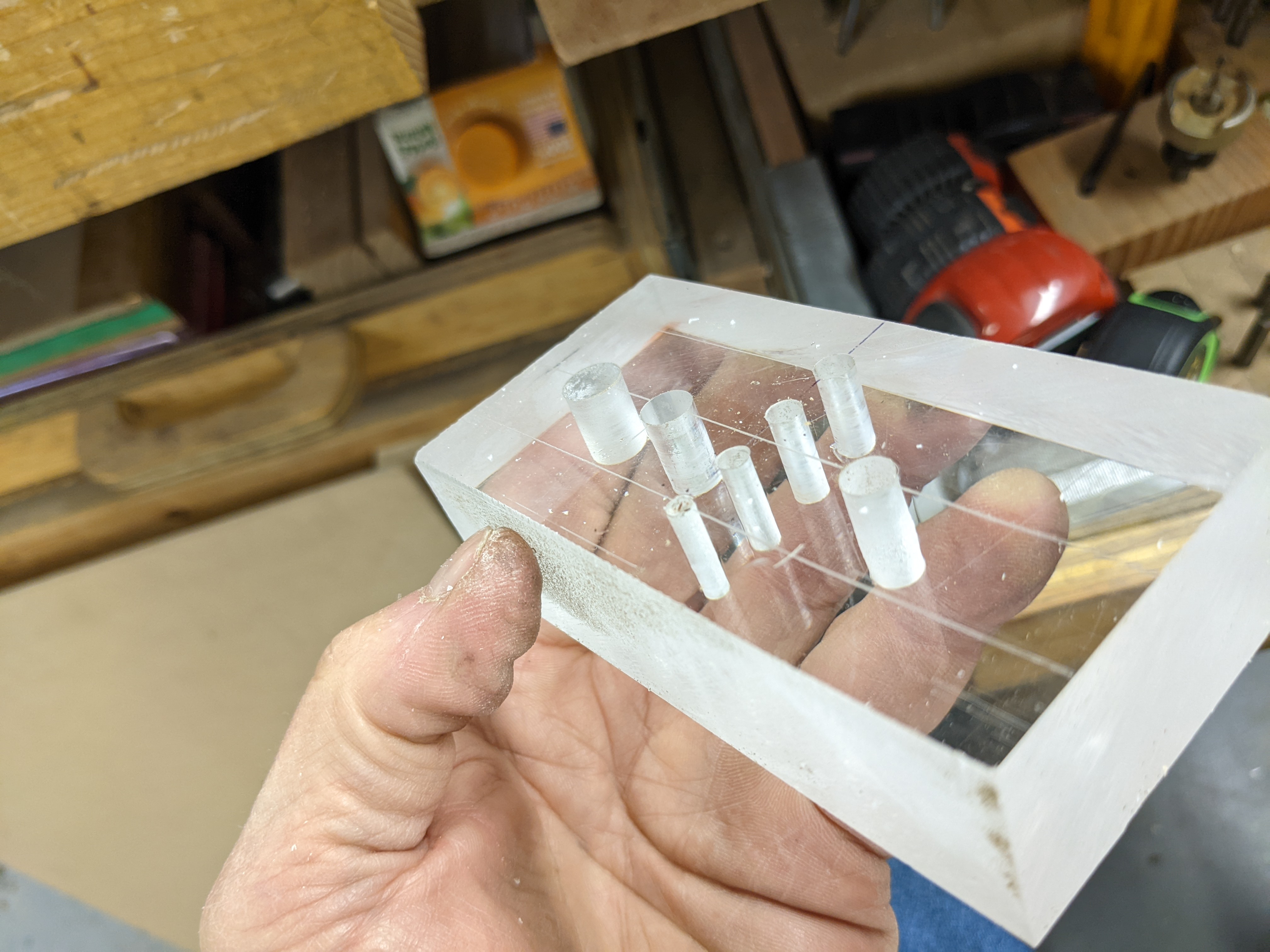

A 1" thick acrylic block with precisely drilled holes that closely fit the taps shaft (not the taps threaded section). One for each size tap I use. I chose the acrylic block because I had one in the plastics bin and I knew it was flat and would wear pretty well. I think it needs to be at least an inch thick.
After carefully matching numbered drills to my taps I proceeded to drill “straight” holes into the block using the drill press, one for each tap shaft size. Some of the smaller sizes (#4,6,8) all use the same tap shaft size. Seven holes were enough to cover my most used taps. I have room to add more if needed.
Use:
The hole to be tapped is drilled and then the acrylic block with the tap inserted in the correct size hole is layed on the surface over the hole. Press the block down on the surface then hand tap the hole as normal. It cuts like butter with much less force. No stripping in acrylic.

Yes it did. When tap starts cutting threads at an angle the force eventually causes the tap to turn but not cut stripping the threads. Especially at the entry.

The guide holes are just slightly larger than the shaft of the tap.
The shaft of many of my smaller taps are the same size. Meaning that the shaft on a #8 is the same size as a #4 tap. The lower part of the shaft is machined down to match the size of tap. This upper part of the shaft is what I size the blocks hole for.

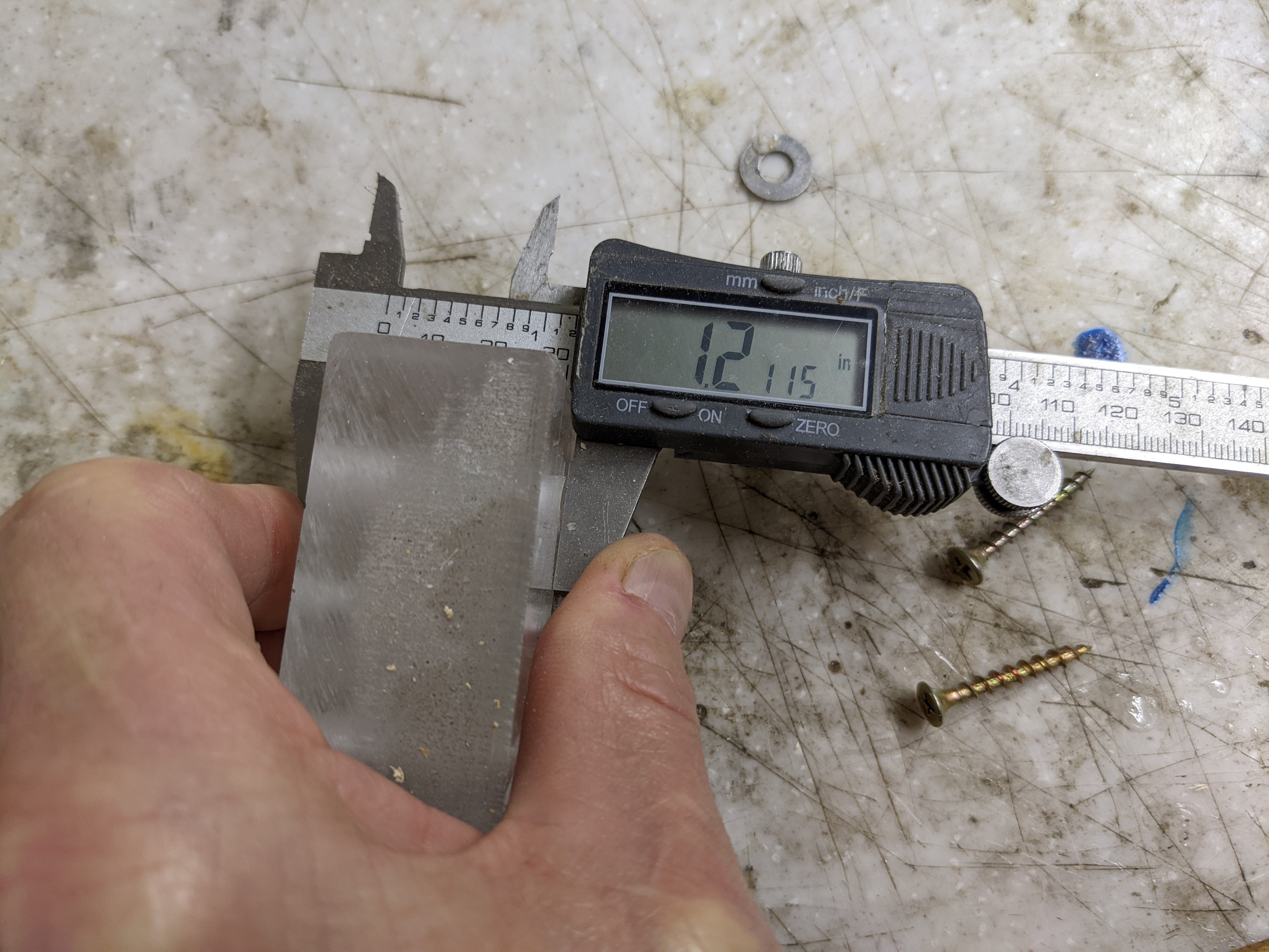

My block is 1.2" thick.
