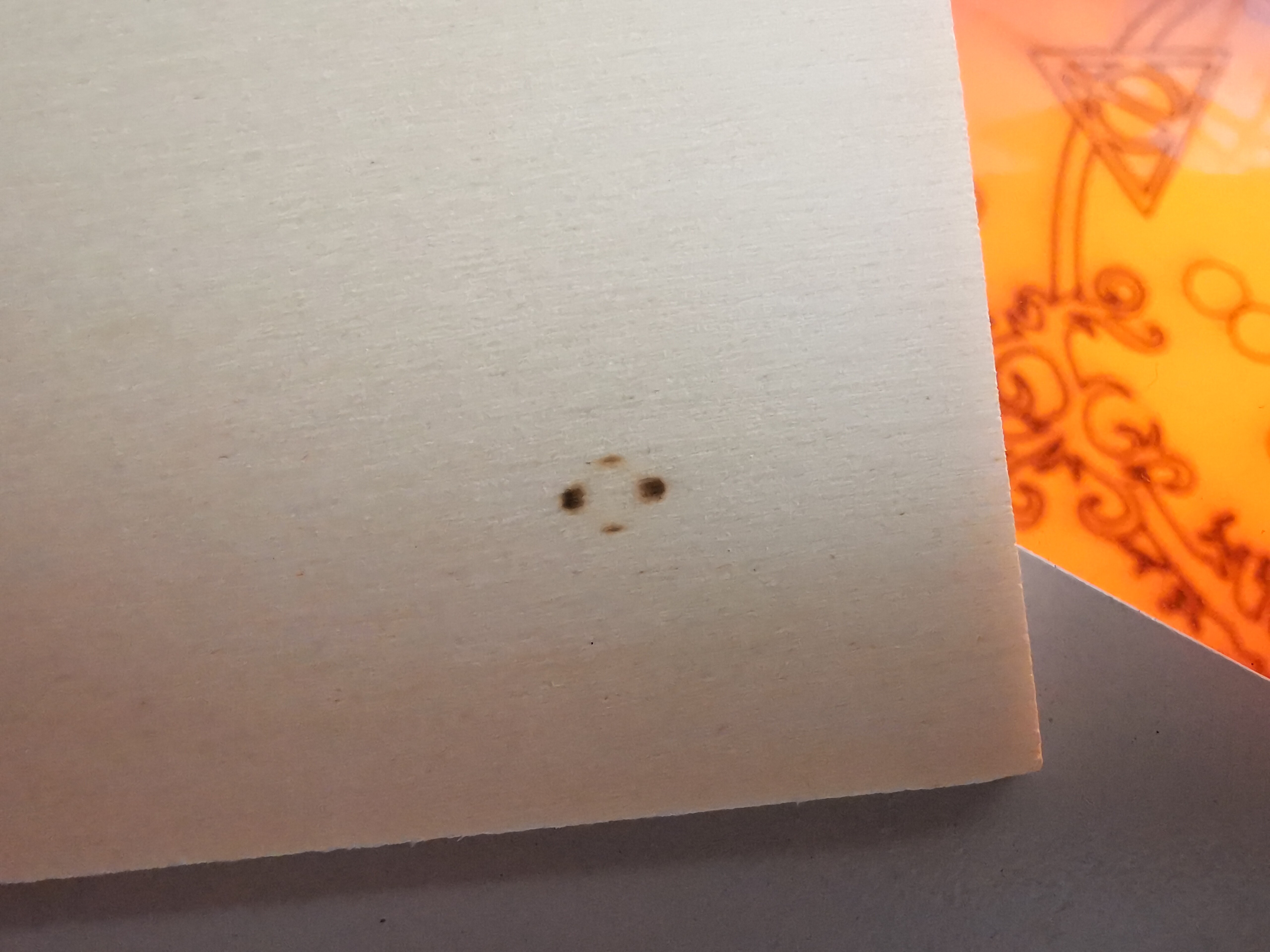

I got this image on a piece of plywood placed just in front of tube exit (in front of mirror #1
Do you confirm it’s a dead tube working in TEM01 mode ?
What could be the cause ?

Yeah, looks like the tube…
  • TEM01* is “donut mode”
  • TEM01 has two spots
  • TEM02 has four spots
I’m guessing you have some TEM01 and some TEM02 but that distinction is academic; once the tube shifts mode it is dead.

I can be one or the other or both. The output mode you have shown makes the tube the primary suspect.
A bad LPS will not usually destroy a tube or cause it to jump modes. Mostly you just get low performance.

Note that your tube is not dead as much as it has shifted modes. Mode shift is usually caused by damage from overheating which changes the physical characteristics of the tube’s optics.

From the output behavior of your tube, I would guess it is bad. Was it overheated?

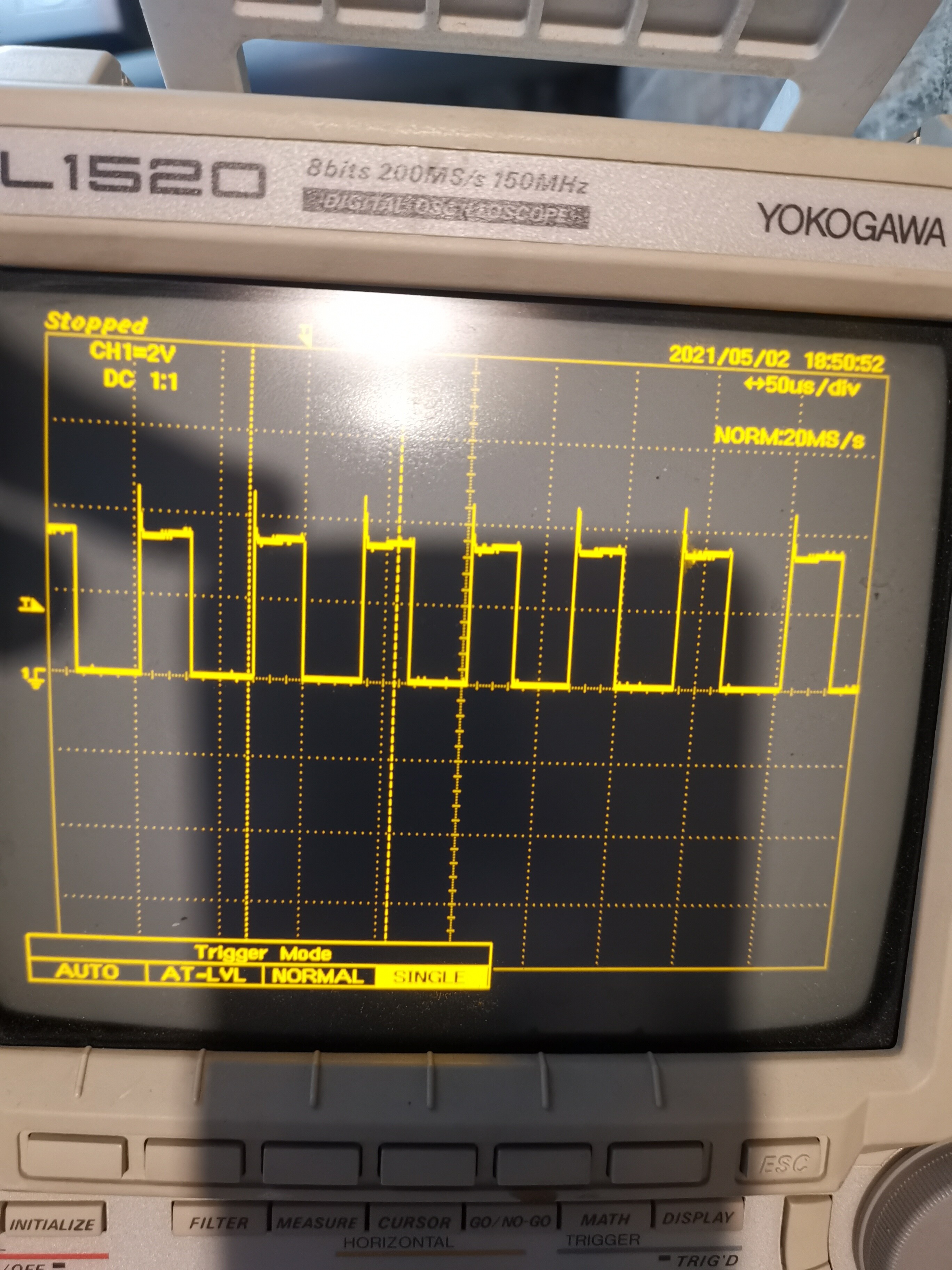

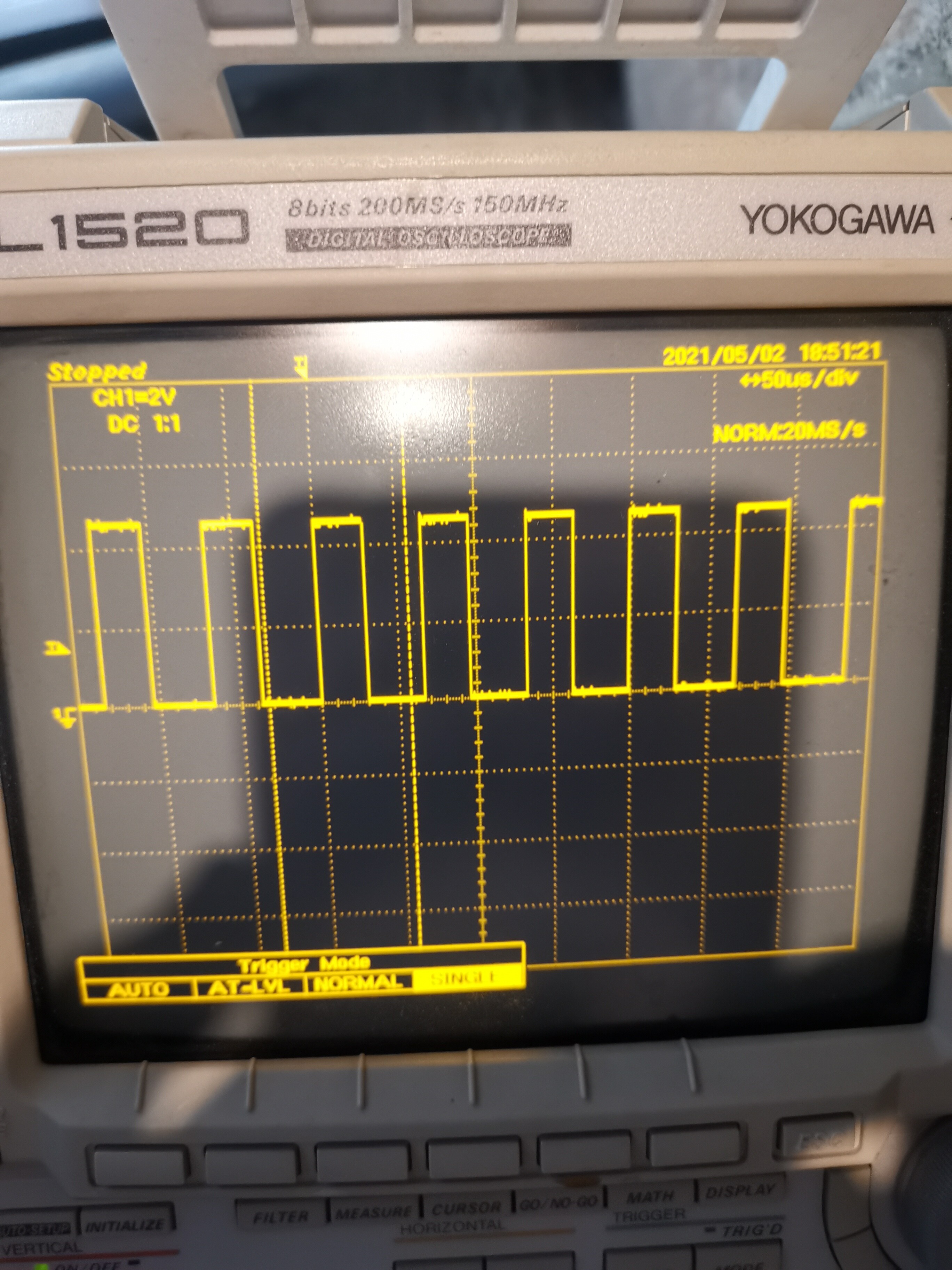

So I have checked the PWM signal with a scope.
When my shield is NOT attached to the LPS, PWM signal is perfect.
When my shield IS connected to the LPS, I can see a peak of 5V signal then 3.3V for the remaining 99% of the high state.
Assuming that the LPS is just “interpretating” an average DC value out of the PWM signal, I assume it’s not a big deal.

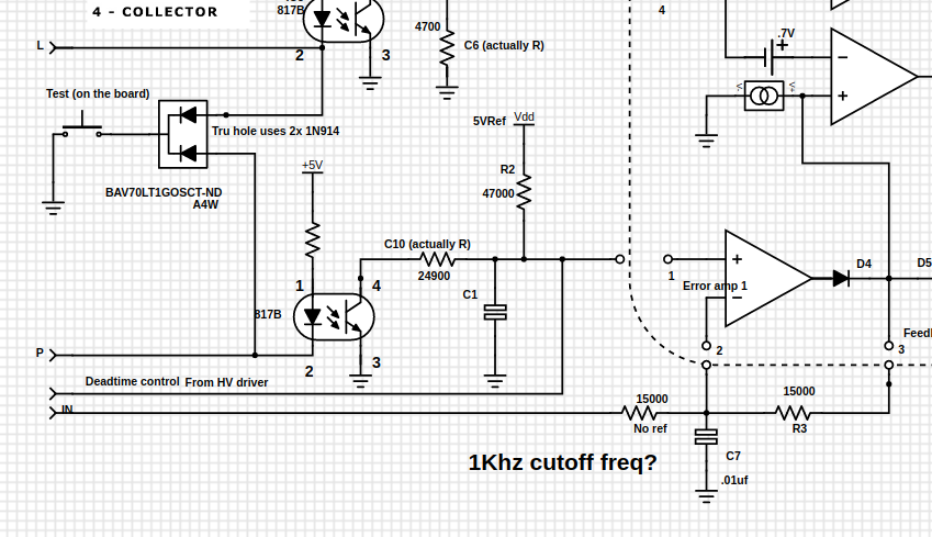

I see that @donkjr has a schematic for what looks like a PWM driver circuit at Don's Laser Cutter Things: Replacing the K40's Digital Panel with an Analog one and at Don's Laser Cutter Things: Repairing the K40 LPS #1 links to reverse-engineered schematic at https://www.digikey.com/schemeit/project/k40-lps-2-EFKO7C8303M0/ from which this image is excerpted:
If I’m reading this right, the PWM in has a current sink within the TL494 PWM driver (I don’t know how much current) which would make sense for your logic level shifter not not actually providing 5V at whatever current it is drawing.

That shows the loaded and unloaded state of the driver. Those drivers are not really intended to drive much load.
The simple answer is that that signal is filtered at the input to the control amp which creates a voltage (integrator) that controls the LPS internal PWM. If you have calibrated your ESP PWM for power then you should be ok.
That said, I think driving the L pin with an open drain driver is an easier approach and it leaves the opportunity to add a pot to IN for local control. There is an extensive explanation on my blog why I chose this approach. Adding this driver to a esp32 is not such a big deal.
