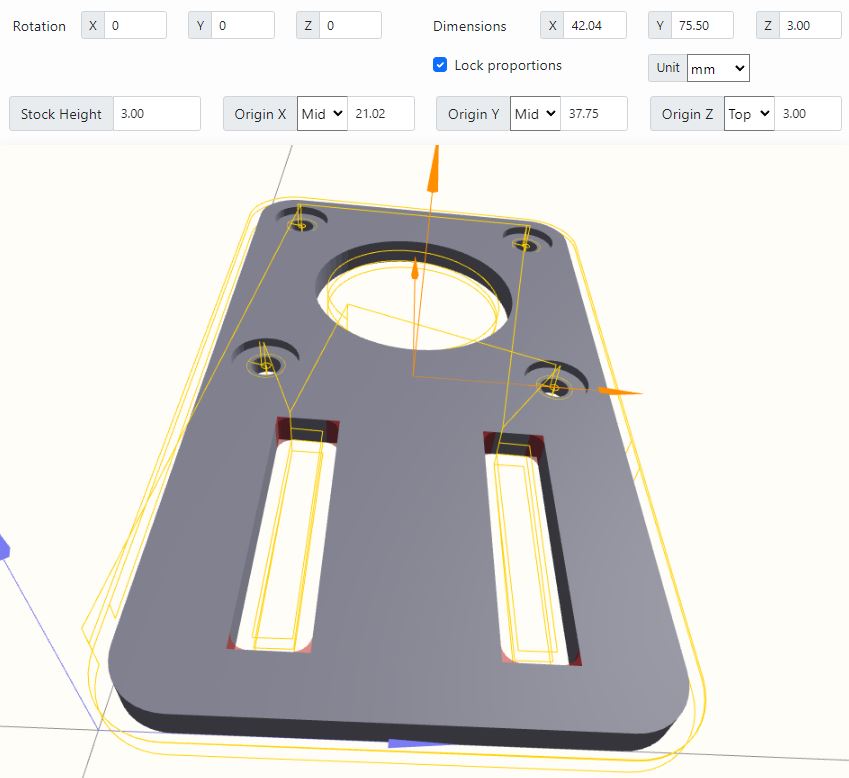

Hello,
I created at www.temujin.ai/CAM a tool that allows you to drag and drop a stl file (2.5D) or dxf/svg files, tweak a couple setting and that will generate all the toolpaths for you. It is the equivalent in term of simplicity to a 3d printer slicer.
It is free to use and requires no registration. Your CAM step should now take less than a minute and not throw you into a wall of settings. I hope this can bring more people into the craft.
Looking forward to your feedbacks and enjoy this tool!
