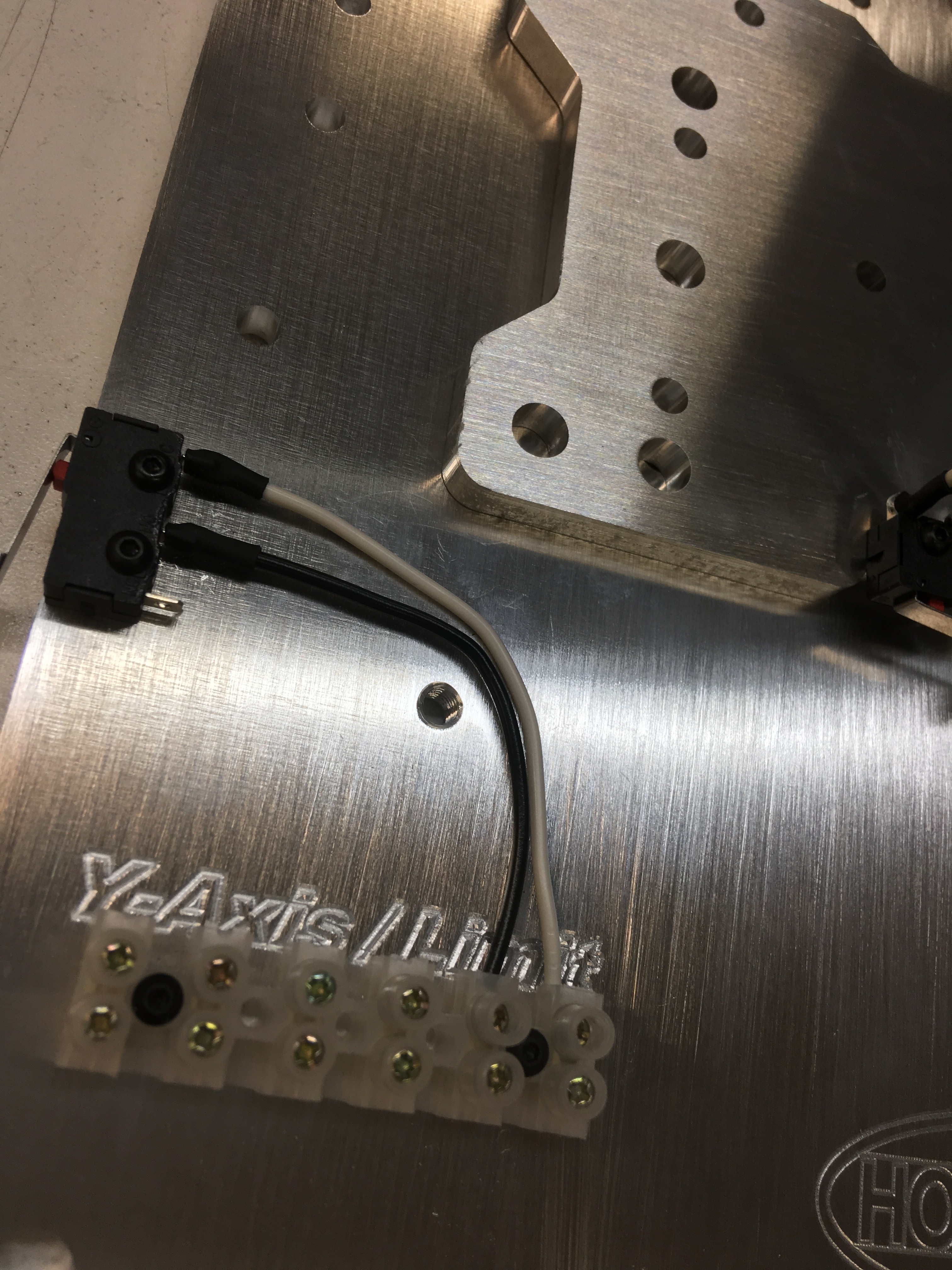

@Brandon_Satterfield I like what you did here. Do you have any online documentation for the full implementation such as with the limit switches? I bought limit switches but wasn’t sure exactly how I should install them on the hardware. I would love to see pics of your full setup there.

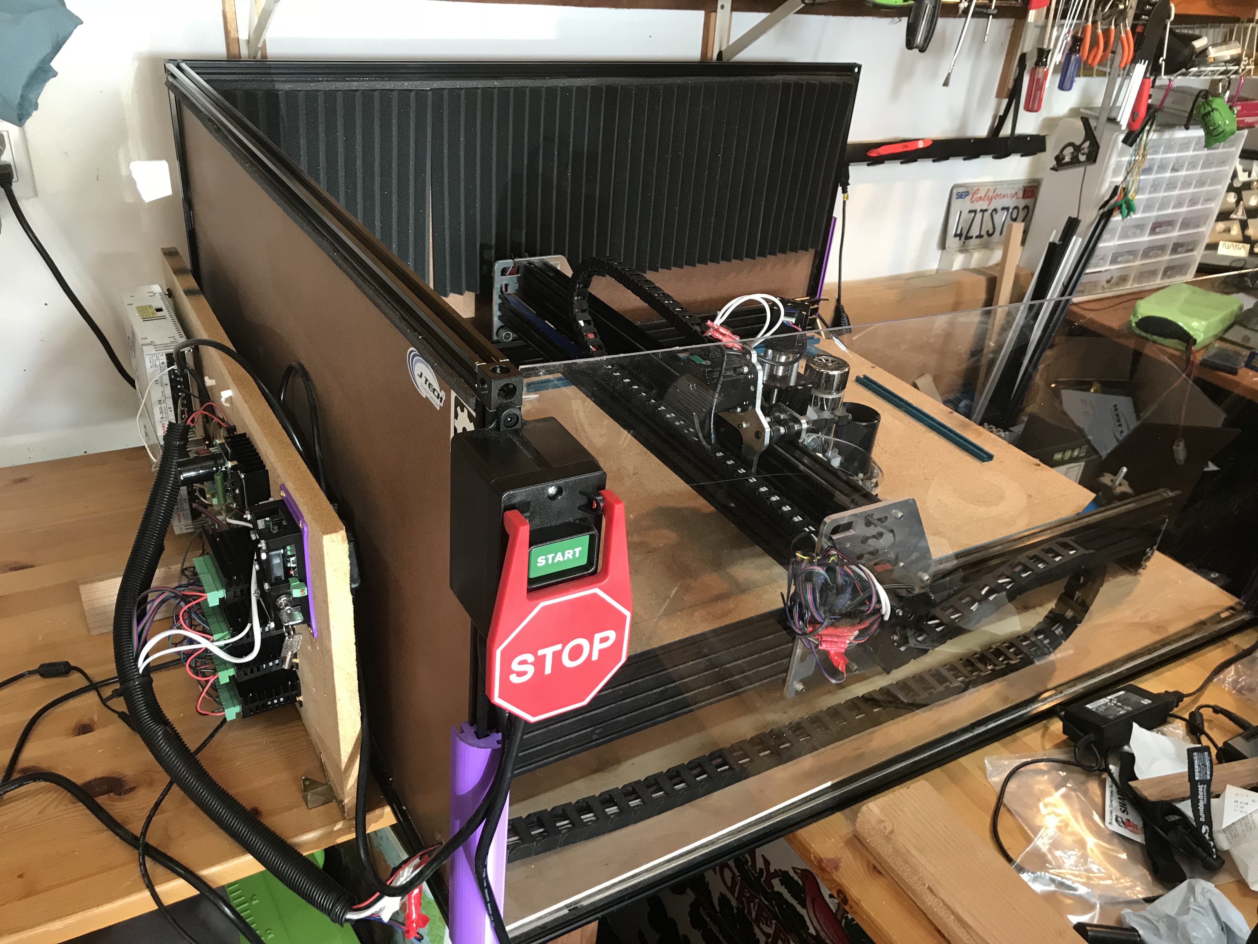

@Michael_Forte what controller are you using?
I’m using a Smoothieboard. In this picture you can sort of see how my electronics are mounted outside my enclosure and the wiring is fed into the bottom corner which connects to the y-axis cable chain. I cut all of the wires at the point between the two cable chains and used quick disconnect connectors so I could troubleshoot easier in the future. As you can see, it’s a little bundle of cables there. Your implementation is much cleaner and you still have an easy wat to disconnect the wires; probably even easier.

@Michael_Forte no real documentation, happy to share the DXFs if you like. They will be on the http://www.hobby-fab.com website soon (sorry gotta use full link as the site is still too new, but you know that :-)) … just followed the link and saw the mobile view is crap. Tomorrow’s list.
We mount the limits with M2.5x16 screws. Use a 2.1mm drill bit and a M2.5 tap, they are very easy to mount. All switches wires NO. Homes to top Z, rear Y, right X looking at the machine.
On the Ox we use a bolt, tee-nut and spacer as a stop “pin” for the limits. I would have to look at the manual to see what size bolt and spacer. If you mount the limits by hand just ensure that your lever is in-line with one of the slots in the aluminum. The pin will act as the stop.
Besides that just running wires. Happy to assist in anyway, just holler.

@Brandon_Satterfield Thanks for the description. I’m still trying to picture what those switches are hitting up against to close. Did you add some extra pieces on the frame?
@Michael_Forte yes sir.
Pg 32.
https://drive.google.com/file/d/1AC1wCaBBAoov-0grtbrS7lYVl2hK0r4O/view
FWIW, I found for the plates and switches I have, I needed to use M2.5x12 screws instead.
