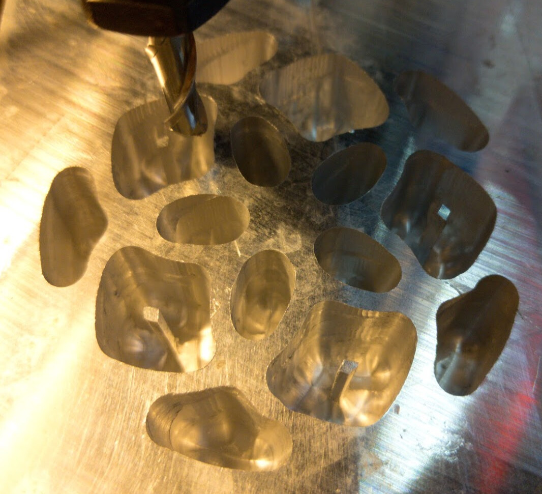

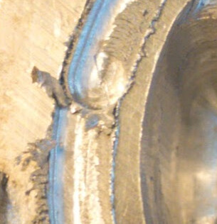

Required new gcode for ball-end mills. Put the 6mm ball mill in and started it going. Seemed to be working fine. But suddenly it made noise and wasn’t following the edges properly. Hit the e-stop. Candle showed it in the second cut but the mill was in the first.
Careful investigation showed that my new diaphragm Z coupling was slipping on the lead screw. In retrospect, I’ll bet this is what happened that shattered the first bit. This time the bit was OK, other than some BUE that was a pain to remove. Ended up sliding a razor blade behind the aluminum (not against the cutting edge of the mill) to pop it off.

Here’s the start of my first test cut:
By contrast, here’s the cut where the bit was stuck in the hole due to slipping Z:
There’s still a bit of noise; 19mm plate requires a mill with plenty of cutting length, so it’s a bit flexible and sometimes sings a bit, but not too bad. And the edges look clean.

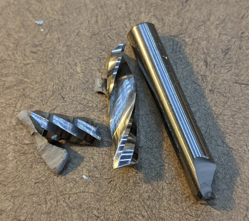

These cheap 4mm end mills don’t come with any specs and I’m cutting mystery metal so it’s all trial and error. 0.6mm DOC and 1200mm/min filled the flutes with BUE and snapped the mill.
Here’s where it broke:
Look at all that BUE clogging the tip!
