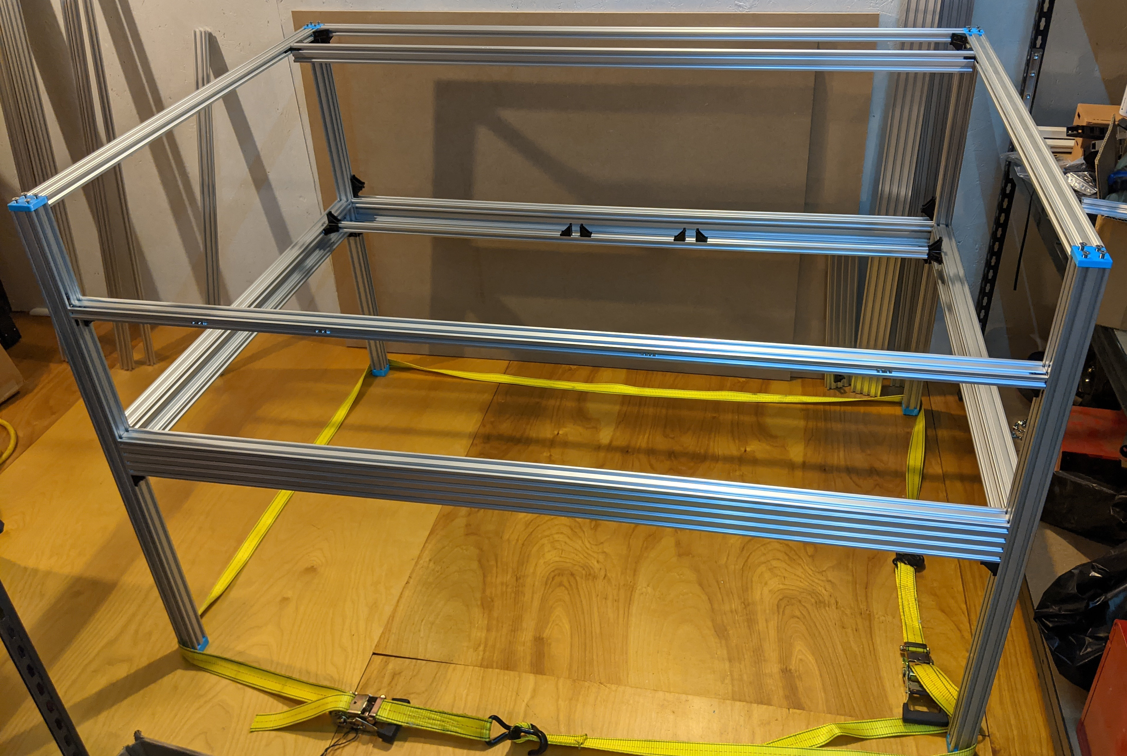

Here it is with a tensioning strap I used to hold it together tightly while fastening the middle c-beam:
I had the 1.5 meter c-beam sitting around. In retrospect it wasn’t a bad idea to add that stiffness but if I were doing it again from scratch it would make more sense to use 2060 and add stiffness when I bolted a panel underneath.

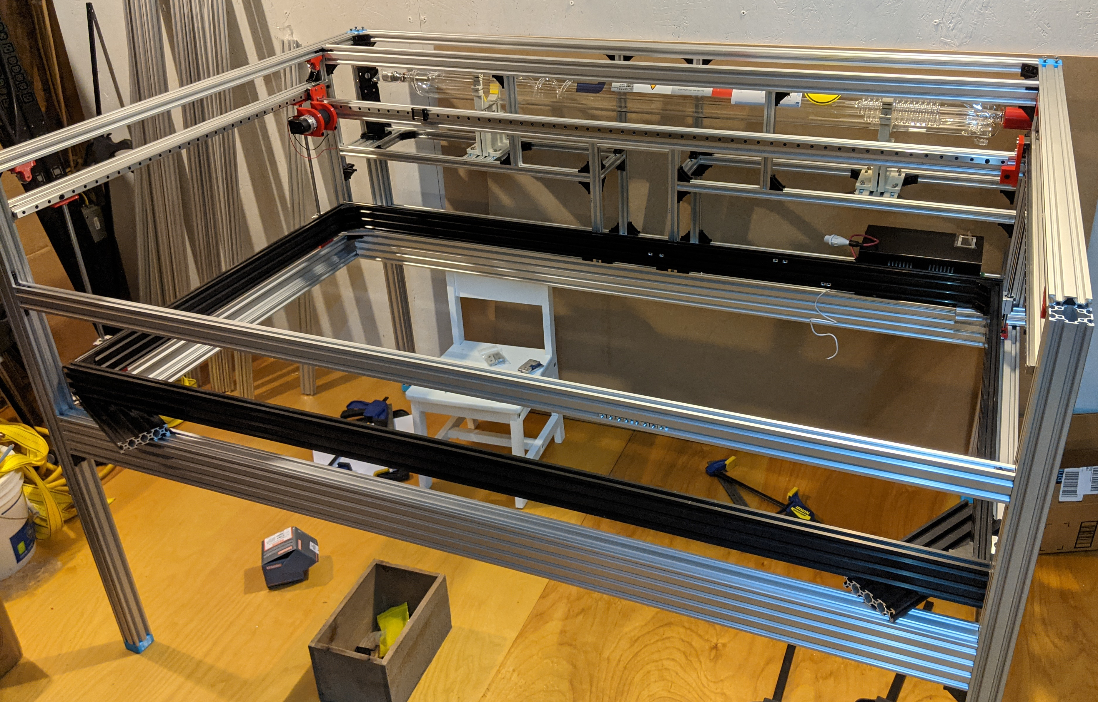

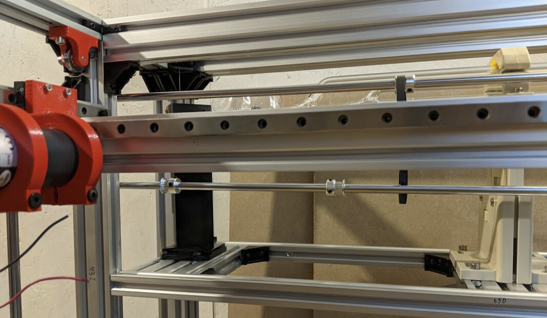

I have the X and Y rails in place, including the linear rail, and the X servomotor to drive it. I also have the outer bed frame assembled though not yet suspended.
I haven’t tested yet whether this location for the servomotor leaves enough room for me to mount the second mirror, though I should do that soon.
I now have the Z lift rod at the top rather than the bottom, and the Y rod and belt are below the Y rail instead of above as in the original plan. I’m still playing around with location. I’m currently planning to wind the Z line directly around the rod, and to make clamps to hold the line to the rod. I’m milling something from aluminum for now but I’m not sure that’s the best plan.
Both rods are sufficiently far from the laser plane.
