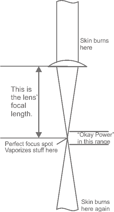

From K40 initial setup and regular maintenance - Getting Started with CO2 Lasers - Maker Forums please see this graphic:

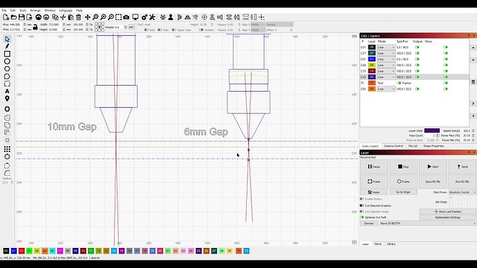

The typical lens in a K40 is a 50mm lens; that is, it’s 50mm from the bottom of the lens to the focal point. The beam is a few mm wide when it enters the lens. Note that most of the height between the lens and the focus point is hidden inside the nozzle. Therefore, if you were cutting 40mm perspex, the beam when it exited the perspex would be almost as wide as before the lens focuses it. The cut would have a substantial angle, except that as it widens it loses effective power so that substantial angle wouldn’t actually show up for 40mm of depth.
@HalfNormal recently linked to a very useful resource on understanding focal depth in a laser:
Ultimately, I would not expect 40mm perspex to be a success. (I wouldn’t expect it to be a success on the 100W laser I’m building even with a 4" lens.)

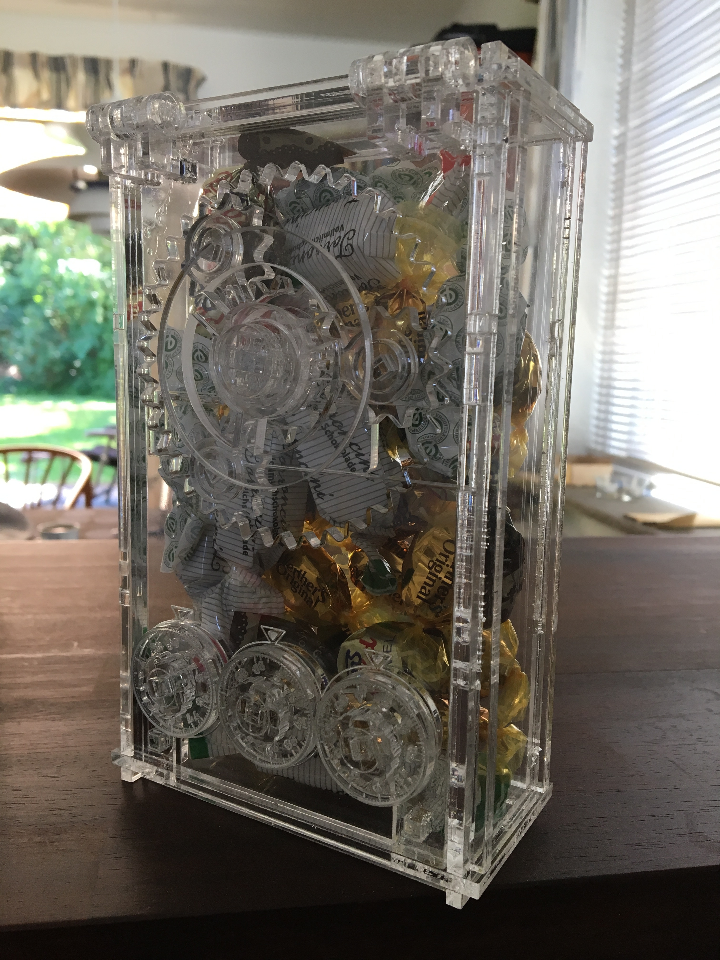

… ahhh, that makes the task much easier to work with ;-). In these corona times, I have made quite a few stands for screens for public institutions and offices. I have made them in 6 mm, it also takes some time with a K40 but I have received a lot of praise for the finished product.
Ackyl is a fantastic material for testing and fine-tuning the laser. And of course also to play with.
This is a safe with candy and chocolate I made as a gift for a very candy-sick friend. If I remember correctly it is made of 4 mm and there are 3 working number locks and a large gear for decoration.

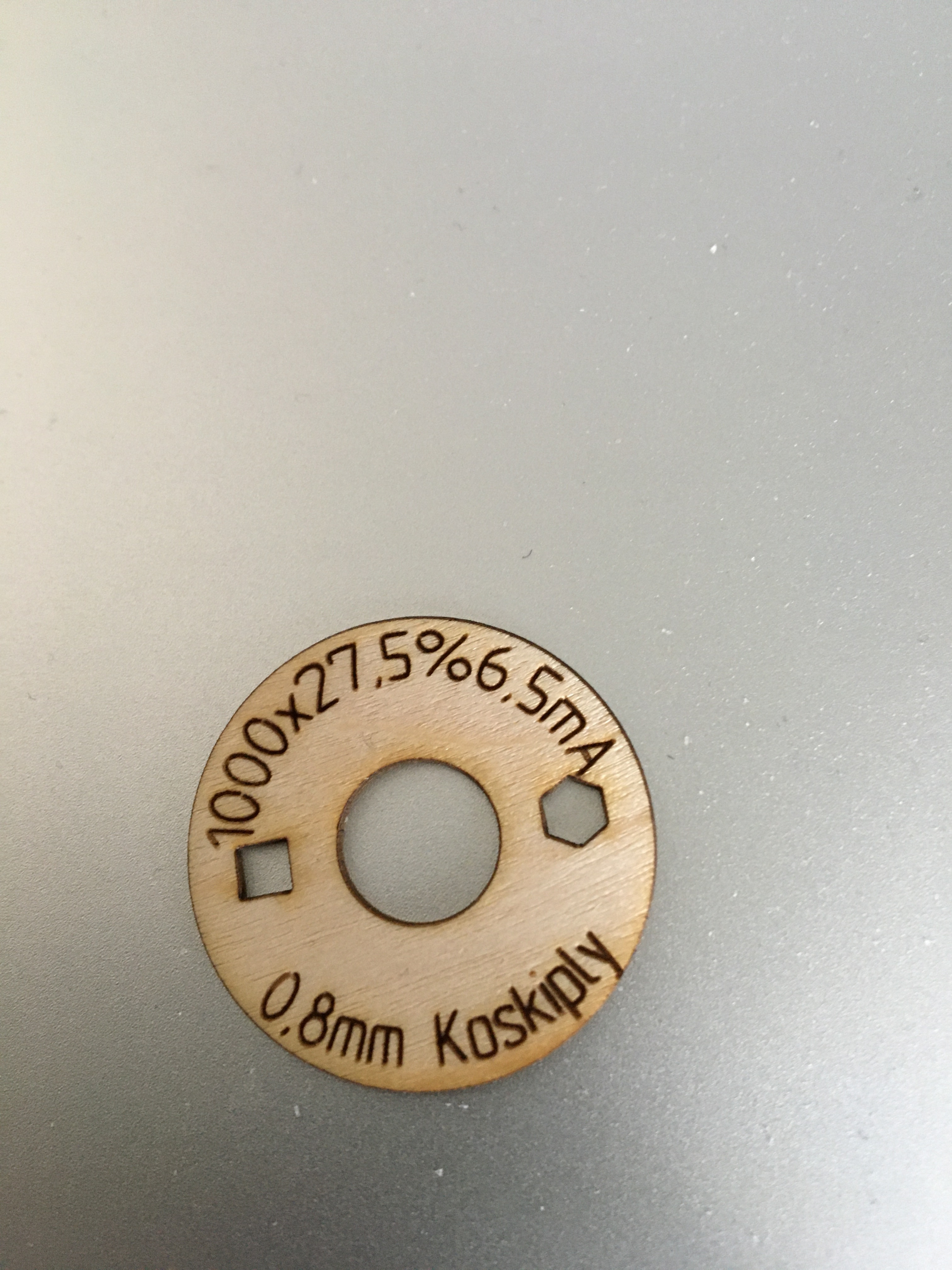

I would suggest you do a test run on some material scraps to find the precise focus point of your laser and then insert the focus point 2mm into your 4mm acrylic. This is important because then you can cut properly through the material and to keep the cut as straight as possible. By experimenting, you will find a power / speed combination that best suits your machine. Unfortunately, you can not just take over some finished values from other K40 users, there are no two lasers that are identical. But you can use, for example, my values to start from. Once I have found the right values that are reproducible, I make a test item and hang it on my test wall. It’s nice to just be able to see what it looked like and you can also keep an eye on your laser tube and find out when the tube is about to retire.
Picture no.2 is my updated version of my test subjects, with mA
I forgot to write that speed is in mm / min and the% values are from laser software - LightBurn, which corresponds to the specified mA, I have made a list of these values which I keep an eye on.
