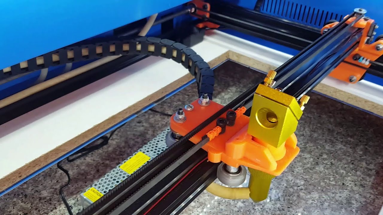

This guy mods: Franken40
Interesting mods by a guy I found on YT. Anyone have any thoughts on his work?
That’s @Bill-CNC’s work: (K40 Laser Cut Area Enlargement) High voltage wire and Flyback :slight_smile:
@Bill-CNC, I’m particularly interested in learning about the belt splicing jig you made. I expect to be splicing a belt for the Z lift on my laser relatively soon. I can’t seem to easily buy a ~2400–2500 tooth gt2 closed loop belt which leaves me with DIY as the most obvious answer.
I do not care for:
  • remoting the LPS without a metal enclosure on the HV wiring.
  • having a laser controller in a remote box without interlocks on covers
But that is just me …
