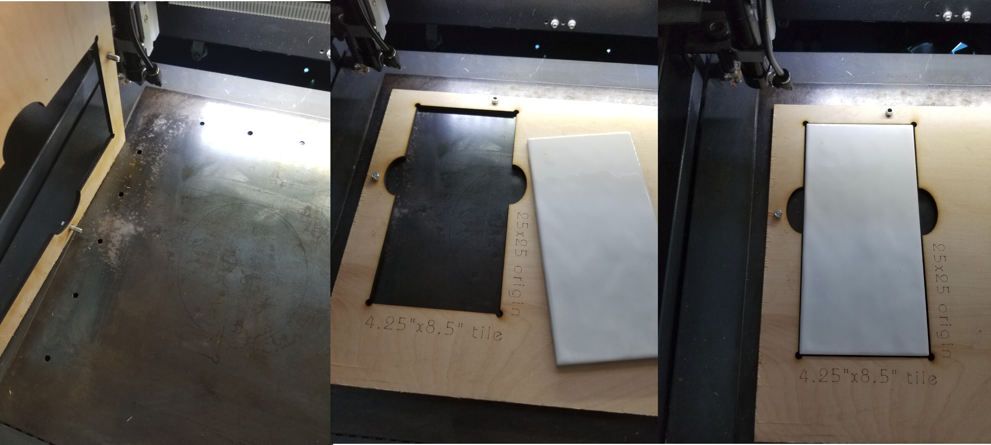

I have a 50W co2 with a steel floor with alignment holes…
Here are a couple of photos to give you an idea…
Good luck
