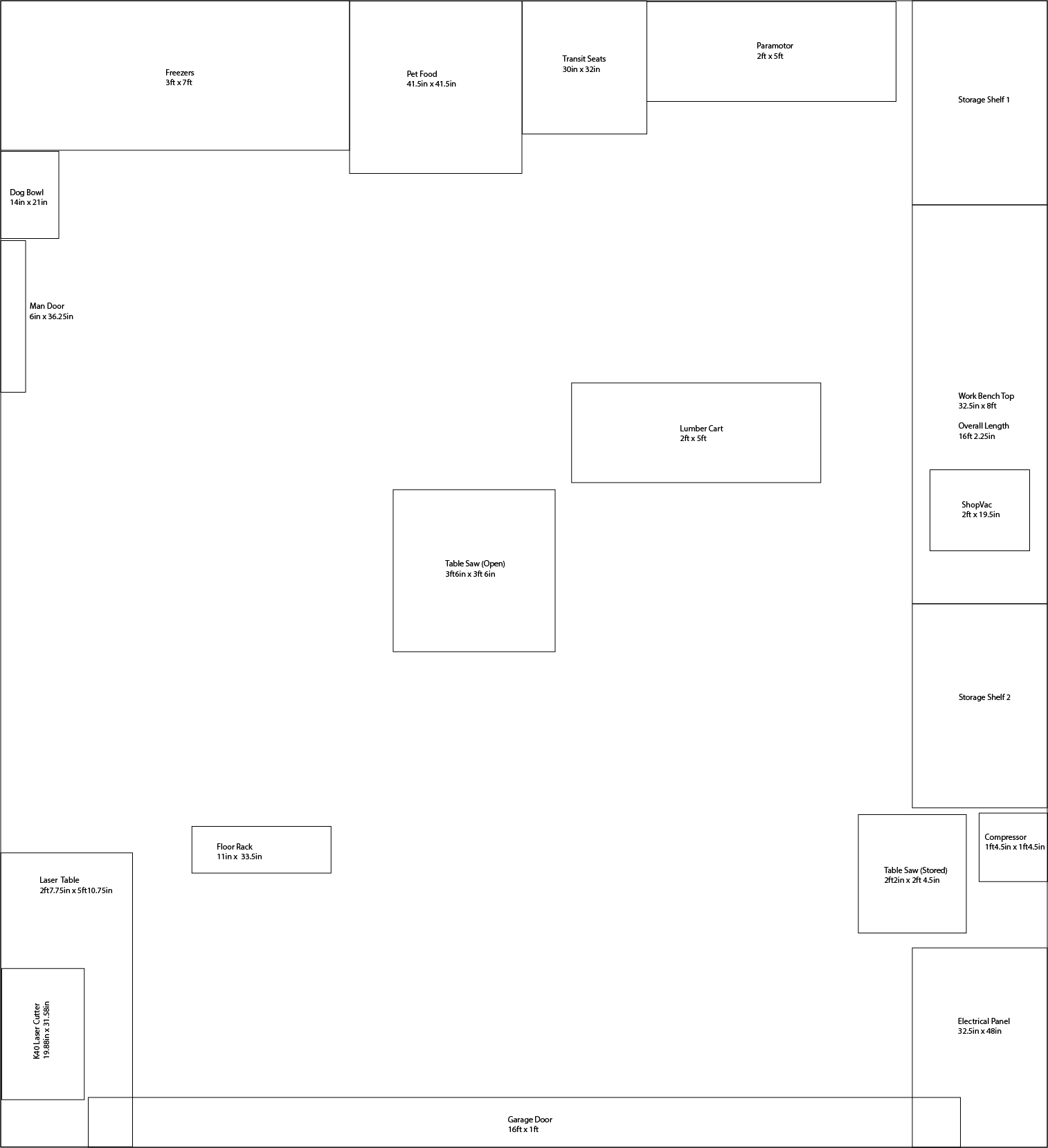

Excellent information from all! I believe that I am going to keep my K40 on a table that is in the corner of my garage. This means that I can vent it through the adjacent exterior wall. So, distance from vent to wall (not including routing and all) might be as little as two to three feet.
This is the general layout of my garage. I just built the workbench and the storage shelves. I have 120V throughout the garage and one 125/250V 50A plug.
I know it is a mess, but this is my makerspace under construction
