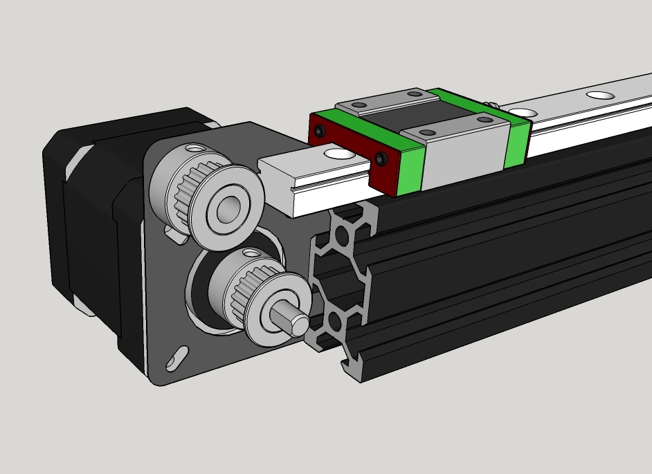

Yeah, i was looking at openbuilds first, but with their parts i calculated a 180mm loss on X and Y, each, only for the drive motors.
So i made my own system, taking up only 60mm which gives me 120mm more X and Y movement the laser actually can reach on the same footprint :slight_smile:
The upgrade project is filmed so it´s at least 90% documented :slight_smile:
Very very early prototype of the belt and pulley setup.

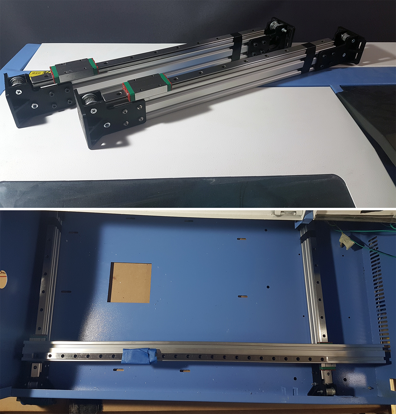

First part of the project, nothing fun yet, just the tear down of the original gantry. But keep a eye out for next chapter before the weekend, i´ll try to remember to update here too :slight_smile:
very nice indeed - have you got the MGN slider specs handy?
Y is MGN12 with MGN12H block, 600mm long
X is MGN15 with MGN15H blocks, 400mm long
My K40D can probably fit 700mm sliders for Y, but not sure yet what mine will be in the end, as i´m hiding a small electronic compartment to the right for the controller board.
Following
Getting closer, first prototype-parts done and ready to be installed.
Time for X-gantry now :slight_smile:
Final bed size will be 600x390 usable space for the beam to reach, actual bed will be slightly bigger :slight_smile:
