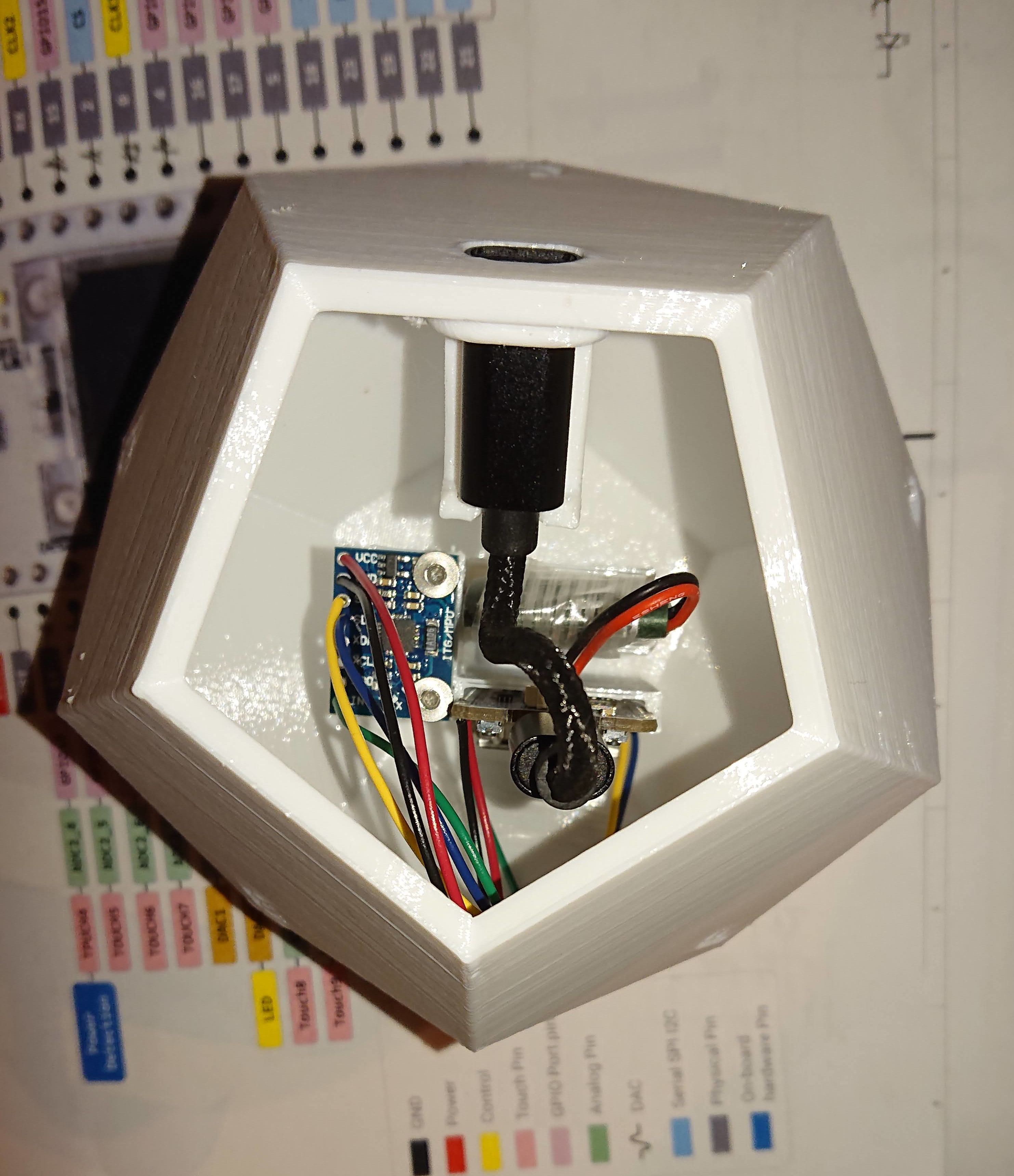

Perhaps rashly, I said that sounded easy enough. 3D print a hollow-shell dodecahedron with a removable lid, put an accelerometer, single-board computer with WiFi, charge controller, battery, and inductive charging pad inside, a few lines of code, and hey presto the project is done, right? Right?

  • The inductive charging pad I bought didn’t work. This was a blessing in disguise because making it fit would have made the device too big to comfortably fit in the hand, and the seller promptly and apologetically refunded for the broken device, so no hard feelings. This allowed me to go from 60mm long edges to 40mm long edges, so now it’s comfortable to pick up. It wouldn’t have been comfortable with edges half again as long.
  • I bought a USB-C to micro-usb adapter cable and made a slot in the side to hold it (the end is the black oval slot in the picture above), but didn’t think about having any features inside to keep it from being pushed through the shell. (The cable I bought stuck in the SBC, but none of the reviews mention this as a problem, so I think it’s a unique sample error, and honestly in this case it’s almost a feature instead of a bug, because once the case is snappped together it’s hard to get apart, and if it fell out of the SBC it would be very inconvenient.) I added a catch in the second revision that I haven’t printed yet.
  • My first try at the design had a really stupid way of trying to hold the battery and SBC in place with angled surfaces and VFB tape.That was crazy, I discovered when I printed it. Hopefully the second try, with slots to insert them into, will work better, because it’s about 200g of PETG for a single print.
  • Documentation on the Heltec ESP SBC I bought is scarce and conflicting; they redesigned the board without changing part number or public schematics, and it took experimenting to figure things out. Some things never worked, like measuring input voltage to know whether it is currently charging. A lot of of their sample code didn’t work out of the box.
  • Between Heltec not having a lot of documentation I could find and Invensense having removed half the functionality advertised for the MPU, I never did get motion interrupts working, so I’m just waking up every 10 seconds to find out whether “down” is a new direction. This uses more battery than I hoped.
  • The 1000mAh LiPo cell I bought has low-voltage protection that cuts off at 2.75V, low for maintaining long cycle life. Because of that, I’m turning off the timer and going into the deepest sleep I can at 3.5V to try to keep from going below 3V, and the spreadsheet turns yellow at 3.7V and red at 3.6V as a signal to plug in ASAP.
  • I can’t figure out how to shut down as deeply as I’d like; I’m still using 15 mA in deep sleep right now. Should be lower when I remove the LED from the MPU breakout board, but not by much. Right now it looks like it will need to be recharged about once every three days at most.

If you want to track time too, you can. Arduino sketch, BOM with amazon links, and Solidworks, STEP, parasolid, and STL files for the shell. Probably you can make something work. (But you might want to check back in a few days before you print the shell, because I haven’t yet printed my latest design iteration; the picture above is of the first iteration, and there’s a possibility I’ll have to tweak the design if it doesn’t fit when I print the second iteration.)
I printed the new version of the shell. The CPU board is a perfect fit in the slot. I used 3M fiberglass-reinforced strapping tape to tape the battery in place, and the only problem is that it sticks so well to the PETG that I had trouble maneuvering the tape into place to hold the battery. It kept sticking too well before I even got it in the right place, and I went through several strips of tape before I got it right. I ended up using philately tweezers to position the tape. (They are the only remnant of a hobby I tried for a few weeks in grade school before coming to my senses, but they keep coming in handy for other purposes.)
The feature to hold the USB-C adapter cable is just about perfect. I still had to file out some printing artifacts to make it fit, but I’d rather do some light filing than have it too loose.
Popping off the top of the first iteration of the shell was surprisingly easy; it was firmly attached, but pried out easily and without obvious damage. It could take more cycles without harm.
I popped the LED off the breakout board, but it as expected didn’t make a measurable difference in current. The main point there is to last longer once it stops reporting to preserve battery life, anyway.
On the lid, I did trim off the corners of the retention “lip” to make it snap into place easier, so I should make that tweak to the design as well. Other than that, though, I’m really quite happy with this.
