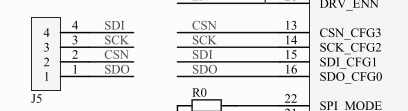

Aha, MKS considers this to be a compatible series with different driver chips. And looking at the schematic here:
I see this:
…and this:
It does have a place to solder in DIAG headers.
This makes me think that it’s meant to be able to use in SPI mode. And it looks like you can talk to this board with serial if you want to solder a few more pins in place.
I think there’s no R0 soldered here, so maybe this is actually a surface-mount jumper to select SPI mode?
Looks promising!
Yes, bridge R0, it’s a solder jumper.
Also mentioned elsewhere, you need to turn off all the DIP switches to use SPI mode.
