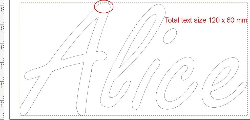

Attached is a picture and a PDF to show the problem. Maybe someone else can help.
f***, not possible to upload PDF as a new user…
The section in the red circle requires 15 lines of gcode with the online converter und over 200 lines! when with LaserWeb converted.

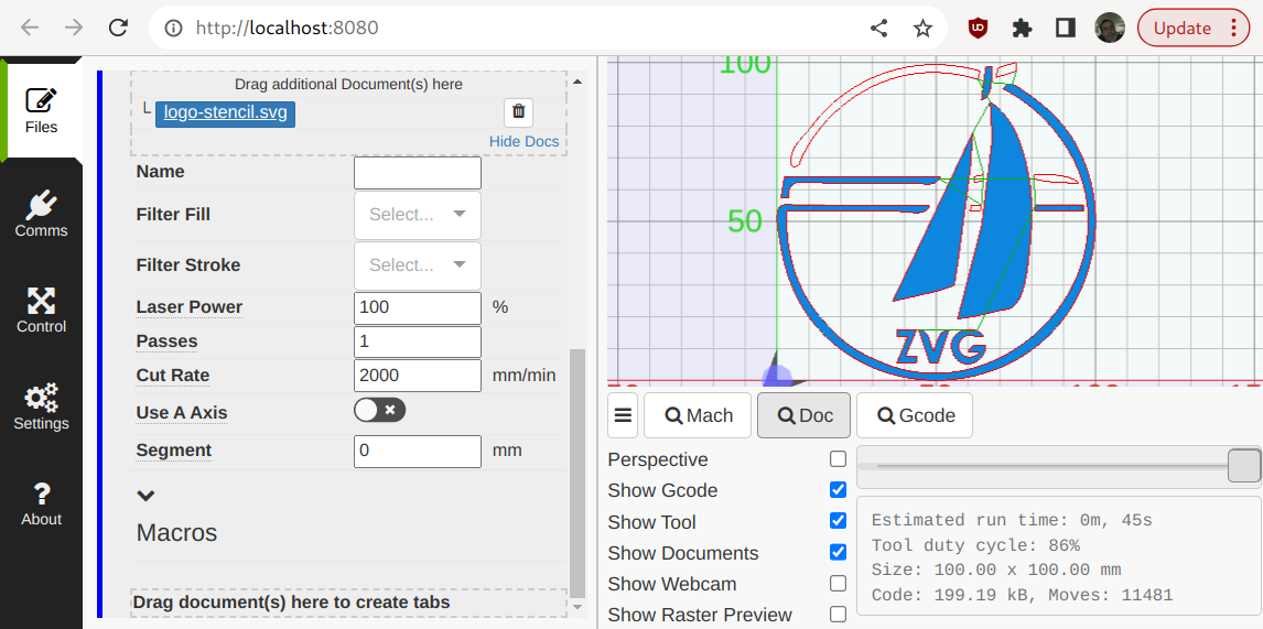

There is an option in the job definitions that should help: Segment, you will find it in the job options for all cutting operations.
It defines a minimum ‘segment’ size, it’s chief purpose is to address this issue and stop the generated code from containing small lines (segments) under the size limit.
With 16 bit versions of Grbl it’s not hard for LW to produce code that is too dense for the controller+buffer to process on time, and the machine stutters. This can be very annoying, and wreck cuts (depending on other factors too).
Here is a little example; Look at the segment value (which is the only thing changing):
First is with it set to Zero, so 1:1 ratio of paths in the input vs paths in the gcode.
Note the generated code size is 199.19 kB with 11.5K moves…
Now the same with my default segment size; 0.15mm:
Generated code is now 77 kB, with just 4.4K moves. Actual output quality is unaffected (on my large format machine), 0.15mm is barely wider than my beam.
