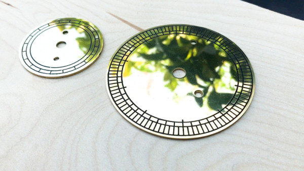

You could also try applying a laser safe vinyl mask to some brass, etch out a design and then use ferric chloride to etch the exposed brass. You could then apply some black paint to the etched areas. This might give you a more vintage feel.
Something like this.

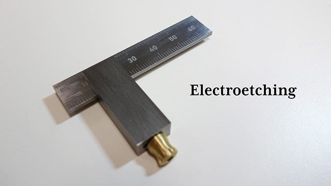

Electroetching is another method
