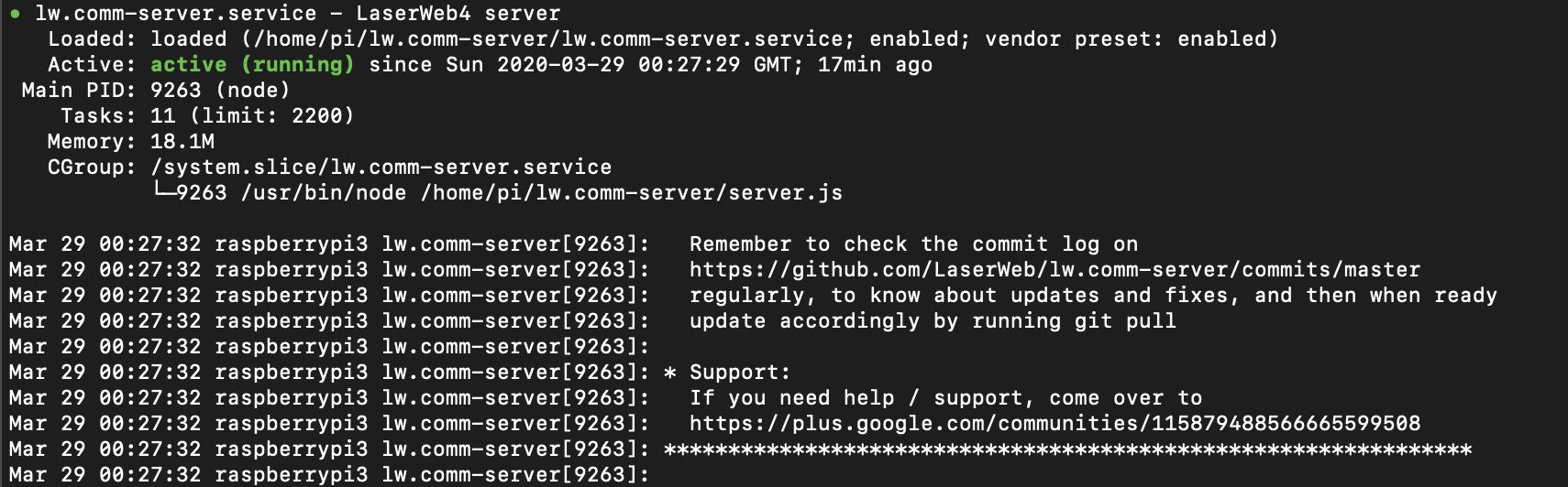

I probably have the same problem with lw.comm-server on my Raspi 3 with Raspian Buster, with Node v10.19.0, npm 6.13.4.
When accessing the Raspi from my Chrome (80.0.3987.149 on Mac), the Settings -> Macros and Settings --> Tools do not open - although they do open on https://laserweb.github.io/LaserWeb4
