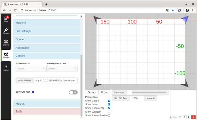

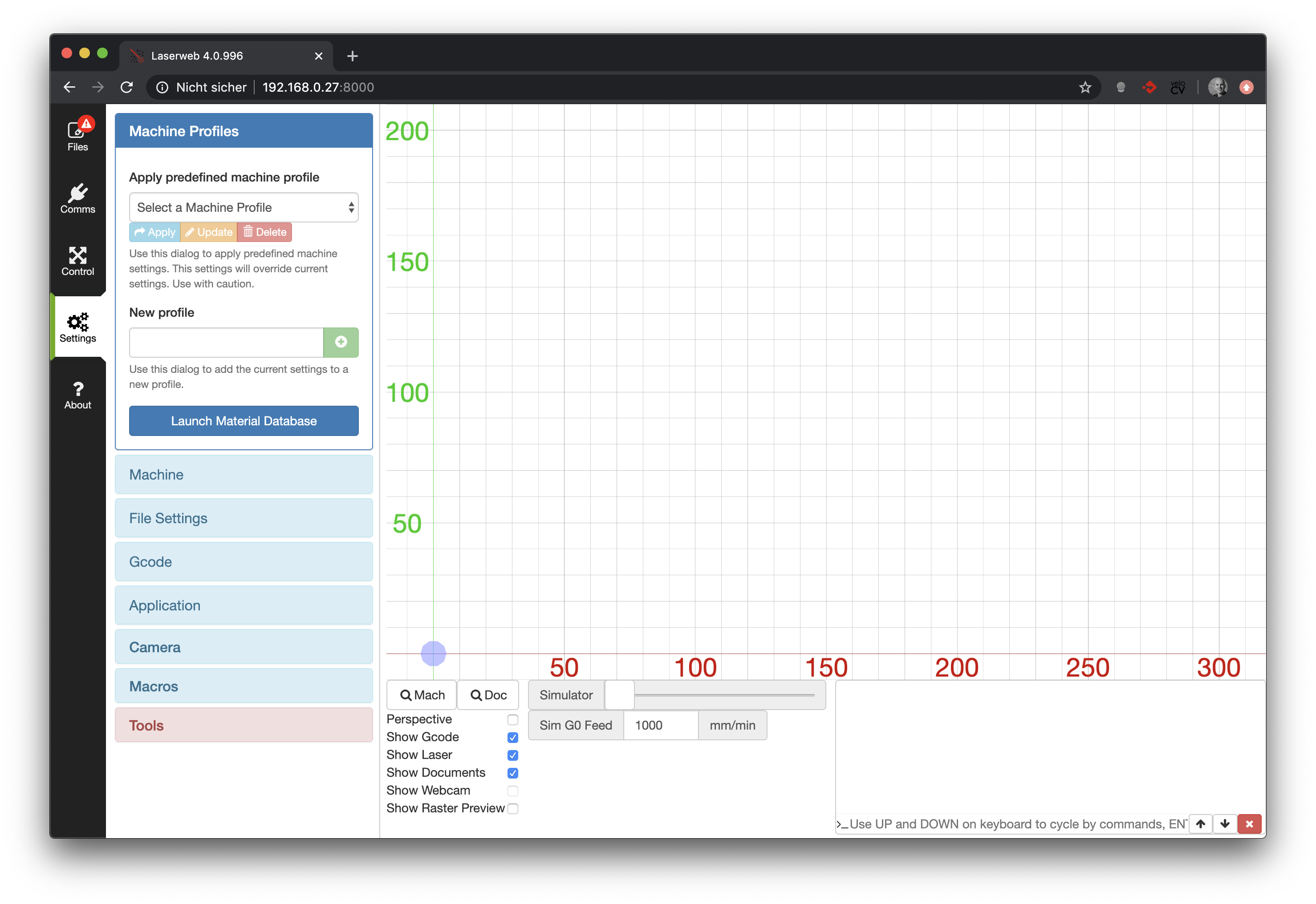

That’s how the page looks in my browser:
I’ve noticed, that I also get some errors on the browser console:
Maybe they’re related to the problem?

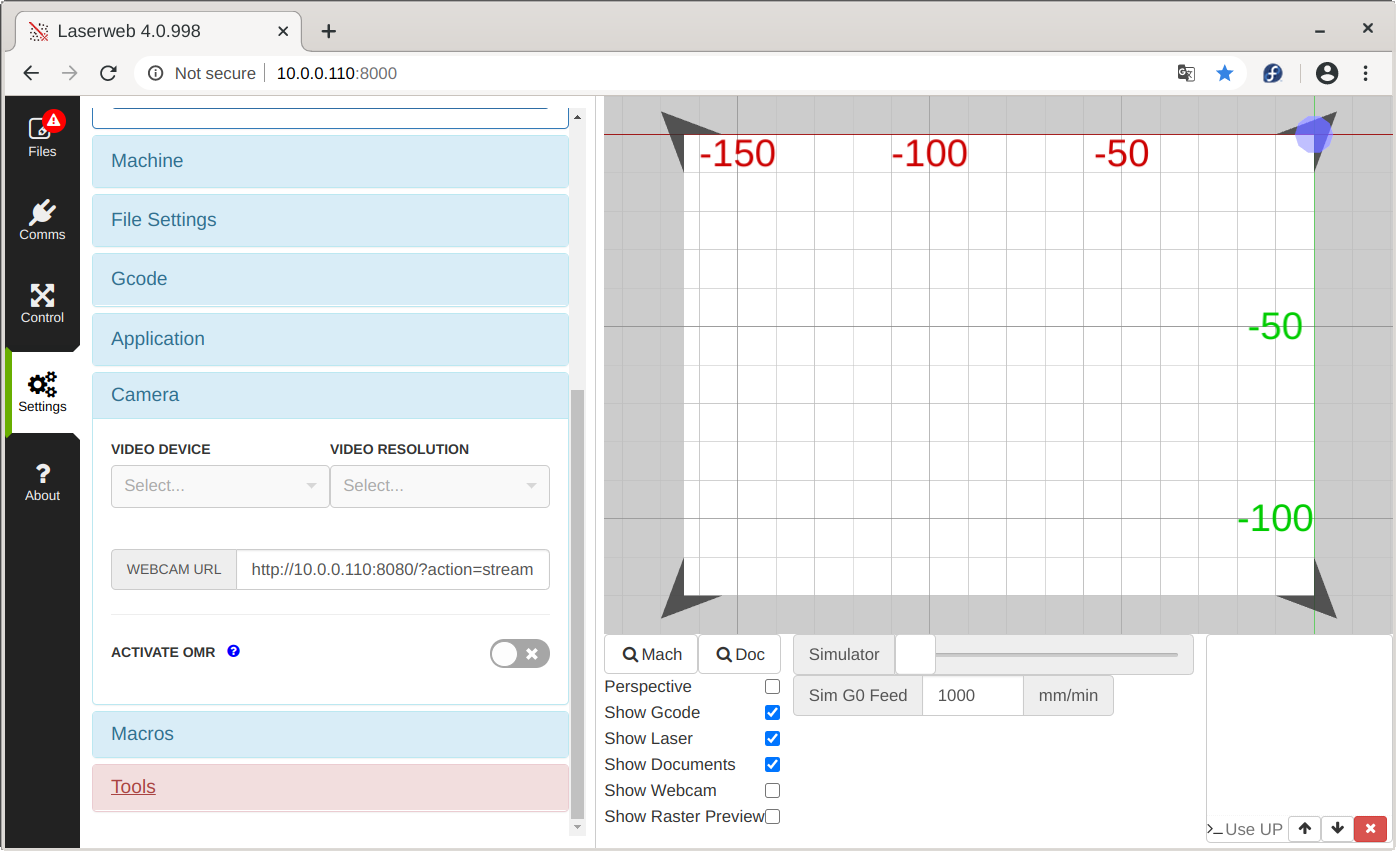

Sorry to bump an older discussion, but I’ve been looking into this too. It is happening to me when I use any Chrome v85; but a old chromium v73 install (chromium is the community port of Chrome) install still functions properly and the tools+macros can be selected.
I’d also noted that the ‘Camera’ selection entry (right before ‘Macros’) was also misbehaving; adding a known good url failed, the devices list was unpopulated.
Comparing the console of the two confirmed to me that the issue is actually happening in the Camera menu section, and the tools and macros are affected simply because they are processed after that. In the console log I see:
Uncaught TypeError: Cannot read property 'enumerateDevices' of undefined

I assume that this crashes out whatever script was supposed to populate the Tools and Macros panels before it gets to them.
And when I search on that it appears that trying to enumerate the camera devices when not on a secure or localhost connection is no longer possible. I find issues such as this:
To test this I set up a quick-n-dirty https proxy and accessed my install via that.
The Macros and Tools were back! Unfortunately I couldn’t get the server connection to pass through the proxy so I’m not sure how to work around in the long term.

This is a quick workaround you can apply via a browser flag. It restores the missing menu entries; but wont be available forever and results in a ‘you have messed with my security settings’ nagbar.
Quick summary; Chrome is closing potential security holes, and LaserWeb is falling afoul of that when used in a client-server config. eg, you connect from a laptop to a remote Pi/Host plugged into the controllers USB.

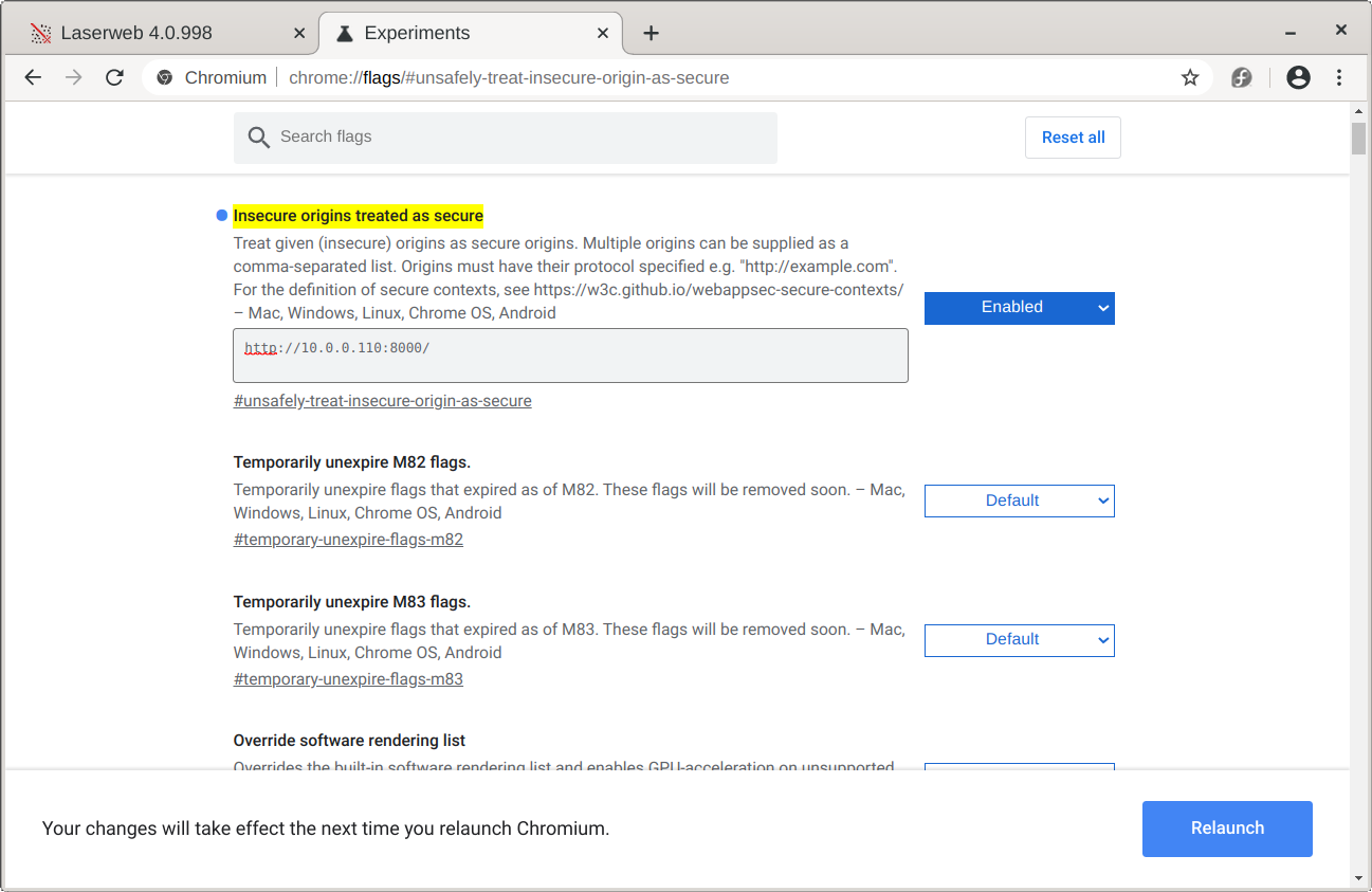

To Workaround: Go to the following url:
chrome://flags/#unsafely-treat-insecure-origin-as-secure
And enable it; then enter in the box below it the full URL, including the http:// part and port number, that you use to connect to the Pi/Host.
Read and accept the warnings; And restart the browser via the big blue button.
What we are doing is allowing the LaserWeb site itself to be treated as ‘secure’, eg served via https, when in fact it is not. because we are restricting to this single internal site the actual actual risk this presents to us is trivial. If you cannot trust LaserWeb you should probably be uninstalling it right now.
When chrome starts there will always be a nagbar on the initial tab reminding you that you have this flag set, you can click it away but not disable it.

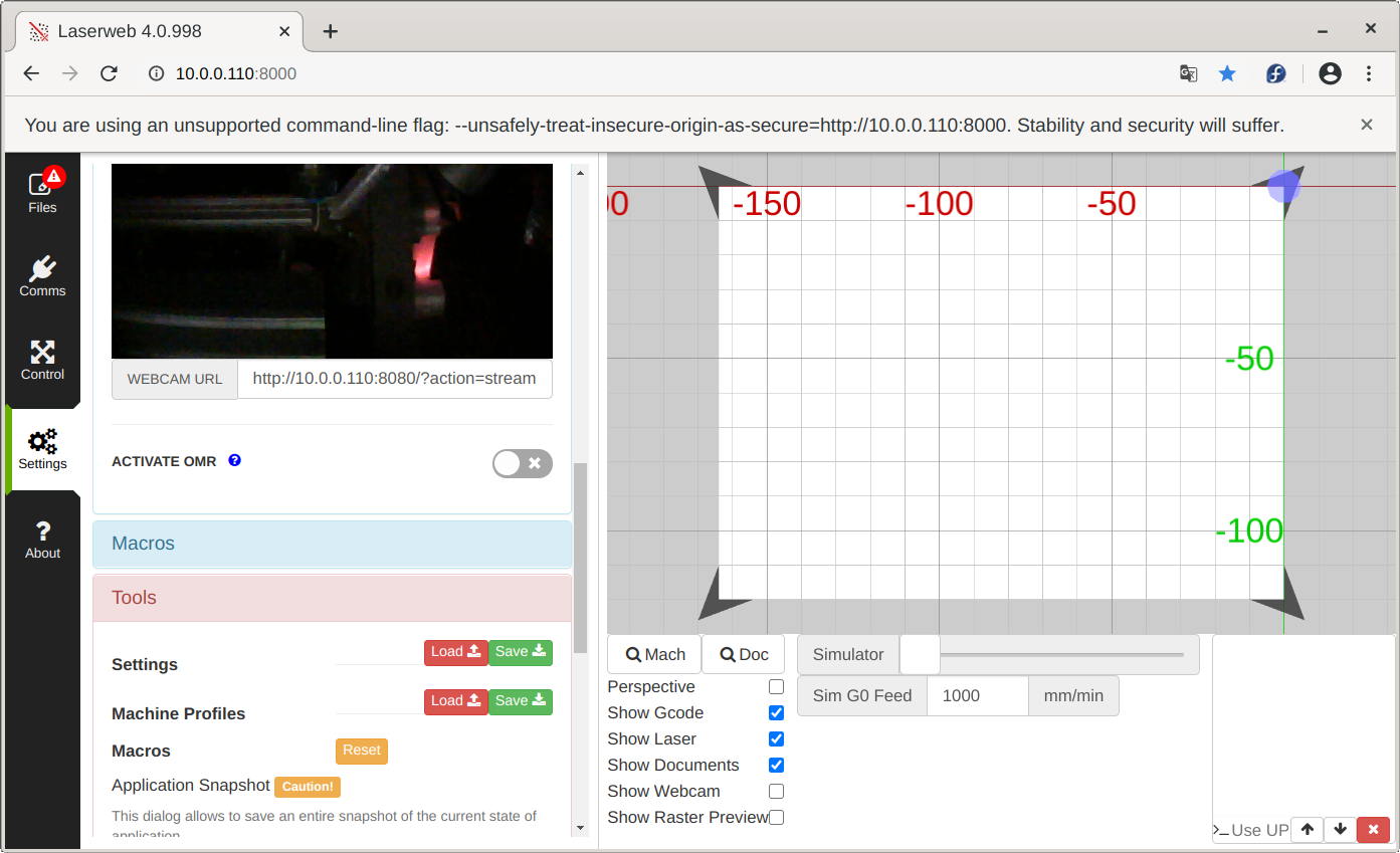

The Webcam preview, Macro and Tool menus should now be restored. If not; check you have the correct full URL and no typos in it. My server is accessed via http://10.0.0.110:8000/ So I saw:

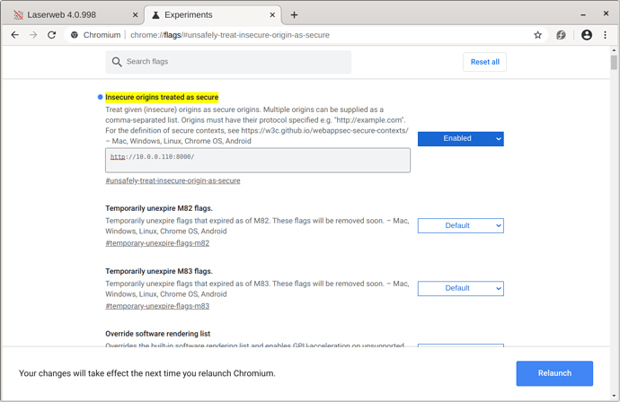

And set the flag like this:

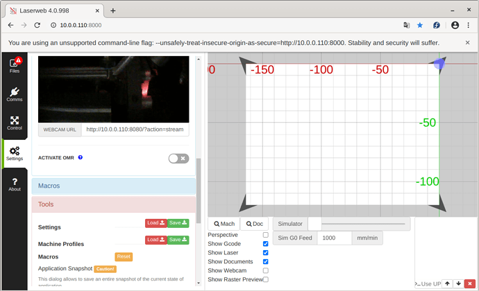

Resulting in Joy:
