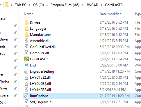

I seem to remember that there is a corellaser file that needs to be edited to point to the location of your coreldraw install. It’s talked about somewhere in an old post of the K40 group years ago. I will try and look for it later
That’s amazing that I even got ahold of you, thank you for searching.
If open the “runoptions” file in the corellaser program files what do you see?
@Yuusuf_Sallahuddin_Y knew more about this stuff, but we haven’t seen him in years.
I think I know what you are talking about, when you open the runoption you see the version number. Mine shows ver. 0 but I when I change it to ver. 11 Notepad says I’m not authorized to make the change. Frustrating Chinese to English translations. I’ll keep plugging away. Thanks
Here’s what mine looks like. Zero is correct.
It maybe another file. I found Yuusuf’s old post but he links to screenshots and the link is dead now.
